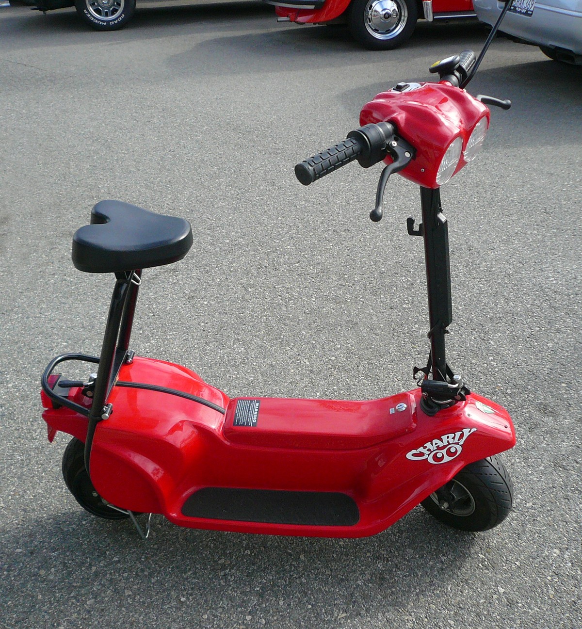

is followed by a collection of sidecars to haul your electric scooter
an MZ Charly electric scooter
dave :smt023 :smt023
