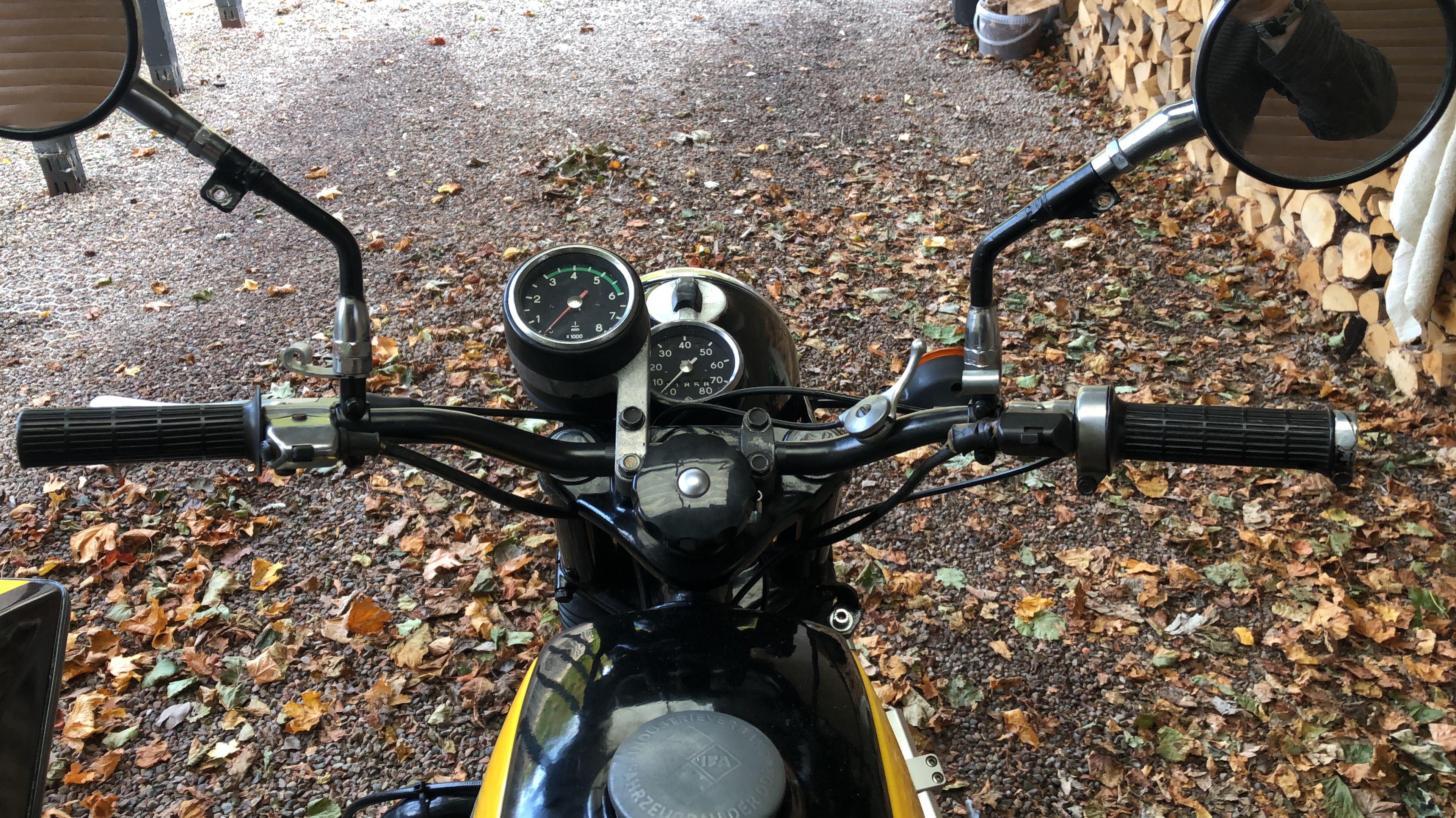

Postby ScotBob » Sun Oct 23, 2022 8:34 am

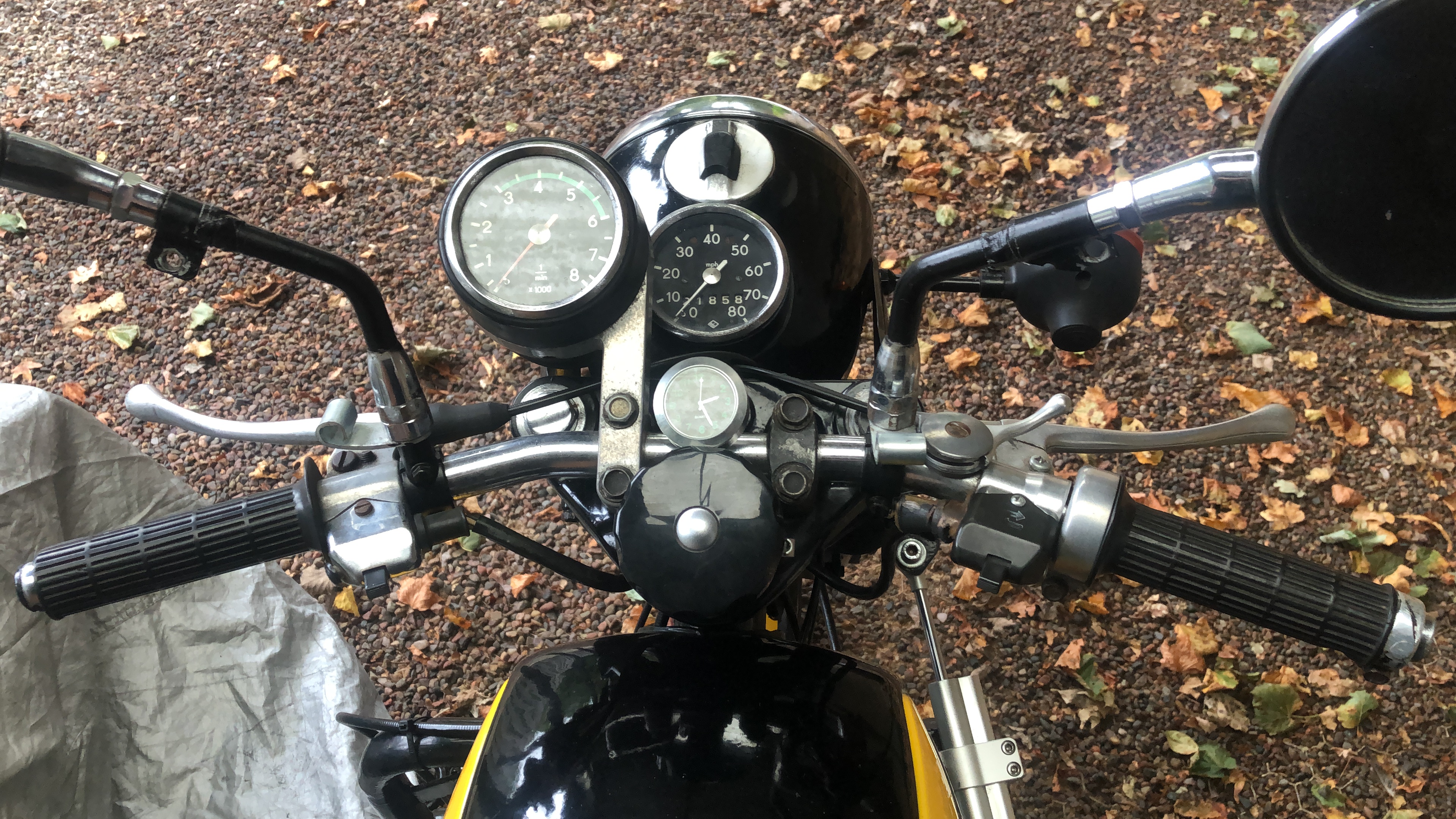

Hear’s a few pics to answer some questions:
Original narrow, flat bars that lacked leverage and made it difficult to steer, then the new wider bars with 2” rise which have made it much easier to control.

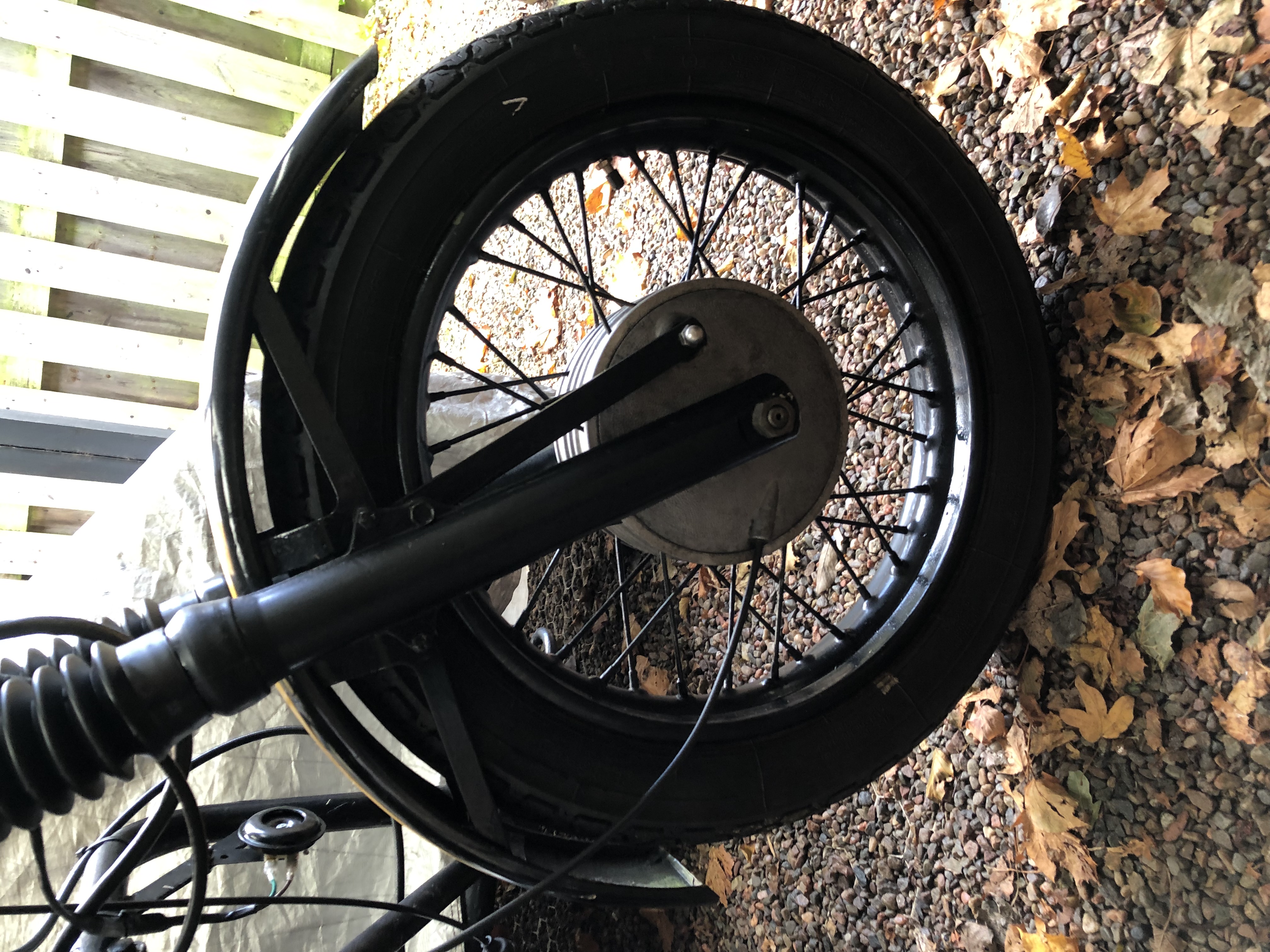

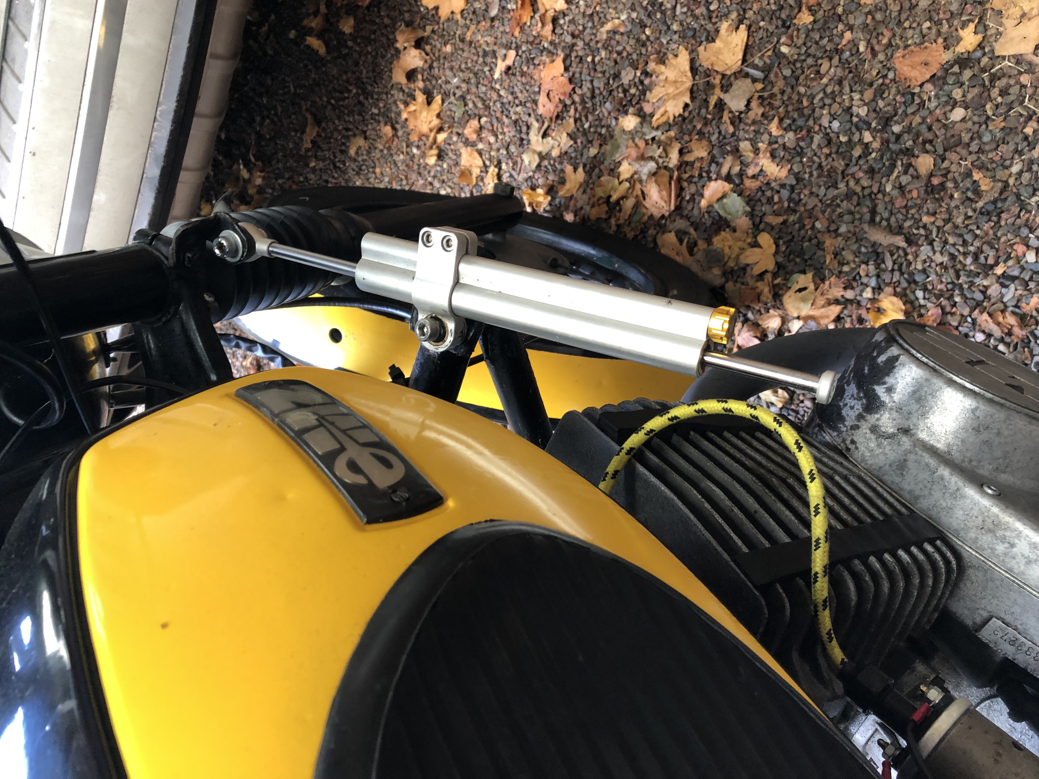

Postby ScotBob » Sun Oct 23, 2022 8:38 am
More pics: steering damper and front wheel which I’m lead to believe by the previous owner is a heavier item laced to the hub?

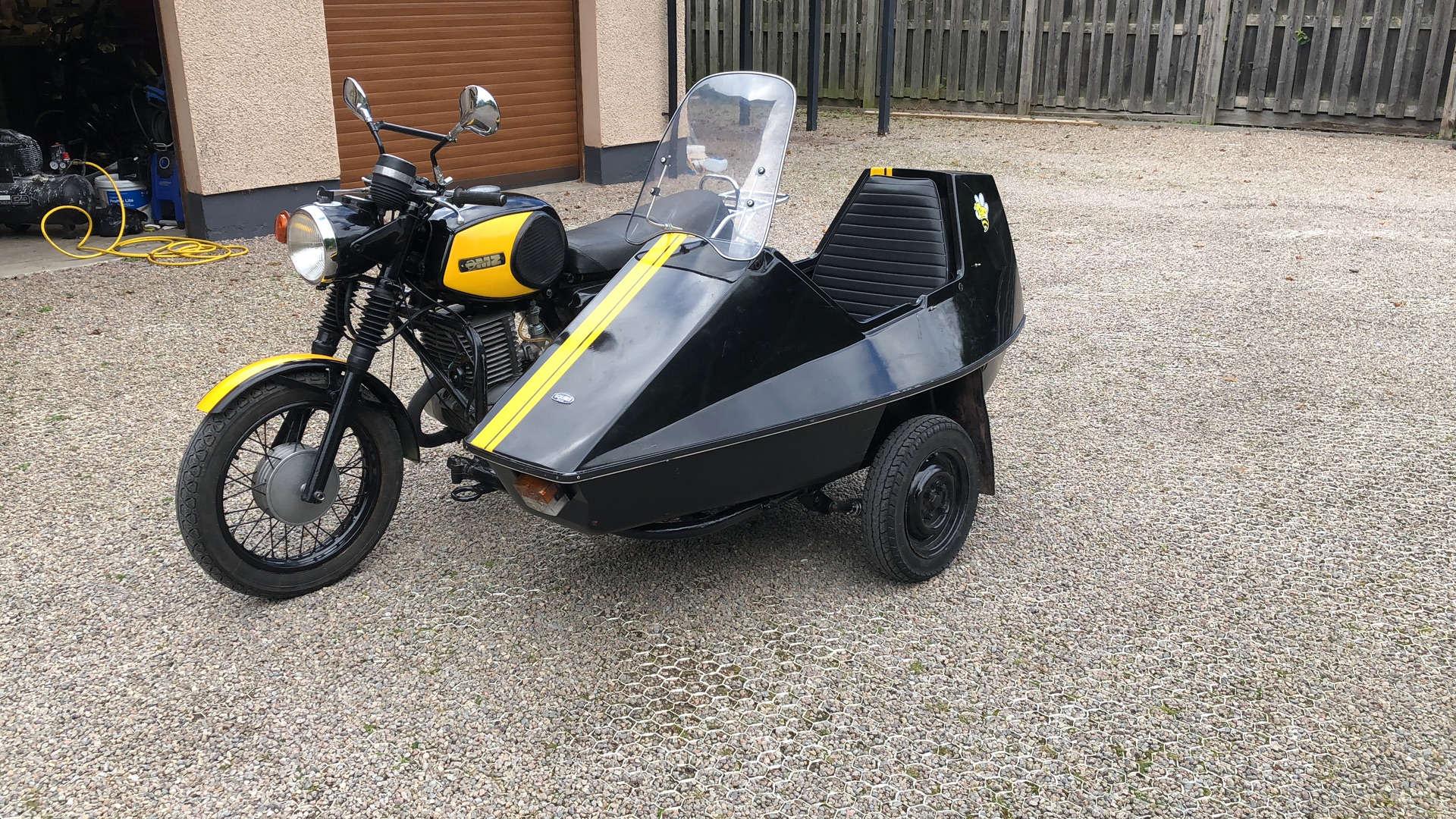

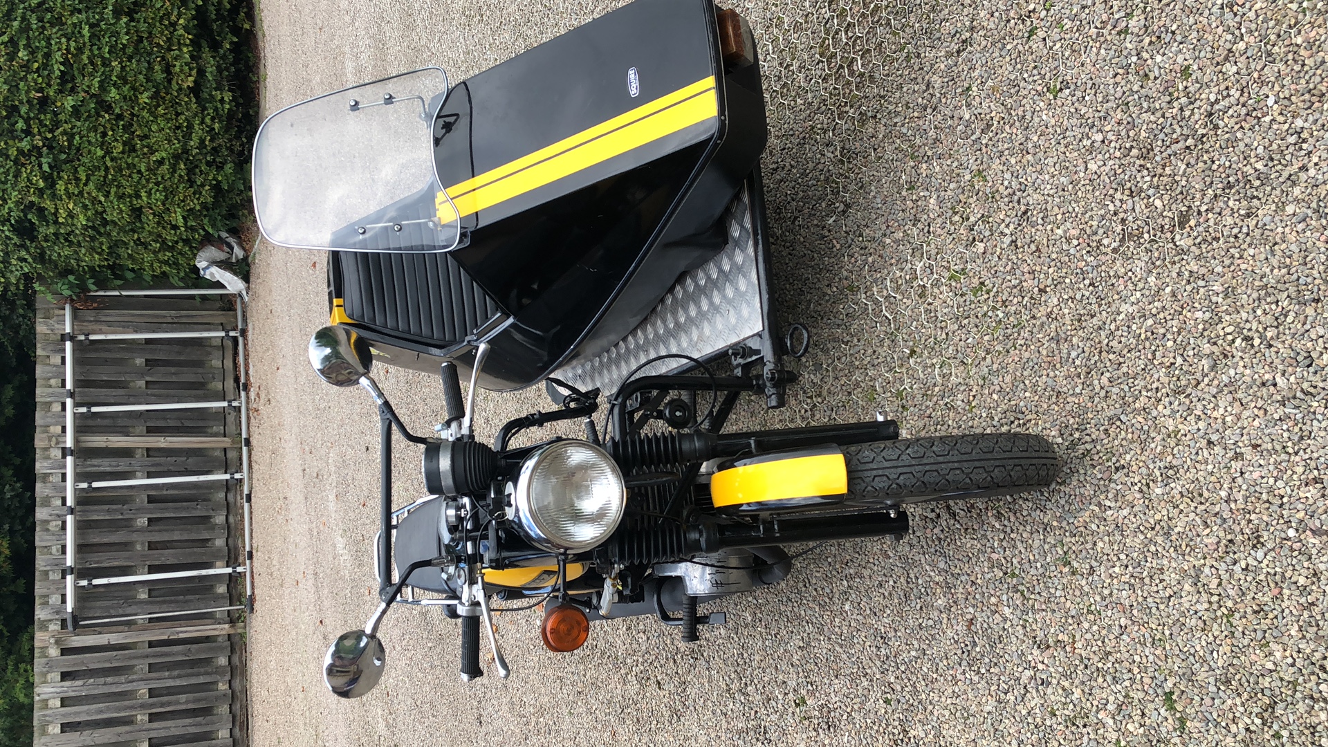

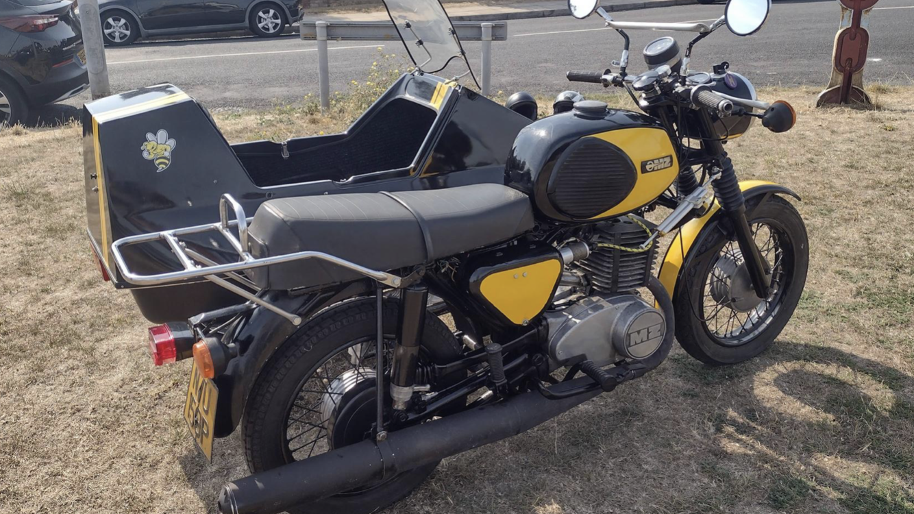

Postby ScotBob » Sun Oct 23, 2022 8:43 am
The bike in question:

Postby ScotBob » Mon Oct 24, 2022 5:44 am
Thanks for the comments:
Ref the frame and width of the sidecar; it looks to me like its been home made, seems like it was a simple flat platform that could be adapted to any use. It is certainly not a complete Squire built unit, but most likely a Squire sidecar body bolted on to a universal platform, hence the width of it.
