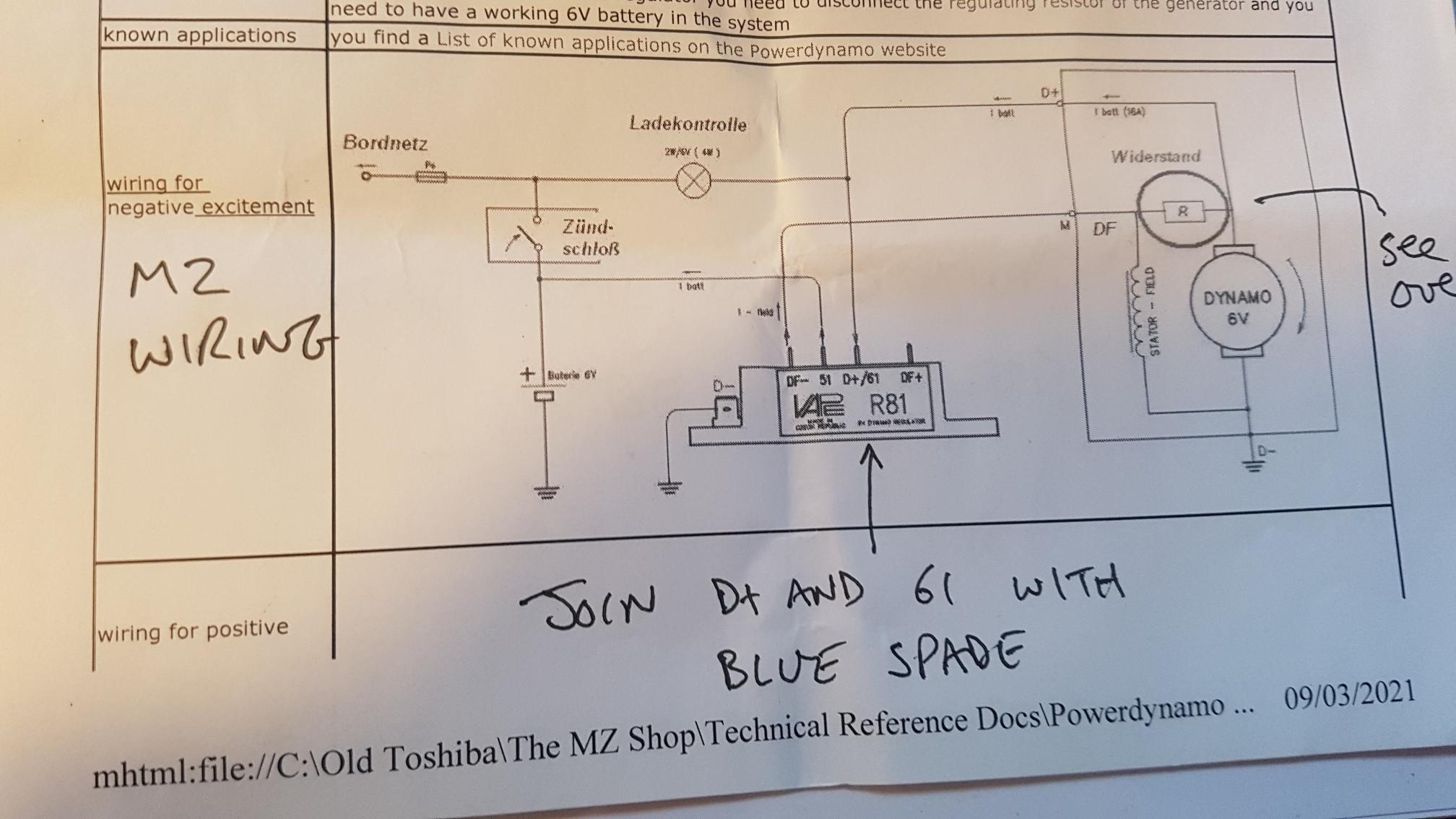

I agree with Andy, I have a set of points, have purchased a second-hand dynamo on eBay with the capacitor and points backplate on it, I have purchased a new coil on its way, the bit that puzzled me and blew a fuse was a wire from the elec ign black box went to the multi-connector block and then on to the coil, but sat with it was another black, I traced this up to the ignition key switch in the headlamp, when I re connected that the fuse blew, the whole lot is going in the flippin' bin.
Also I got this with the new solid-state regulator, It tells me to put 61 and D+ from dynamo together ??
rotated pic DAVE
