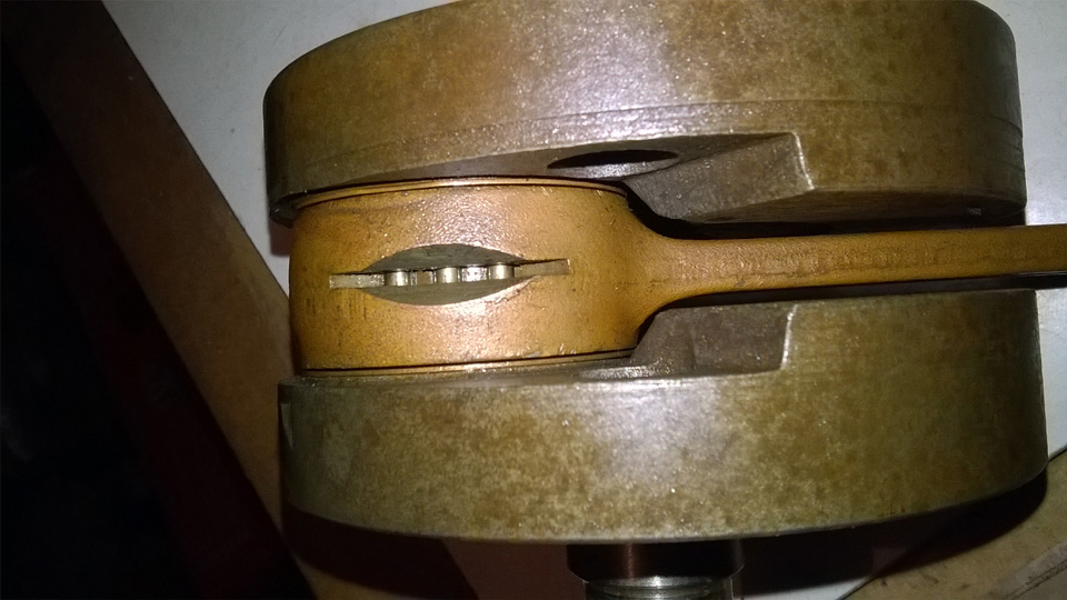

It's possible that a shim on the crank (both indeed) have come off and damaged the crank side wall? But I don't think this is the case (but who can say). I don't think it had any shims from the factory. And yes there is a noted proceedure in the book about rectifying conrod straightness, but there aren't any specific witness marks on the little end gudgen pin. Looks good.
The rebuilt conrod I believe will be shimmed.
EDIT:
Just for those interested. Here's a picture of the crank conrod and you can see how much side to side it has (out of the factory??) Anyway.. Just today it will be picked up for postage to be 'reconditioned'.

Consider using a knife for burs like that (or maybe a file); that only takes out the high parts but leaves the surroundings intact. Sandpaper also sands around it, as you probably used your thumb.
I thought the ETZ bearings were the bigger ones? Lubrication with premix is always very thin, I would guess gearbox oil might give a better lubrication (particularly on the clutch side). Hence they figured they might get away with smaller bearings. But more likely these engines sometimes gave main bearing issues, so that in later models they just gave it bigger & stronger bearings.
Shims are quite common on either side of the big end bearing. See here the (original) big end of my ETZ251.
See the shims. I have not measured the sideways clearance, but it's not a lot. The big end is still fine, the crankshaft was replaced for small end issues (in the pre-webshop era, and I could not find a conrod where I lived).
I wouldn't know how shims like that would vanish. But eyeballing it, your burr could possibly be at the position of one of those shims, and btw, those witness marks would be inside the piston (where the small end of the conrod would rub against it). Yet a little search suggests that indeed the ES may not have had shims:

ES/2 crankshaft don´t have shims.
On this crankshaft, the conrod is stabilized by the psiton, so the clearance on the bottom of the conrod is quite much.
The ETZ crankshaft has shims, because the conrod is stabilized and guided by the crankshaft pin.And so the clearance on the bottom is very low.
We call it top guided on the ES/2 and bottom guided on the ETZ models.
