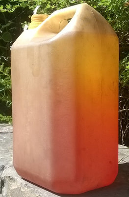

I don't have such an oil cup on my MZ either, but I have something very similar on a 2T electric generator, in PE.
I always carry a bit of oil with me (in the battery area), just in case, but if I plan to mix at the pump I take a set quantity of oil with me, and fill up with the desired amount of fuel. And then, after I ride away, a bit of acrobatics to mix it. Just to show oil + fuel do need shaking to mix well, this is what happens if you just add the (red) oil to the fuel, without shaking:
Shake it.jpg (27.9 KiB) Viewed 784 times

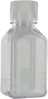

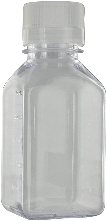

In the end it sounds like if I’m 50:1 or slightly richer I should be good to go. To that end I found an 8 oz (250ml) nalgene brand container with graduations to accurately mix/carry oil on the road.

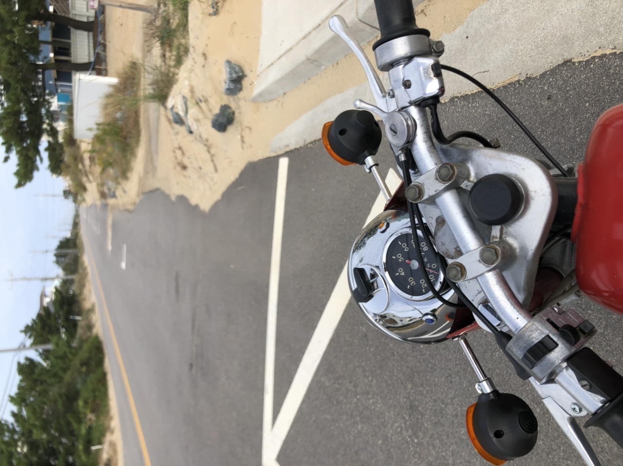

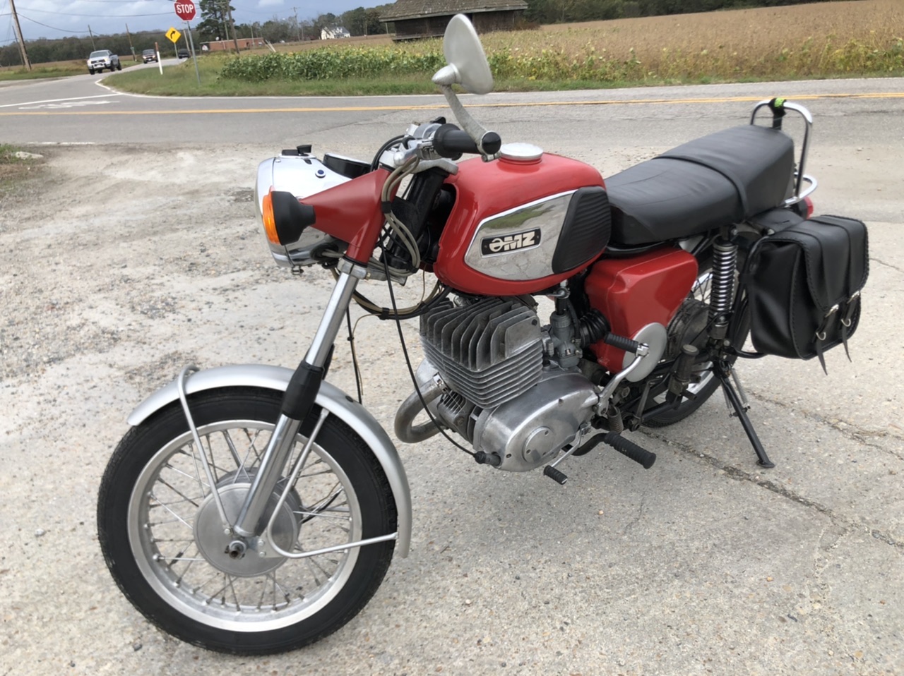

Postby R1100purist » Sat Nov 14, 2020 7:07 pm
Alright, got her cleaned up and did an initial shakedown ride. It was out to the country side and she did fine. Although a little difficult to keep her idling, and after a fast run idle was reluctant to come down.
Additionally there was a little leak from the drain plug that I’m trying to sort out.
R1100purist
Posts: 19
Joined: Thu Sep 10, 2020 3:28 pm
Re: New member intro and TS250 fuel tank size question.
Postby Puffs » Sun Nov 15, 2020 4:53 am
Nice bike!
Check if everything seals well & that it doesn't aspire air bypassing the carb ('false air'), that might cause your idling issues.
Postby R1100purist » Mon Nov 16, 2020 6:50 pm
I checked all the gaskets on the carb and they look good. I feel it has more to do with the ignition advance? Any thoughts?
