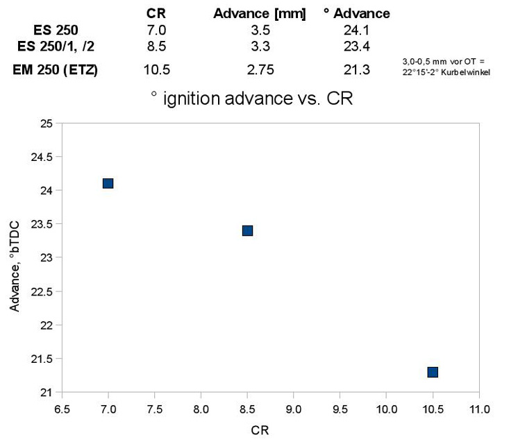

A little while back (on a geological time scale), the relationship between ignition advance timing & Compression Ratio was discussed:
When the fuel/air mixture is more compressed, its temperature is higher and the flame front moves quicker through it. The mixture ignites at the plug, when that sparks, and that flame moves through the mixture in the combustion chamber, heating it up and thereby greatly increasing it's pressure. You would want the maximum pressure to be reached at or shortly after the piston is at TDC, in order to maximise the engine's efficiency. At a low CR, it takes longer for the entire mixture to heat up, hence at a low CR you need more pre-ignition, or more ignition advance. Older engines had a lower CR because the fuels used at the time required that; at higher CR they would pre-ignite/knock/detonate & cause engine damage. Also, remember that the speed of the flame front in the combustion chamber is independent of RPM, but at high RPM the piston moves quicker (or maybe faster), for that reason many classic motorbikes had a manual advance system (while automatic systems are in place in some modern engines).
Yours has a rather low CR, would a little more advance help? Or reduce squish --> increase CR (at the risk of higher loads)?

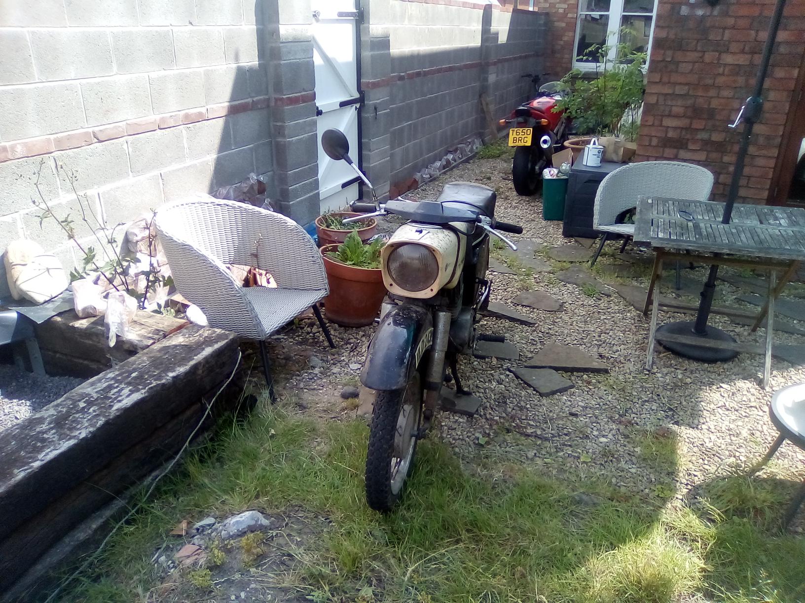

I have a mirror!
First made out of aluminium bar in my brother's 1948 lathe to see if the concept would work, and it seemed to, and didn't look too bad. So then made it out of steel and then oil hardened. I don't think it looks too bad!
First picture is finished product. Second picture is of the original aluminium, but I put the picture up because it shows what the whole bike looks like.
In place of the pivot bolt for the brake lever, in lieu of finding anywhere else to easily and without modification of original parts, to fit a mirror. The mirror itself is an original ETZ one. I originally meant to have the bar itself about half the height that it now actually is, but I didn't have a full depth m10 tap, only a tapered one so I had to make the length an inch long. I intended to later on buy a full depth tap and cut the threads fully, and then chop the rod by half an inch, but I'm seeing how the positioning is for now. It looks a bit funny, but not too awkward. But it is certainly nice to see the smoke behind me! And dangers of course...
The pivot where the brake lever itself rides on is of course not tapped, but the bottom half of the clamp is threaded, and on the end of that we have a lock nut as well. So this adapter doesn't make any adaptation to items to make them non-standard. I like it.

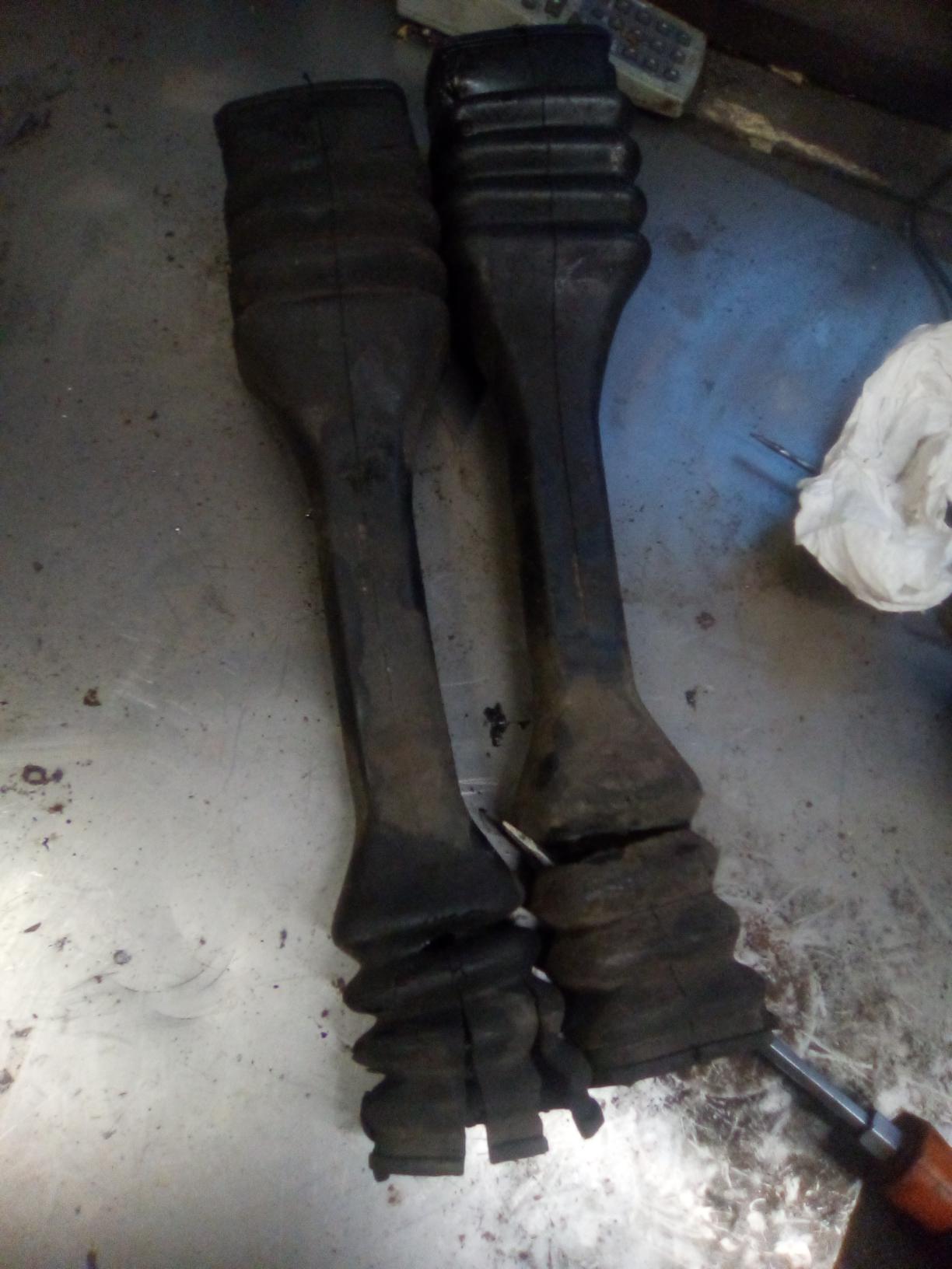

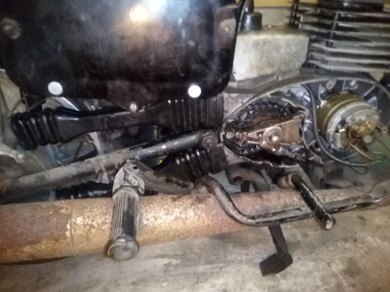

Another quick update. I finally, FINALLY, 2,000 miles after the mileage in which I wanted to actually install them, put on the new chain gaiters. They don't look half bad. The old ones are broken and frayed at the rear (where they surround the rear sprocket cover), but were usable enough until now - maybe I should have taken a picture - but alas you couldn't really say that they looked very good or even may not actually be even doing their job as they once had done.
One of the worst things about MZ's is messing around with the individual tubes for the chain. They're great- but also annoying, fiddly and very messy! Easiest way is to fish a rod through the engine entrance of the gaiter, and tie something (in my case fishing line) around the end of the rod and the end link of the chain and thread it all through. I actually used the brake actuating rod from my ETZ250, what with it's handy hook on the end. I hope these gaiters last, as there is a lot of disapointment with the quality of aftermarket chain gaiters and that they break through (or crack and then break through quickly), in just a few hundred/few thousand miles. I have been assured by the person I bought these from last August (?) that these are the best quality aftermarket gaiters so they should be good! And I hope so too!
I put in a good half a (small) tube of grease in each gaiter before threading each end of the chain through so hopefully that staves off the reason why the cheaper ones break early. I think they look smart. Also greased the speedo drive (via the nipple) whilst I was messing with the grease tube and gun. Don't think I've done that for 3,000 miles.

Postby Puffs » Wed Sep 28, 2022 3:35 am
Yes they do look smart. Lets hope they last.
So that triangle gizmo over the sprocket is your speedo drive. And I hear you did at least 3k miles with the bike already!

Old ones for comparison.

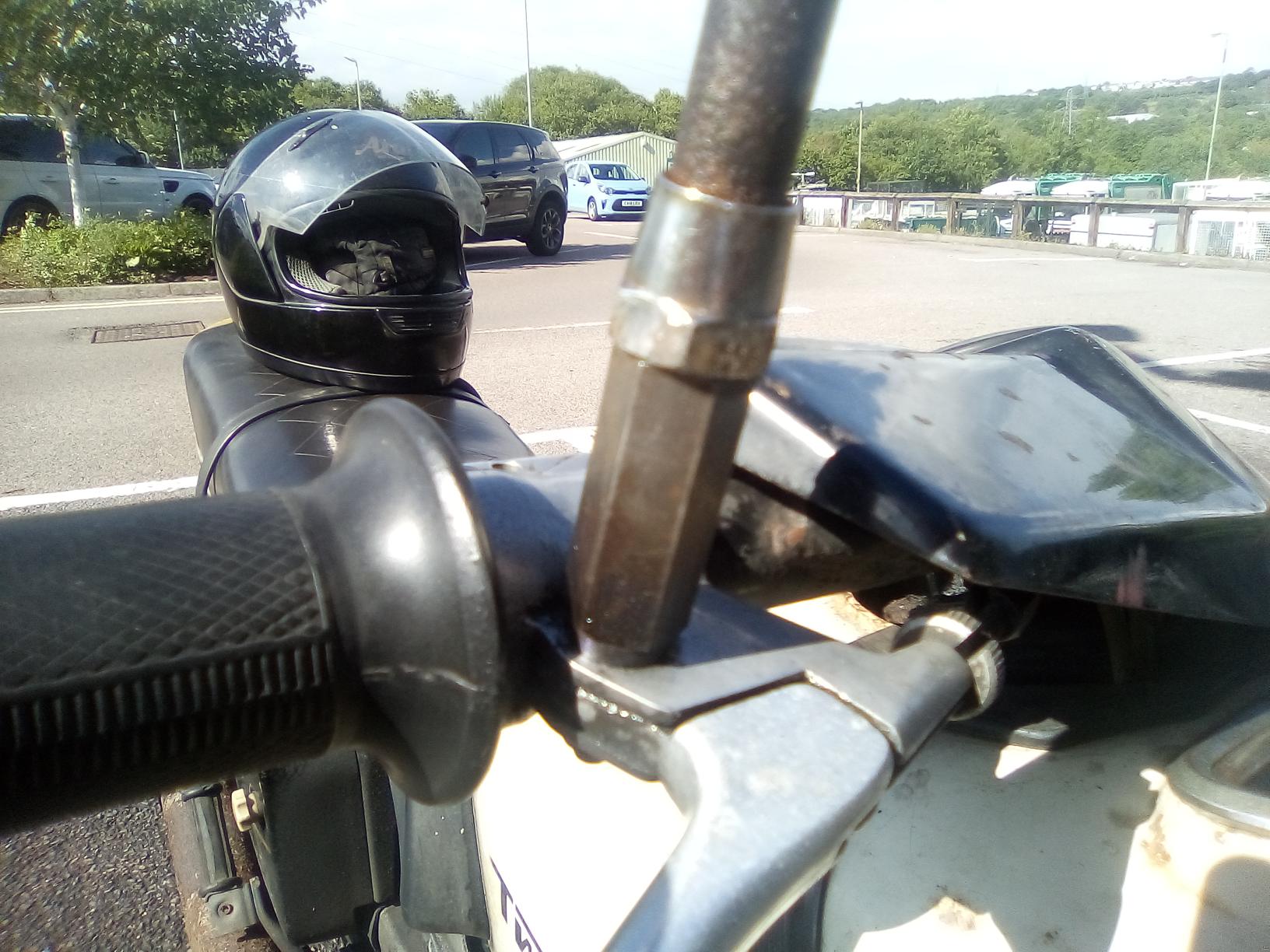

Well, after acquiring a rack, I spent a good 10 hours modifying it to fit.
In the end, I don't actually like it. The hinge on the seat on one side got in the way, as did the locking system for the seat on the other side (which I didn't actually manage to align properly). It slopes backwards too but it should be good enough for now I think but I'll re-design it in the future. It has pretty poor welding, and indeed I haven't even bothered to paint the thing because I know I'm not happy with it and will likely chop it up again.
I should have gone with my original idea of copying the way the original rack mounts to the bike, using long tubes that slot straight into the frame for about a foot.
As it is, I decided to go down the route of making up the rack with spare scrap, including using old handlebars to reconnect the rear sections where I had to cut through them to widen the rack as a whole.
As you can see on the third photo, the bit of tube acts as what I thought might be a handy handle, but more so to re-inforce the support section. Not sure how that will hold up in the long term. But as a handle it's pretty useless- easier instead is to just use the lower rear of the original rack section itself.
I've just put some cardboard under the box in order to reduce the vibration noise as it isn't held down the most securely as I didn't bother flattening the extension bars.
