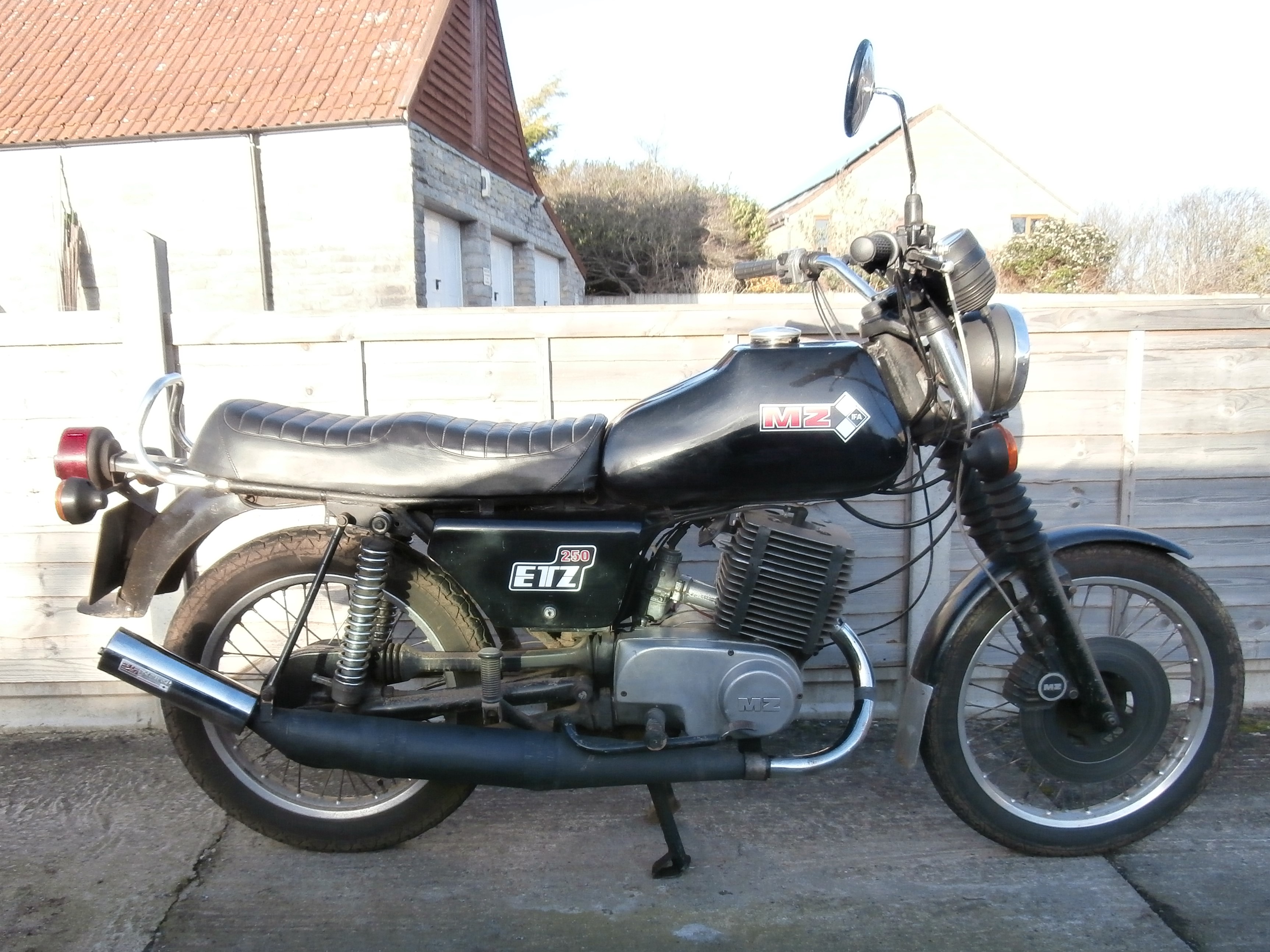

Re expansion pipes.
The short one (which seems to be the only one you can get) will fit to the standard bracket - you may need to bend it a little but it will fit, at least it did on mine.
Being a short pipe you will find that it robs the engine of what little low down torque that these engines have, instead of starting to pull at around 3500 RPM it will move it up about 1000RPM, it also robs some of the mid range, however you will find that the motor revs much more easily and you can exceed the red line (6500RPM?) easily - not much point as you do not get any more power.
Basically with these short pipes you have to be revving the motor pretty hard to maintain a decent pace.
My "solution" was to weld a 10" (or therabouts) long cylindrical section in the middle of the pipe, and as far as I can feel it now works at least as good as, if not better than the standard pipe - I'll post up a pic of the pipe sometime if anyone wants to see it.
Just thought you might find my experience useful.

Andy_C wrote:Re expansion pipes.
Yes a picture please

The problem fitting the bracket is that standard both connections are to the rear of the shock, while here the connection to the pipe is forward of the shock.

Postby Andy_C » Sun Jan 27, 2019 10:37 am
Dirtsurfer - you wanted a pic of the modified spanny on my ETZ.
Here it is attatched to the ETZ.
As I say it works just fine in my opinion - possibly even better than standard.
I have been told it looks awful - IMHO looks no worse than the standard "drainpipe" but each to his own.
