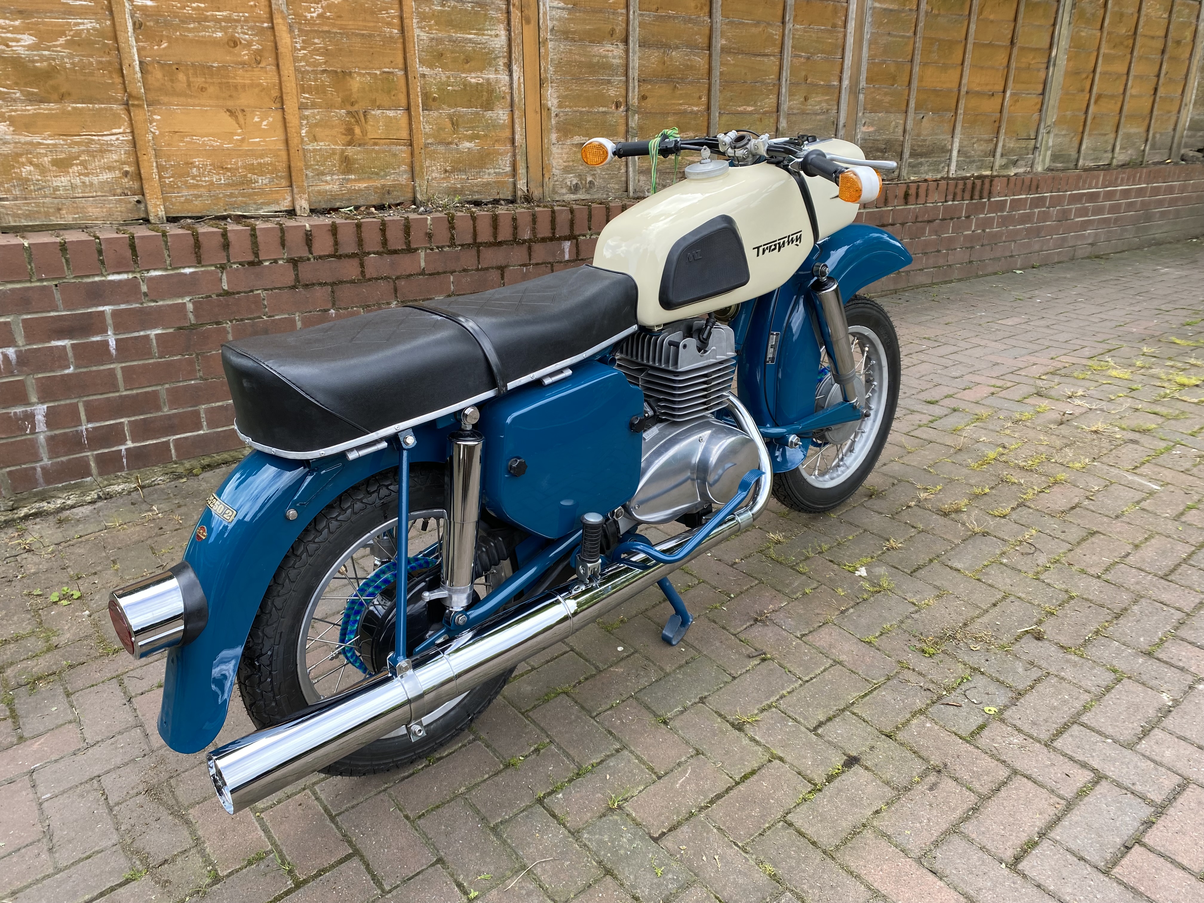

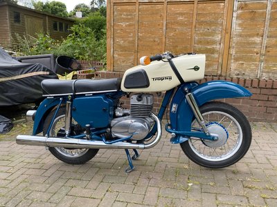

Lovely looking bike that, obviously a very thorough restoration, how do you like it?
I`m no expert but for what it`s worth I thought the engines in the ES and ETS were the same.

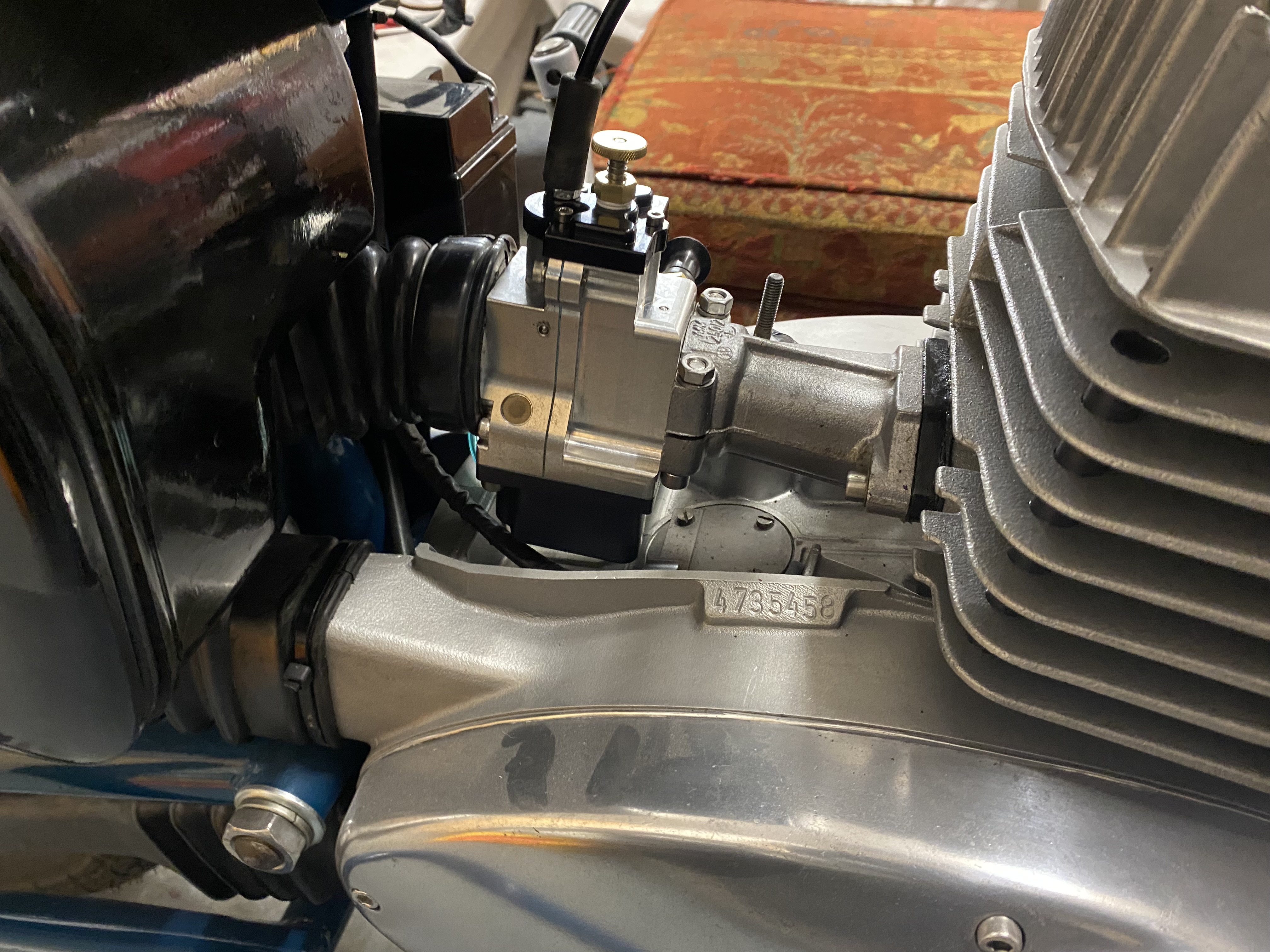

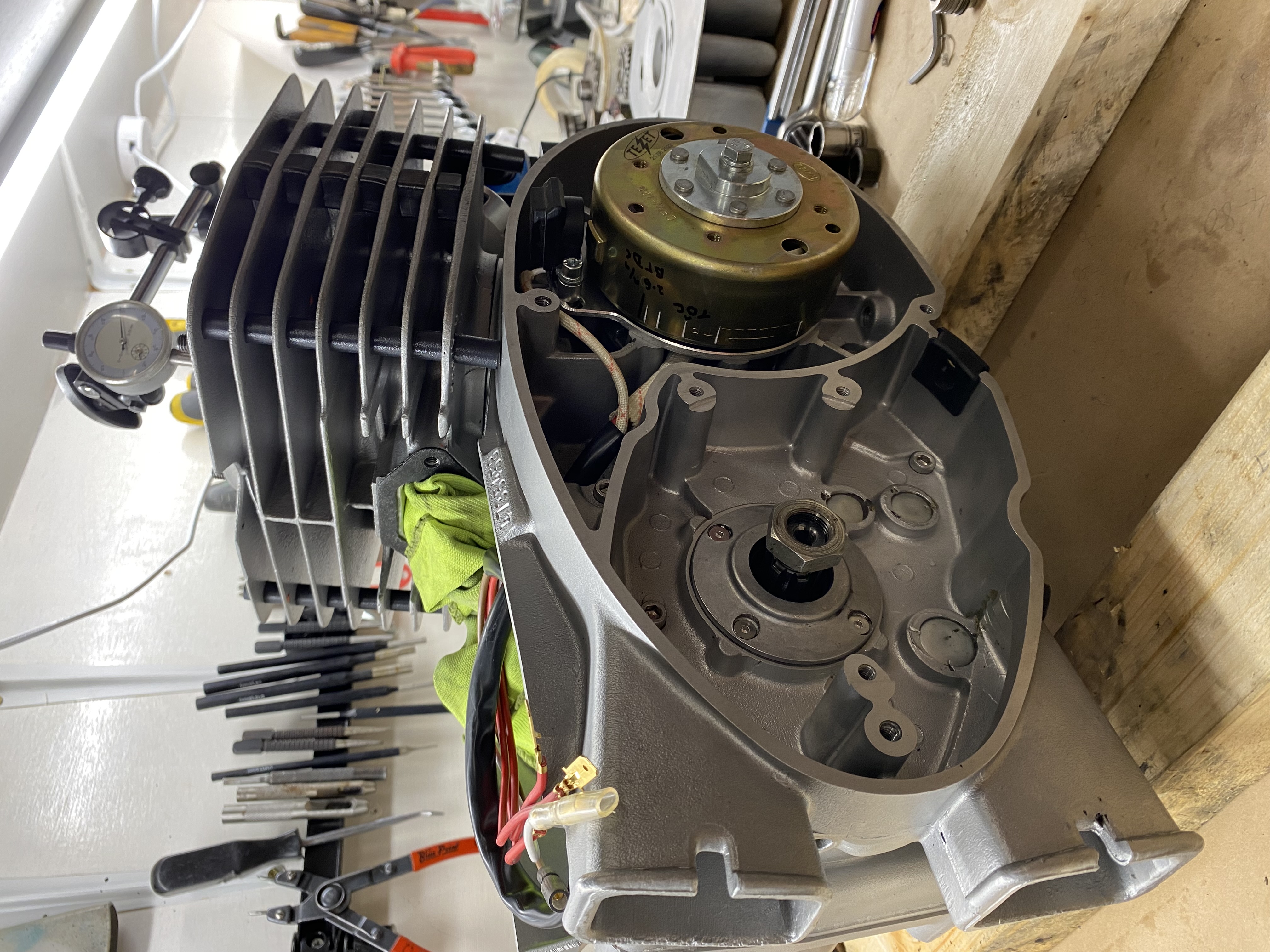

The ES, I've done a comprehensive build, altered 4th gear ratio, blueprinted the engine as closely as possible, balanced the crank to 55%, cerekoted the piston and fitted the Smart Carb (The carb without jets) unfortunately I haven't ridden it due to health issues but I hope to soon.

Nice bike! I would like to know how that smart carb operates!

The Smart Carb, they have cleverly vented the float chamber into the venturi which raises or lowers the fuel level in the float chamber to meet demand. Its more complex than that but that's the principle and it delivers fuel throw one nozzle that you or I would call a main jet. Changes in atmospheric pressure are compensated by adjusting the needle height by a knurled nut at the carb top which takes seconds, likewise you can richen or weaken the same if you fitted an expansion chamber for example.
That's the principle but it is a little more complex but not in operation just build etc.
