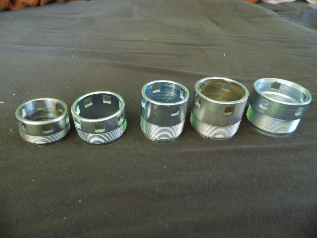

You are right, it seems that it has been shortened.
To show the different collars, here a picture.
From left to right:
TS 125/150 and ES 125/150
TS 250
ETZ 150
ETZ 250
ETZ 251

Guesi - thanks no idea there was such a range of exhaust collars.

Yes Guesi, thanks for that clarifying pic!

It arrived today - looks exactly like the one in the picture that Kruh posted up - the second one in from the left that Guesi posted, so it is the right one.
The new one was about 5mm longer than the old one and had the small unthreaded protrusion on it, which did not exists on the old one, for whatever reason.
Put it all back together this afternoon, with a little RTV as suggested, torqued it up nice and tight.

Andy - if you look at the picture that Guesi posted up you will be able to see which collar is the right one for your bike.

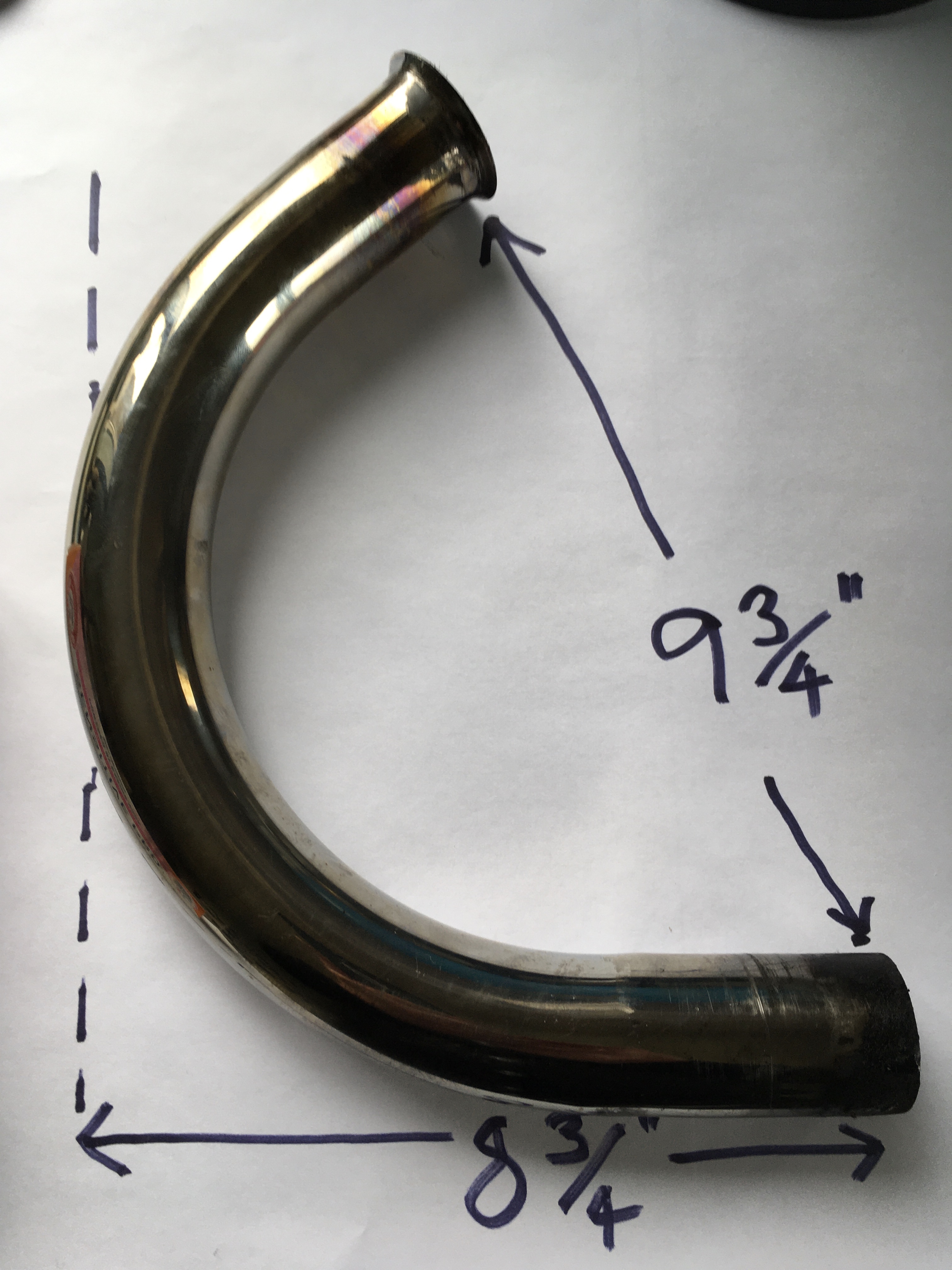

Andy C posted a photo of his exhaust pipe. Here's a dimensioned photo of mine. Unfortunately it does not fit when mounted, being about 3/4 inch too high for the clamped silencer. Any ideas? It's a pattern part, of course, but suppliers who have been kind enough to measure their stock say that they are all like this.

Postby Andy_C » Mon Apr 04, 2022 10:32 am
I would say that the header that you have has too tight a bend in it.
Looking at the picture with it fitted to your bike, it is much closer to the engine case than mine - it looks to be about half the diameter of the pipe too high.
I would say that the header is the wrong one or has been bent at some point in it's life.
Best bet would be to see if the MZ shop or E bay has one.
Cheers.
