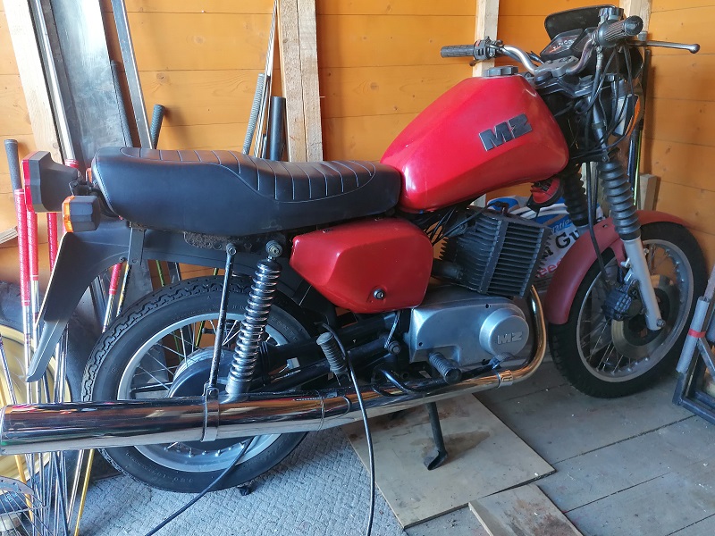

Postby alexxx » Wed Apr 14, 2021 4:10 pm
Here is the bike as I bought it.
I assumed all is original but not sure, the side stand is far too short to use.
Rear indicators different from the front type.
Should this 1991 have a steel rear mudguard?

Postby Blurredman » Thu Apr 15, 2021 4:32 am
Your rear indicators i believe have been replaced- they should be the same style as the front. The rear bracketry which is unused would otherwise hold secure the grab rail, which you don't have.

Postby alexxx » Thu Apr 15, 2021 6:27 pm
Thanks folks,
All helpful.
Maybe there was a rear grab handle but the bike come with a rack and top box so I guess any grab handle could have been removed to make way for the rack.
I have seen other 91 models with the indicators the same as the front. I have also seen late models that still had the round clocks.
I would prefer a steel mudguard so will try and source one or get a universal unit on ebay and mod that.
One benefit of that plastic mudguard is that it separates, I assume to make getting the rear wheel out easier.
