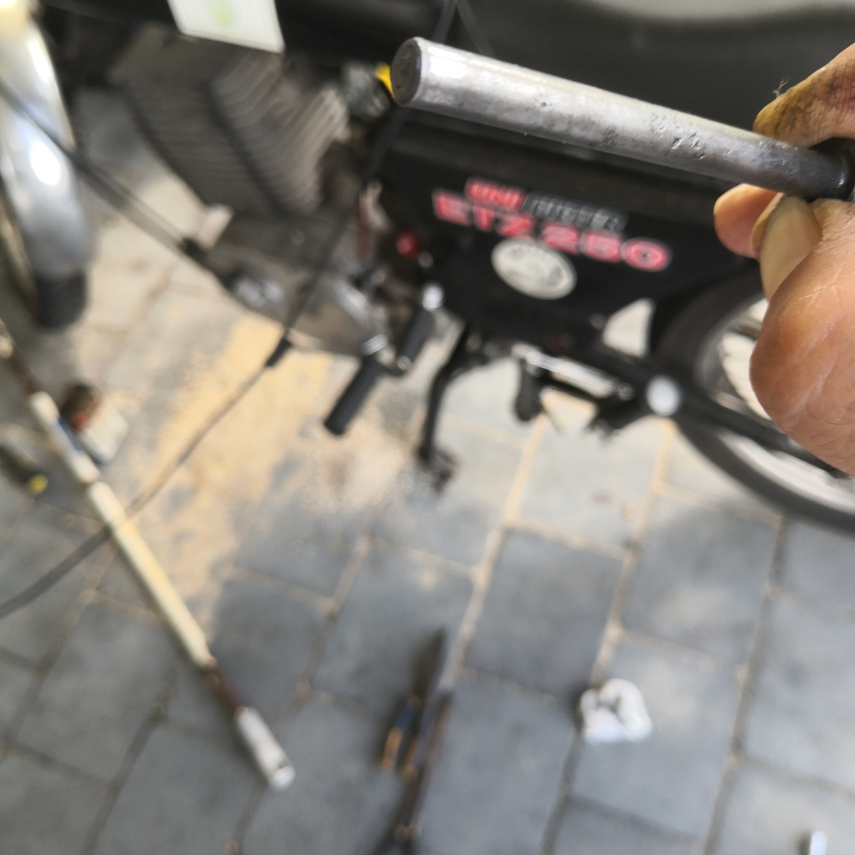

So here I am fixing the eternal MZ oil leak
Then notice, the top bolt connecting the engine to the frame sticks out. All the threads are polished clean... Except the first quarter turn.
I was able to just pull out, has anyone had that before?
Recovering from shock until I try a fresh bolt... Somehow this seems like a headache I didn't want!

I worked out what happened. The threaded bit has snapped
In the case . I know engine is still solid as the hole where it came out lines up perfectly.
It does mean that a bottom end or gearbox rebuild will require new case half..
Bolt was torqued properly, can only suspect metal fatigue...

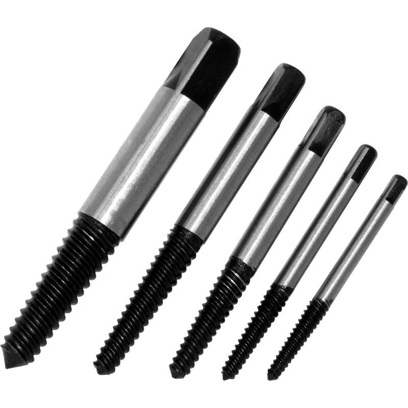

If you can drill a hole in what's left of the bolt, from the LH side (so through the bolt hole in the case), and then try to screw in one of those bolt extractors:
and then, once you feel some resistance, lift the engine (with a jack or so), to take off the friction in the case hole, you might get that end out & the sun will shine again.
You probably need to make an extension for that extractor.
Good luck!

Screw extractor could work, but as someone that snapped one when using the wrong size.... Probably best to drill, or pivot the engine when that time comes.
