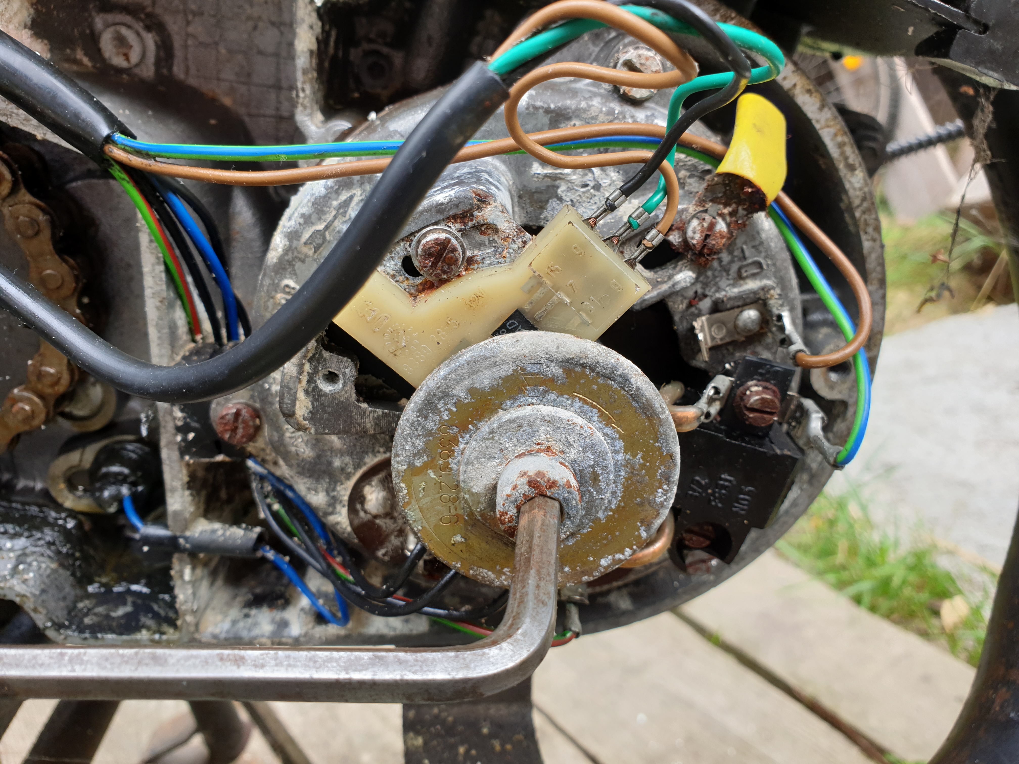

Postby jackotom » Sun Jul 14, 2019 1:53 pm
Pic of mz electrics.

Postby Blurredman » Mon Jul 15, 2019 2:20 am
From which ocean did you pick that out of? :lol: :P :P
Nah I joke- but seriously- I had the same ignition that I blew- Did you try as I suggested? :)

Postby Puffs » Mon Jul 15, 2019 5:38 am
Ah, the miracles of archaeology.
Ta for the pic.
A gentle blow with a small hammer on the end of the Allen key should release that hex nut, so that you can take off the trigger unit. The current breaker part of the ignition comes of with the adjustment nut at 11 o'clock. But you may want to dismantle the generator to clean & inspect it. Look in a manual, see Blurredman's signature. With the ignition removed, take off the brush unit, and then the stator housing with the 3 screws at 120°; that's probably enough for cleaning. You may want to do some tests with a multimeter too, to check the generator.
Most likely, the generator will only require cleaning (maybe some new brushes), but you will need to replace the current breaker part of the ignition, assuming it fails said test. There are several systems you can buy for that engine.

Re: Etz251 no spark
Postby jackotom » Mon Jul 15, 2019 1:57 pm
Hi,thanks for all your help.
I did remove the generator cover and cleaned it out, it was a bit rusty, I think I need to strip the generator and get any corrosion of the parts.
I have some new brushes and the part the brushes fit into(sorry don't know the name)
I don't know were to connect a mutil tester to test things as I cannot find my Haynes manual!
