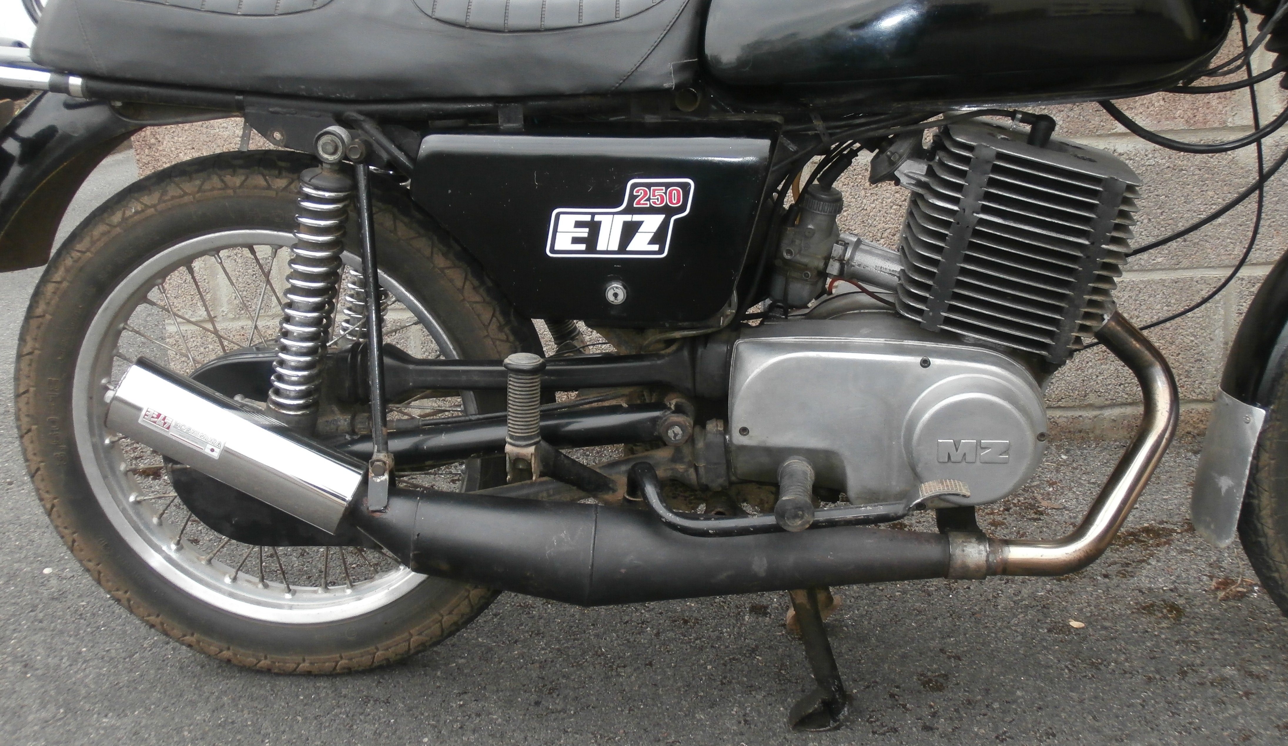

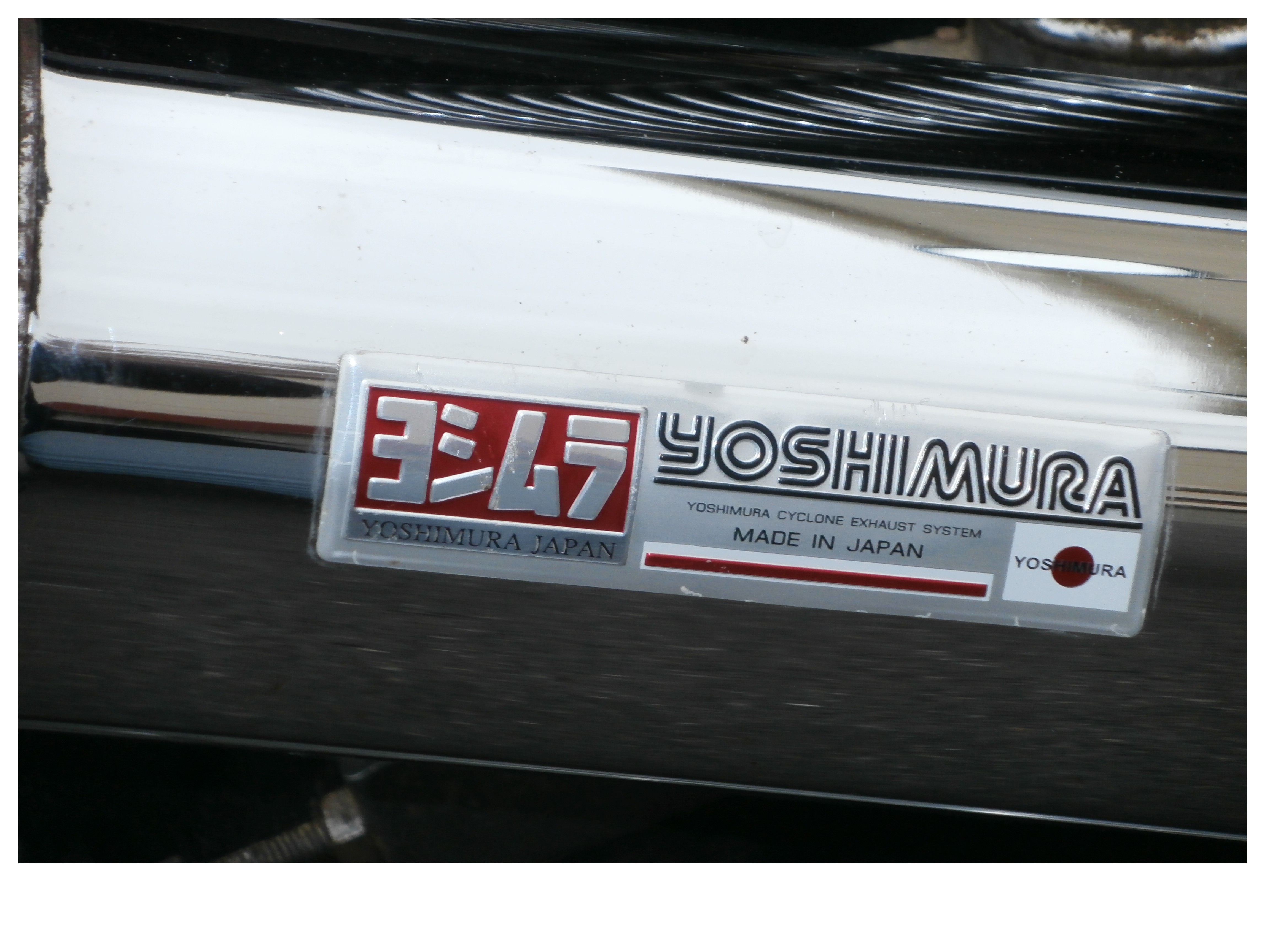

Postby Andy_C » Sun Apr 29, 2018 1:29 pm
dirtsurfer wrote:Let's see a picture Andy
You asked so here they are.
Pretty sure it is just the "run of the mill" one that is readily available - I think the "Yoshimura" Label was fitted by the previous owner and I'll be leaving it there just as a talking point :D

Re: Expansion Chamber
Postby dirtsurfer » Sun Apr 29, 2018 3:47 pm
Good find!
