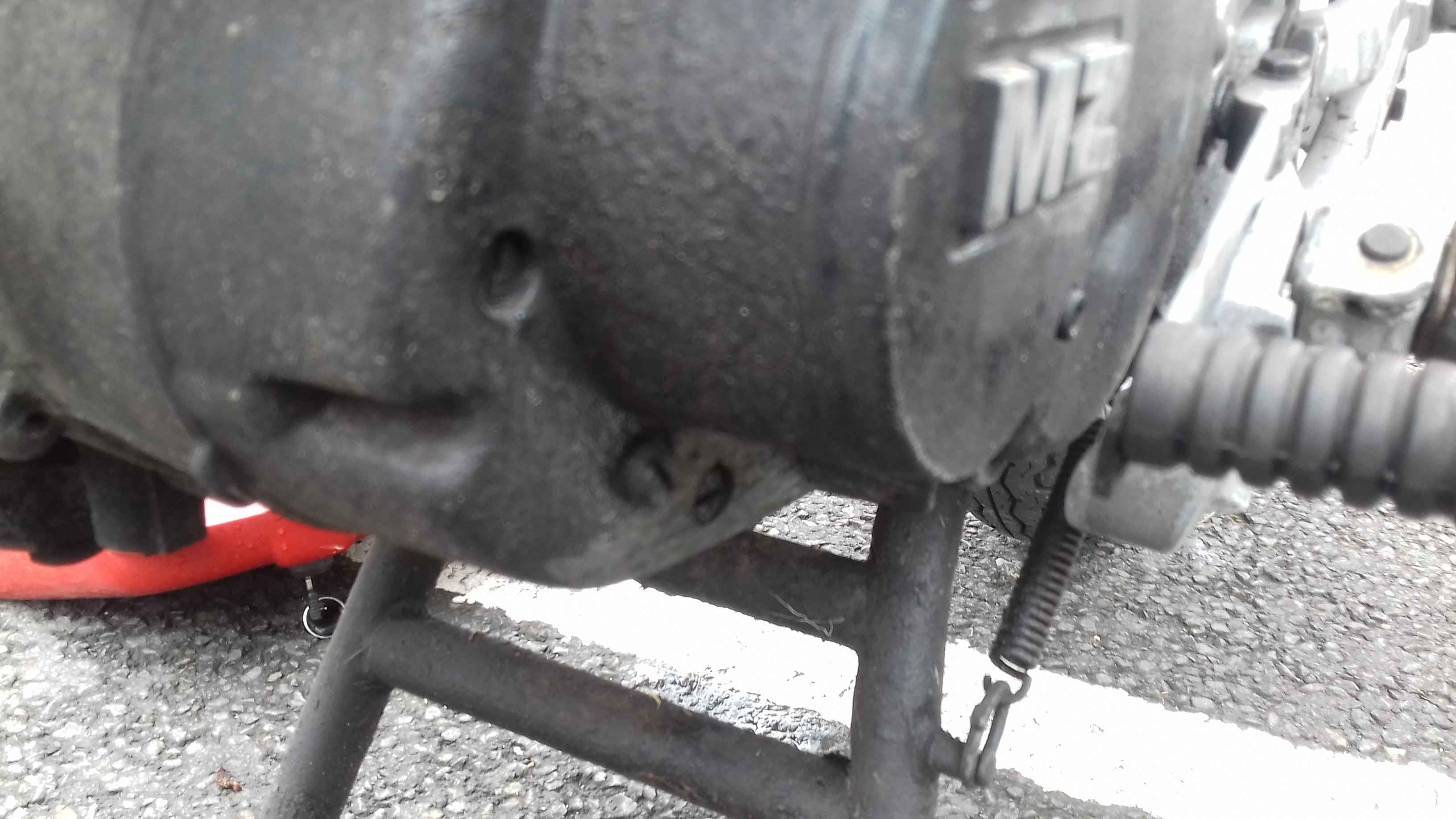

Is it this one Puffs?
The transmission oil is checked via a screw on the left-hand side of the engine. If oil comes out it's OK.

Yep,
is the one Haynes indicates for the 125/150. Total volume is just 500cc.
