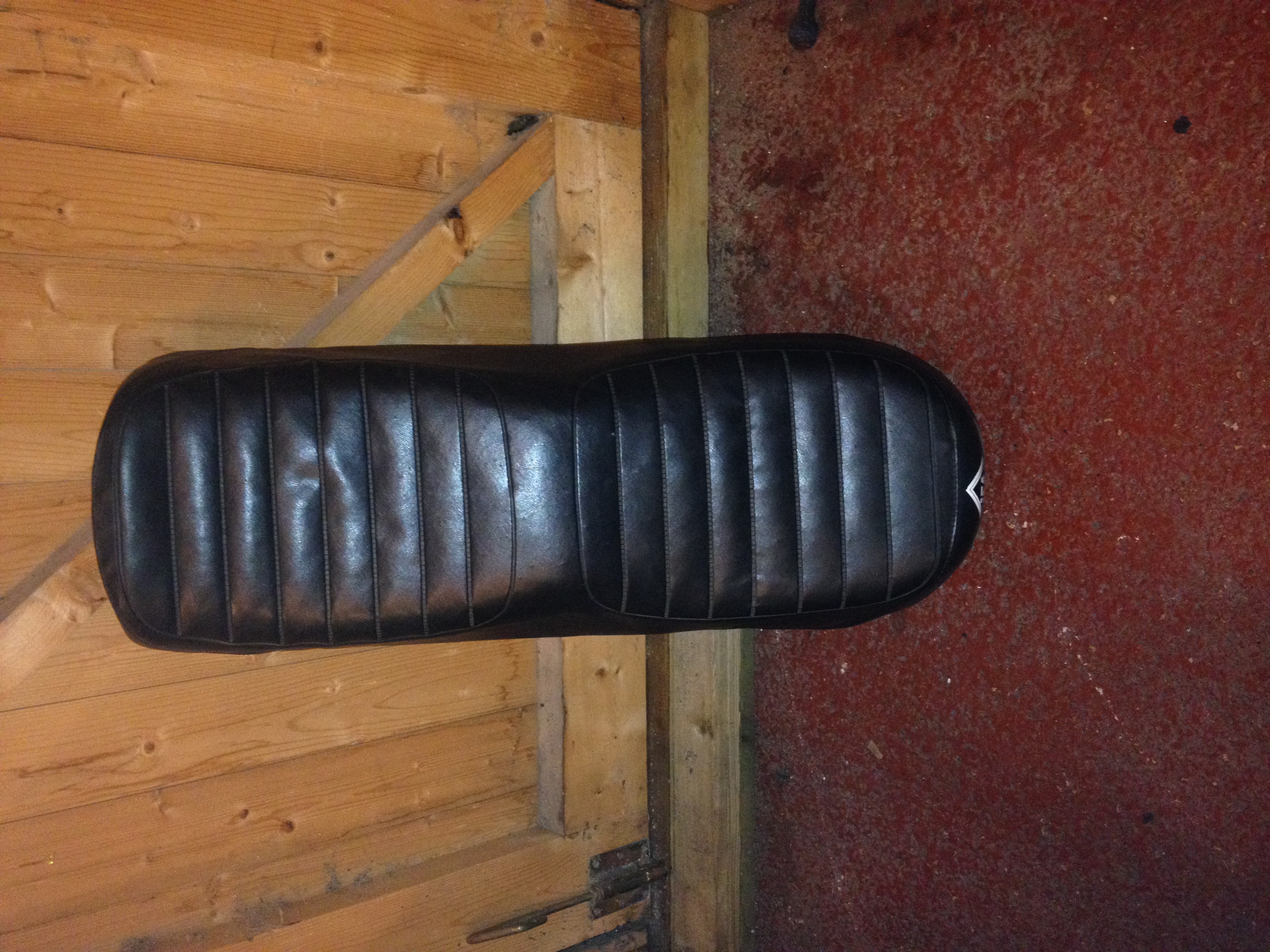

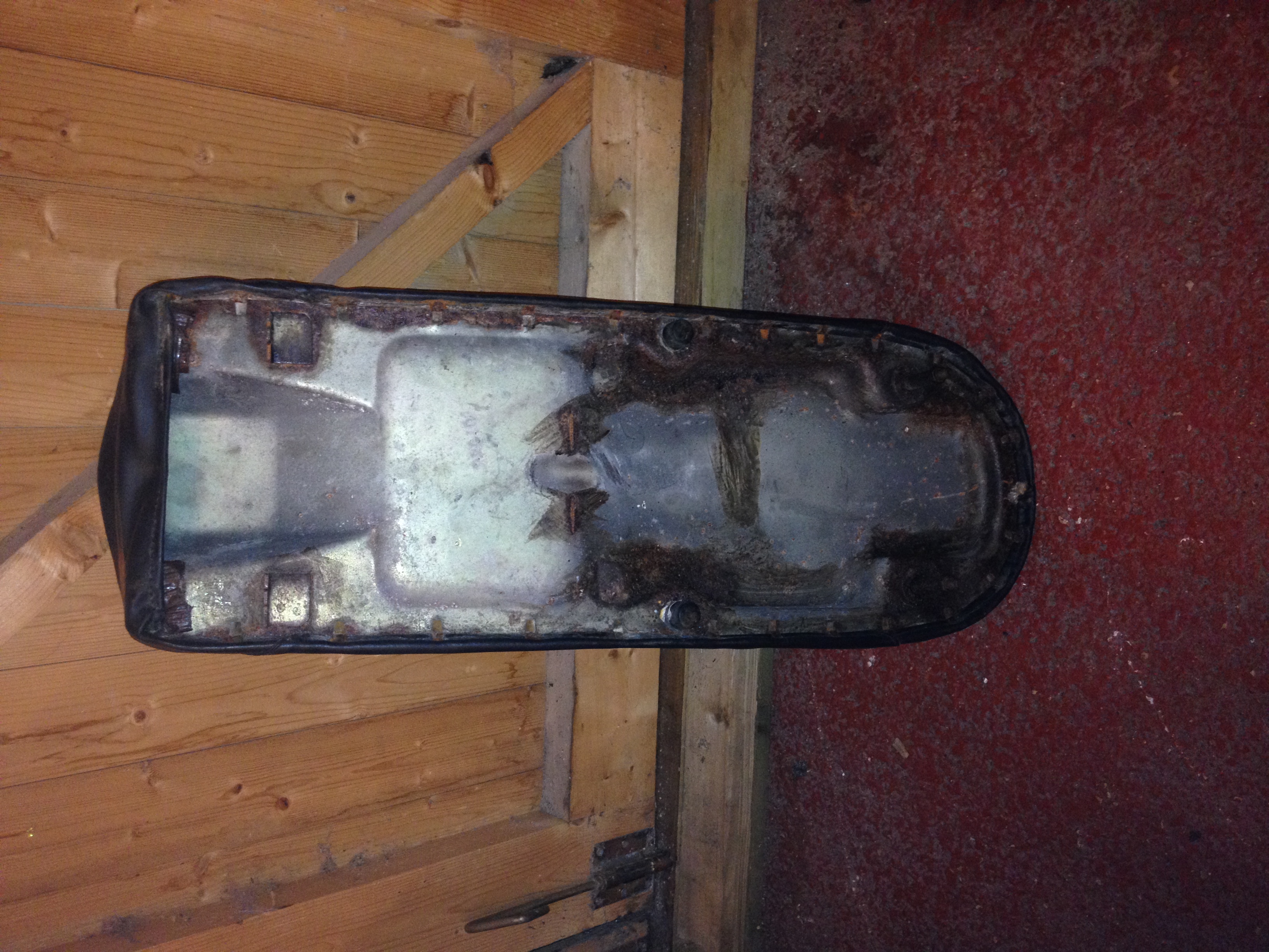

Postby Uncle Nick » Sat Oct 28, 2017 1:13 pm
Thanks for the replies and help guys.
I bought the bike (in boxes and large lumps) from the family of a guy who started the rebuild in his 70's but died before it was finished. His grandson couldn't find the log book or registration plate so I'm not even sure if it's a 250 or 251. The speedo is in mph so I'm pretty sure it's a UK bike.
I've attached a couple of pics if they are of any use.
I checked the locating pegs are in correctly so it's not that.
Any tips on differences between 250 and 251 would also be great thanks.

Postby Guesi » Sat Oct 28, 2017 1:57 pm
It´s an ETZ 250 seat. But as long as I don´t see the frame, I cannot see if you have an ETZ 250 or ETZ 251.
The ETZ 251 frame is shorter than the ETZ 250 frame.So maybe you have an ETZ 251.
Can you post a picture of the tail end of the frame ? Then I can tell...

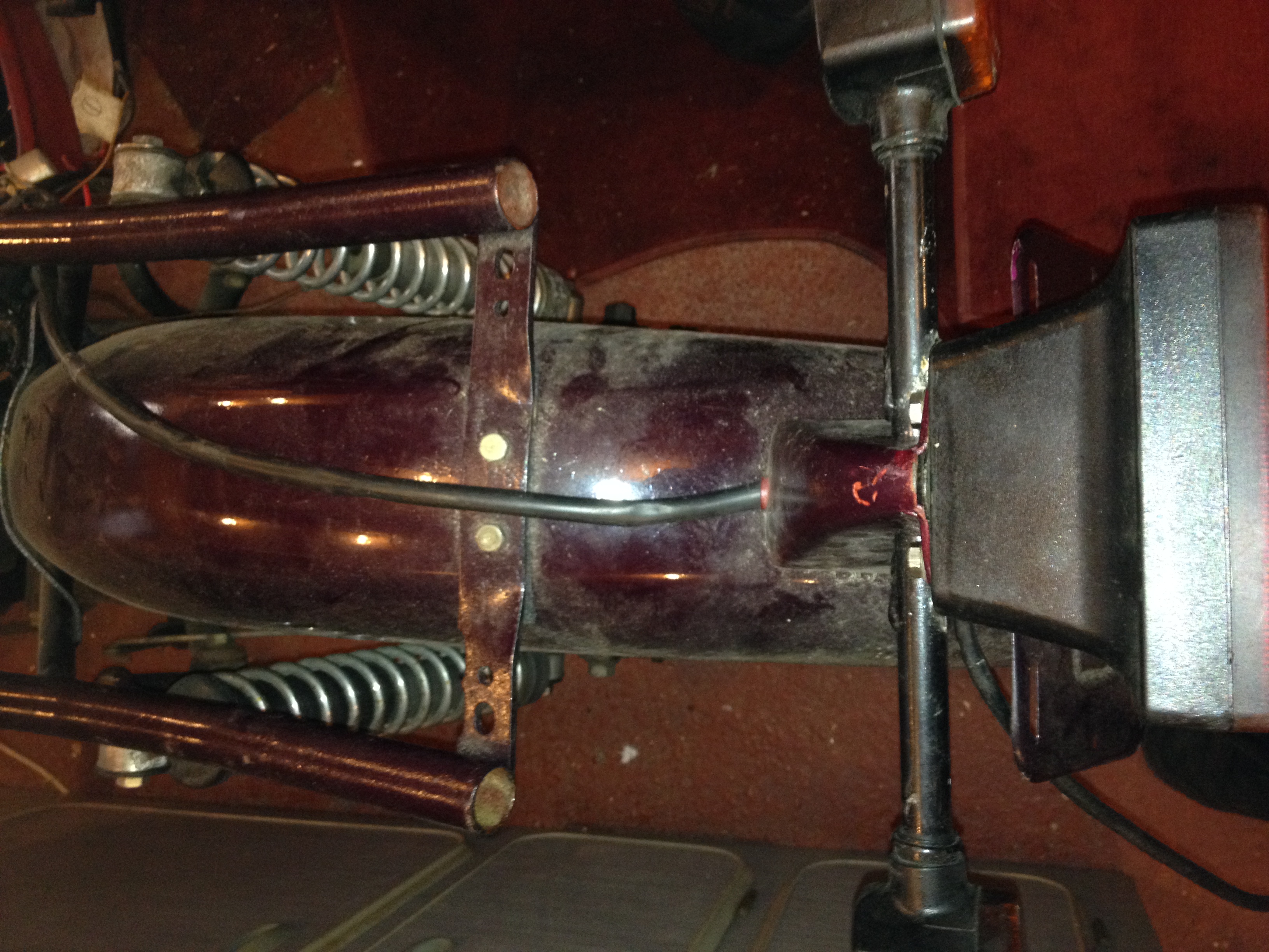

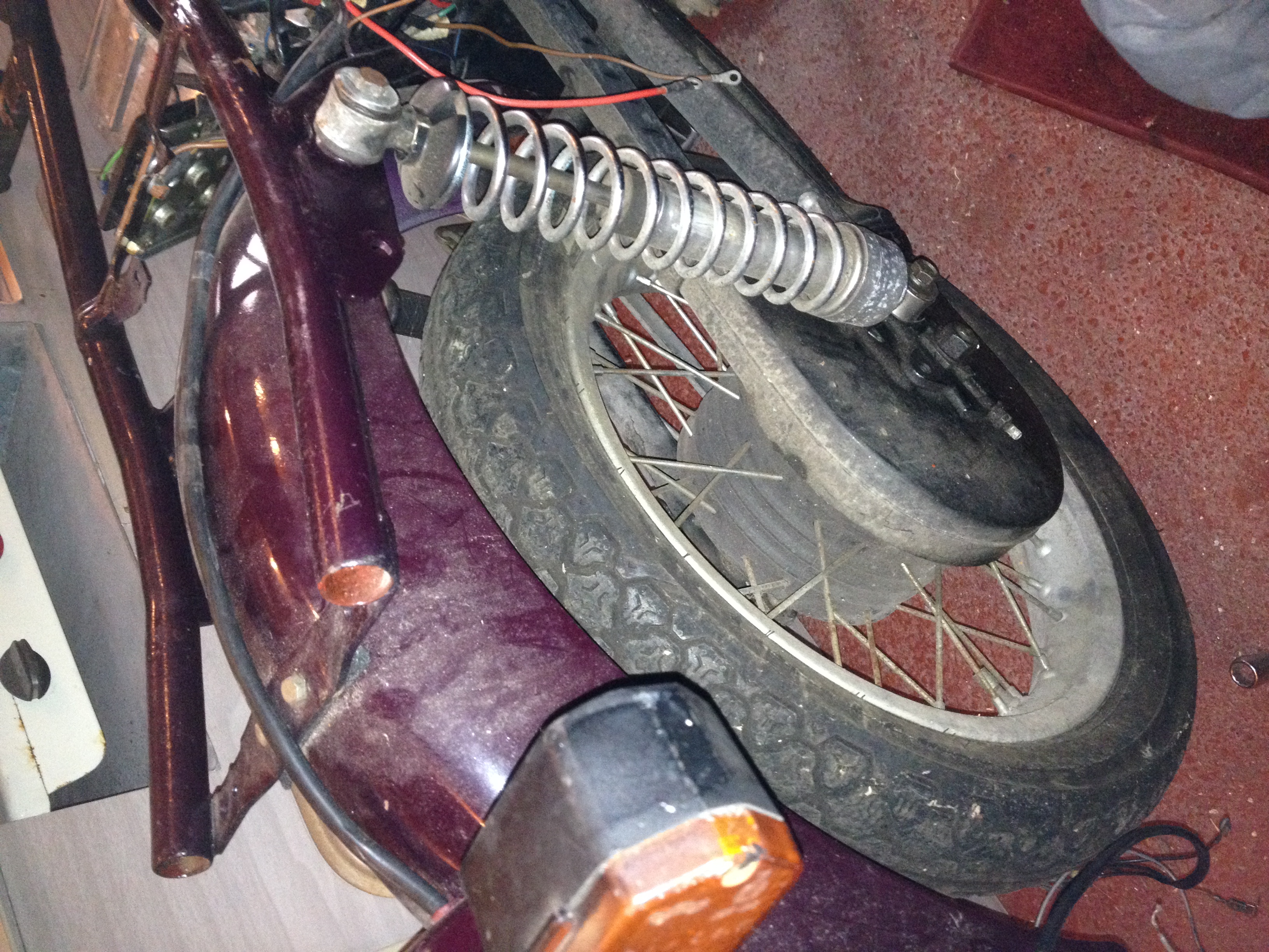

Postby Uncle Nick » Sun Oct 29, 2017 4:37 am
Thanks Guesi, here are a couple of pics. I bought the rear light unit separately so it may not match correctly, though the mounting bracket was already attached to the mudguard.

Postby Guesi » Sun Oct 29, 2017 3:18 pm
As I thought:
The frame is an ETZ 251.
So you need a seat for ETZ 251, not ETZ 250....
