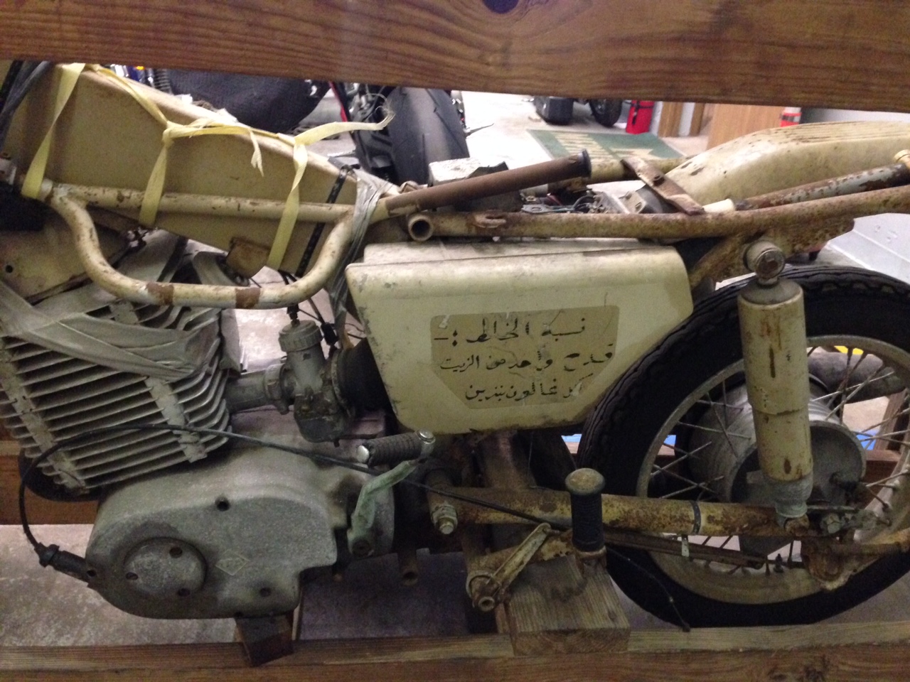

This came into the shop . What model ?
Postby STANIMAL » Sun Apr 12, 2015 11:29 pm
This is an MZ 2T . Thats all I know about it . Unfortunately , the compression is too low to start it and dont have a clue where to get parts . Any thoughts ?

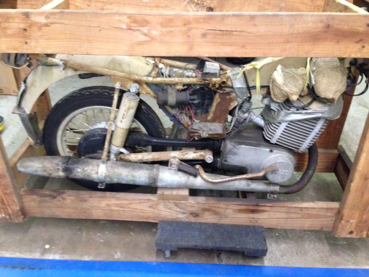

Re: This came into the shop . What model ?
Postby DAVID THOMPSON » Mon Apr 13, 2015 11:26 am
if some one can read the writing on the side cover it may help ...looks like sanskrit or one of the mid eastern languages
may be one of the made in turkey MZ clones
need to figure out exactly what it is then go from there
Postby brennain1 » Mon Apr 13, 2015 4:10 pm
Looks to me like an ETZ 250, looking at the frame and engine. The rear shocks look to be from an earlier Ets model and the exhaust looks to have had a section welded onto the end.

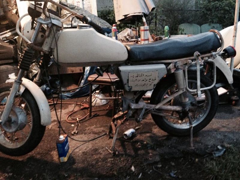

Postby therealche » Mon Apr 13, 2015 6:19 pm
It's an ETZ250. It is a premix version ( no oil pump fitted). Is it from Iraq? I know Ive seen one just the same somewhere, and I think the writing on the sidepanel is a reminder to add oil to fuel!
Postby therealche » Mon Apr 13, 2015 6:39 pm
Knew I would find it... Joe Adams in Louisville, Kentucky has one the same. He is a member of the "MZ Motorcycles" page on FB
Postby alexxx » Tue Mar 14, 2017 7:24 am
seen a similar one on ebay uk advertised as an ex Iraqi army issue machine (someone translated the side panel text also)
