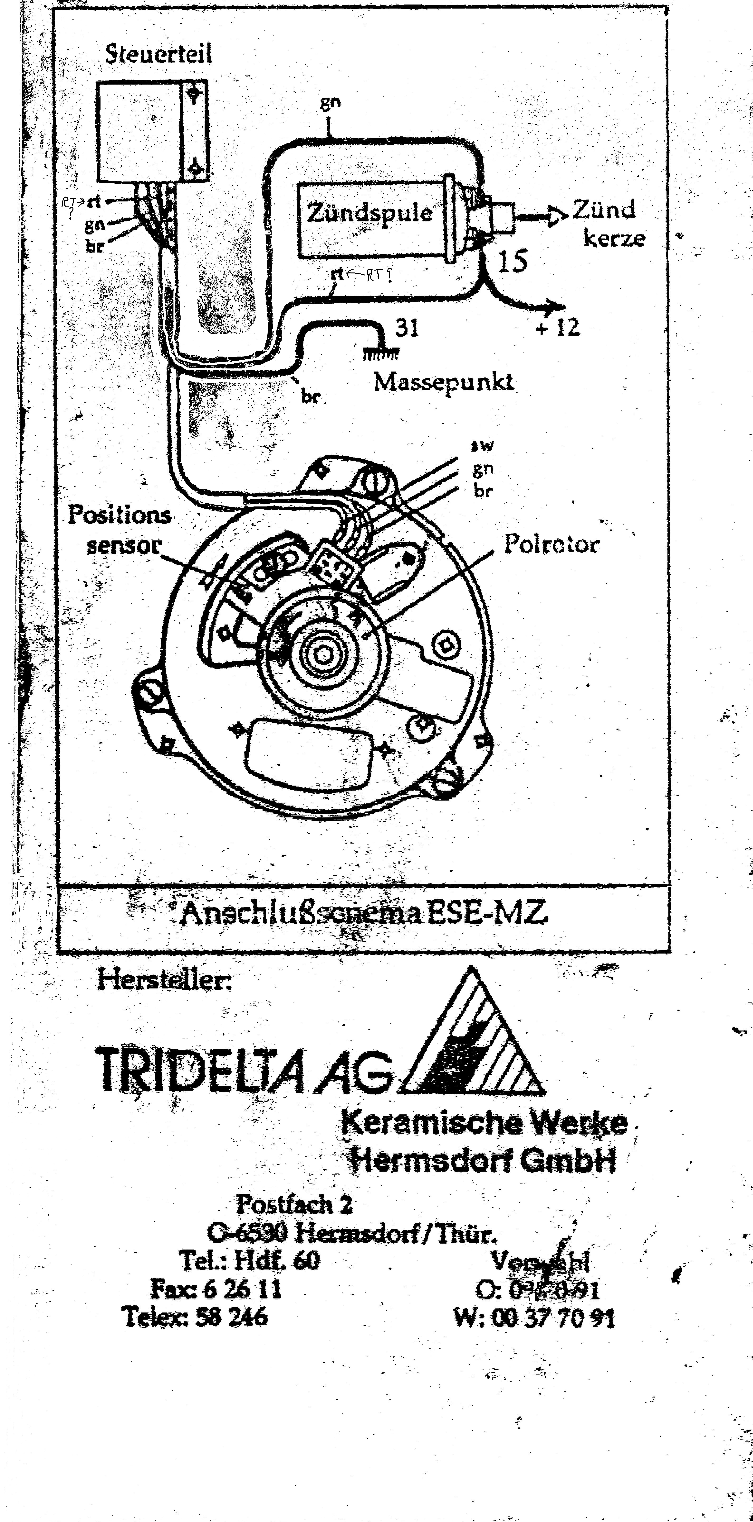

Postby Guesi » Thu Sep 08, 2016 1:15 am
Hello
I found a wiring diagram for this ignition.
For adjusting the ignition they write:
Turn off the ignition
Unscrew the ignition spark.
Then measure 2,6 mm before top dead end.
Put a 12 V bulb with wires between 1 and 15 of the ignition coil
Turn ignition on.
loosen the 2 screws that hold the sensor a little bit.
Move the sensor with the 3 wires clockwise until the bulb begins to light up.
Turn the sensor back carefully until the bulb gets dark.
The more exactly you find this point the more exactly is the timing.
Tighten the screws that hold the sensor.
Make 1 complete turn of the crankshaft to control the timing at 2,6 mm .
By the way:
Thge distance between sensor and the magnetic ring on the rotor must be 1,5mm + 0,3 mm.
Guesi Motorradteile
MZ spare parts
Posts: 461
Re: Year of introduction of Electronic ignitions..?
Postby Blurredman » Thu Sep 08, 2016 3:35 am
Wow! Thank you very much Guesi!! This is indeed what I was hoping to find! :D :D :D :D
Do you mean however 31? Not 1? In reference to having an inline bulb "between 1 and 15 of the coil"... :?:
Posts: 1266
Postby Guesi » Thu Sep 08, 2016 4:17 am
No, I mean 1.
The 2 contacts on the ignition coil should have these "names"
Guesi Motorradteile
MZ spare parts
Posts: 461
Postby Blurredman » Thu Sep 08, 2016 4:20 am
Oh I see! Sorry, the 1 on the terminal on the coil in the diagramme is rather obscured by the scan quality.
Thank you very much. I will try this tonight! :smt006 :smt006 :smt006
Posts: 1266
Postby Guesi » Thu Sep 08, 2016 4:24 am
I could not make a better quality, because the paper is quite old and worn out :-)
Guesi Motorradteile
MZ spare parts
Posts: 461
Postby Blurredman » Thu Sep 08, 2016 4:47 am
I'm definitely not complaining! :)
I have however, taken the liberty to 'restore' the number 1 and also added it to my own document database for future reference and for anyone else who requires it.

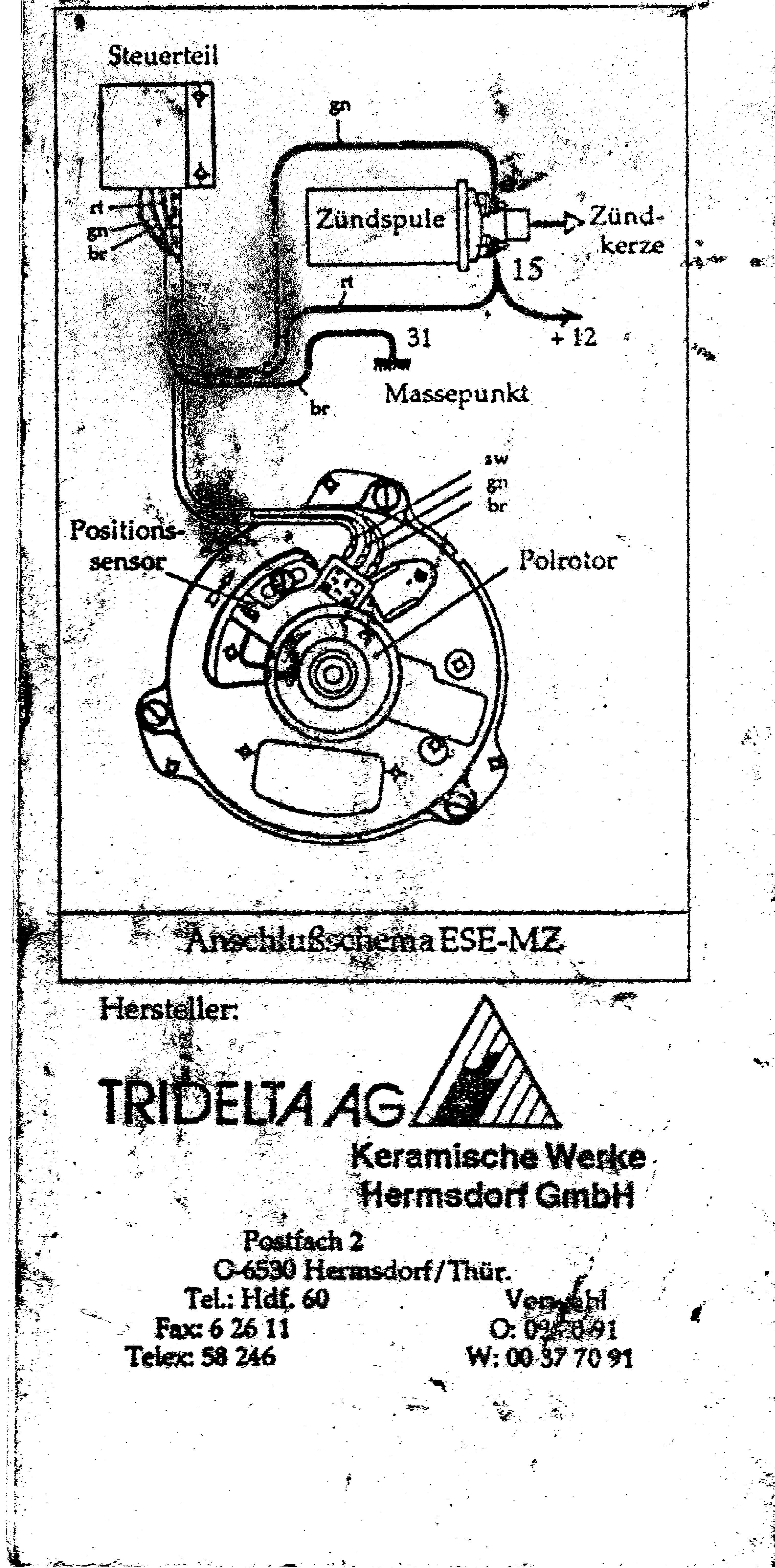

Postby DAVID THOMPSON » Thu Sep 08, 2016 2:28 pm
I think that the use of number 1 is the side of the coil that the points ground when closed
15 is switched power older bikes with a mag show 2 as the ground for the mag kill button
i edited the drawing in above post as it did not come out correct the site cropped most of it
i used the drawing in paint and tried to clean it up
click to make bigger or download it
