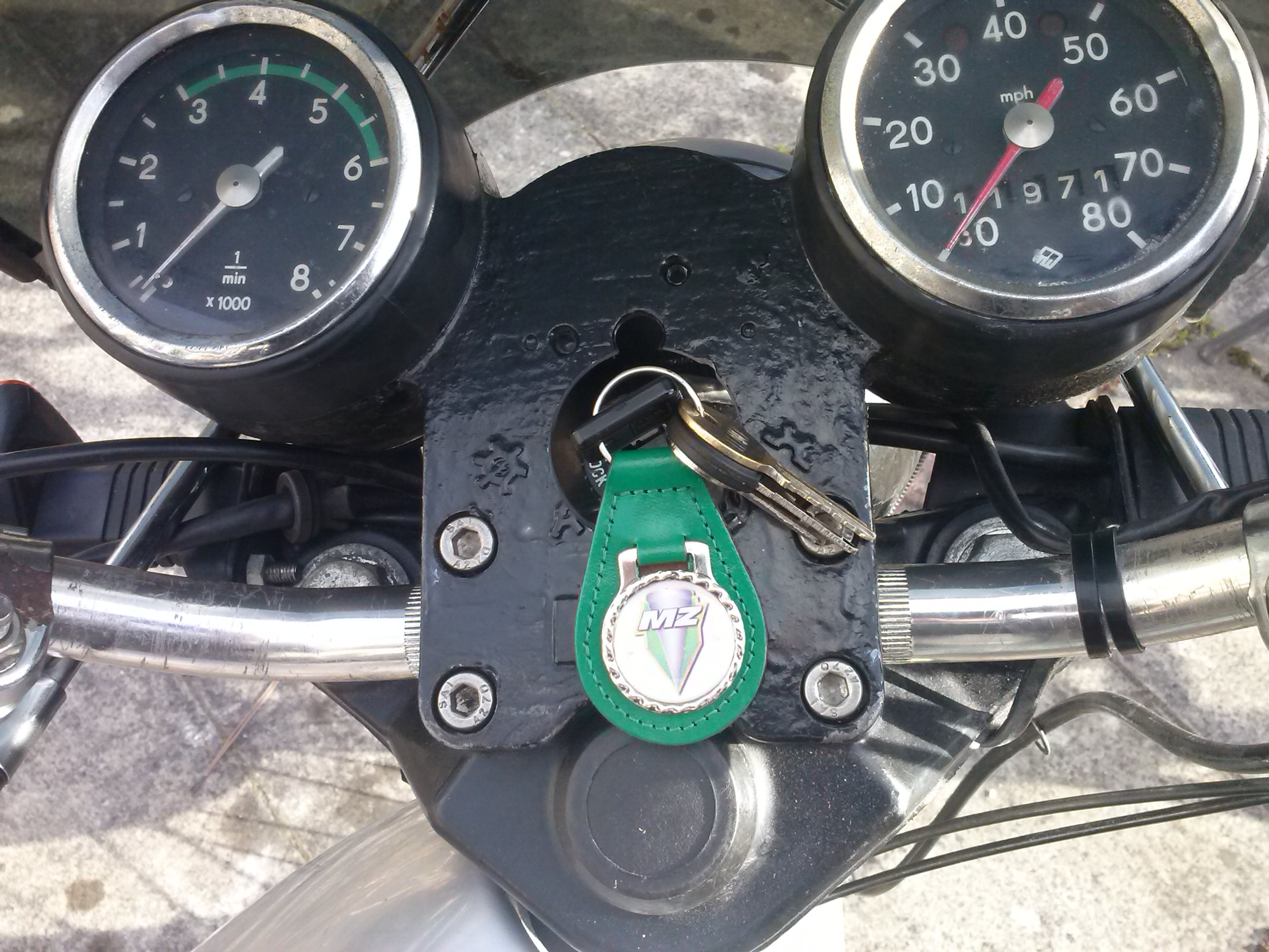

I resorted to fitting earlier mechanical rev counter and speedometer the parts were cheap and it works .The picture shows the instalation before sorting the cosmetics,
