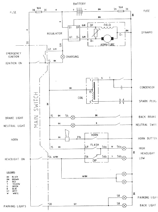

hi all, I have a 77 ts 150 which I stripped for restoration. I tried to leave the wiring as intact as possible, but since I took the bike apart over a year ago I have totally forgotten how to re wire it. I have a Haynes manual as well as what's on the internet regarding wiring diagrams. Problem is I'm a total dummy when it comes to wiring so even the simplest diagram has me stumped. Does anyone have the idiots guide to wiring a ts150 showing what wires go where in the headlight and fuse box. Even some high res pictures that I could zoom in on would be great? cheers, John

I always find the original MZ one easy to use.
http://www.mz.cx/technik/elektrik/schaltplan-6v-l.jpg
Click on it to enlarge , I had one printed out A3 and laminated.

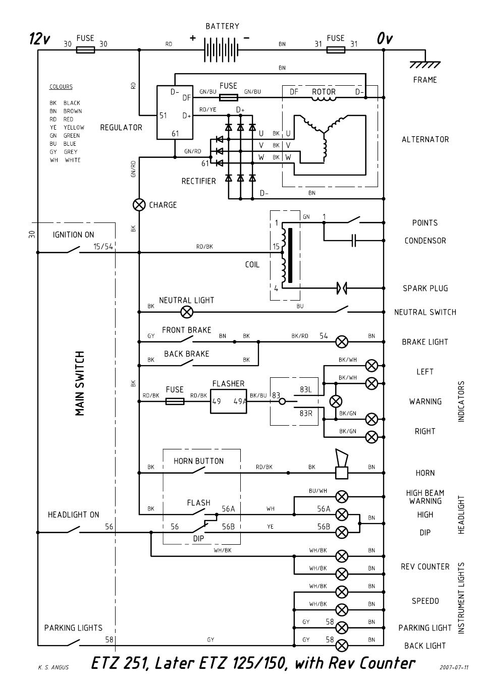

Postby DAVID THOMPSON » Thu Jul 24, 2014 5:26 pm
page goes crazy when it displays on my machine
i think this is it
and it may be the screen size as the other computer displays it ok
click on pic to see it bigger
Re: wiring help needed
Postby therealche » Fri Jul 25, 2014 5:36 pm
You need to swap these for the 6V ones Dave.... it's a TS not an ETZ

Postby den » Sat Jul 26, 2014 5:19 am
ok , this is it ,,obtained from here--http://www.moser-bs.de/
ts250-1-vape.pdf
also for the 150
(225.31 KiB) Downloaded 373 times
