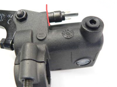

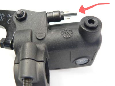

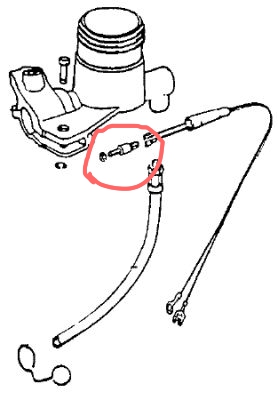

Postby therealche » Fri Oct 18, 2013 8:31 am
If it is a Square master cylinder
96 24 451.jpg (44.42 KiB) Viewed 5618 times
If it is a round one
And they are horrible fiddly things that break if you look at them wrong!

Postby therealche » Sun Oct 20, 2013 3:22 pm
Quite often the switch breaks flush with the master cylinder
Just leaving the threaded portion corroded in place. It's one of the few times I would use an easyout to get the threaded bit out
