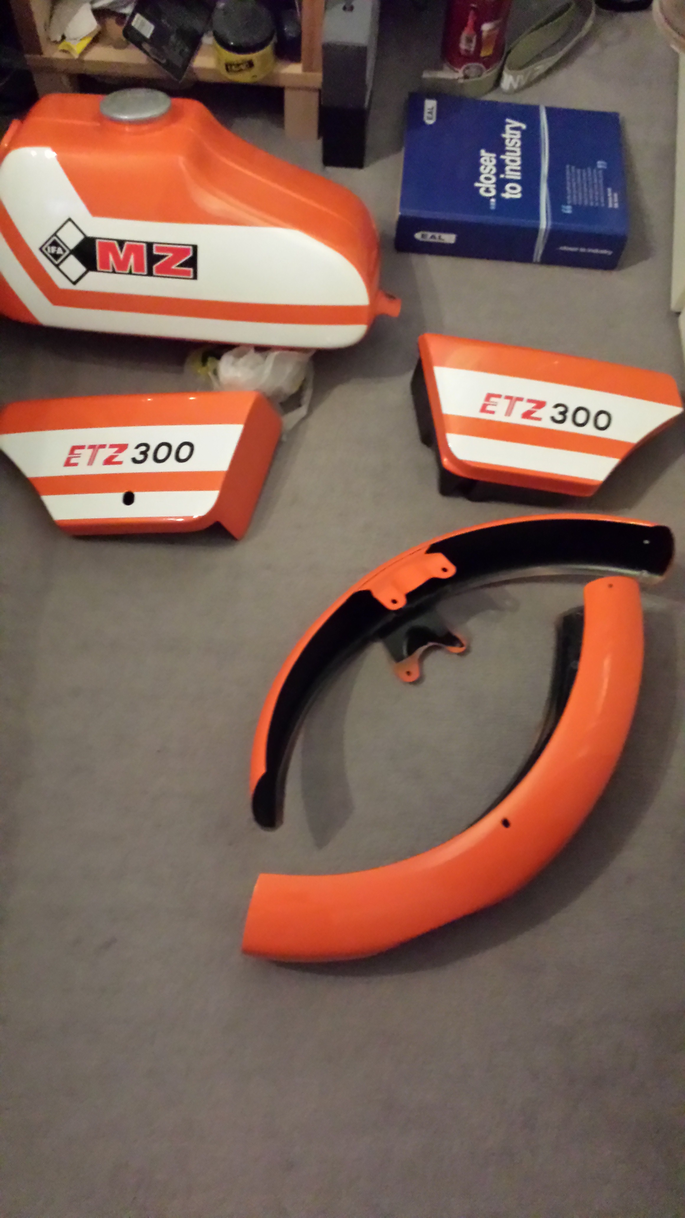

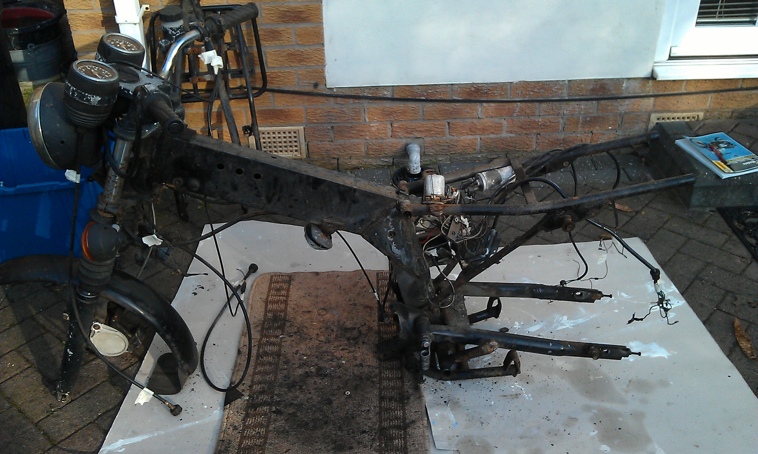

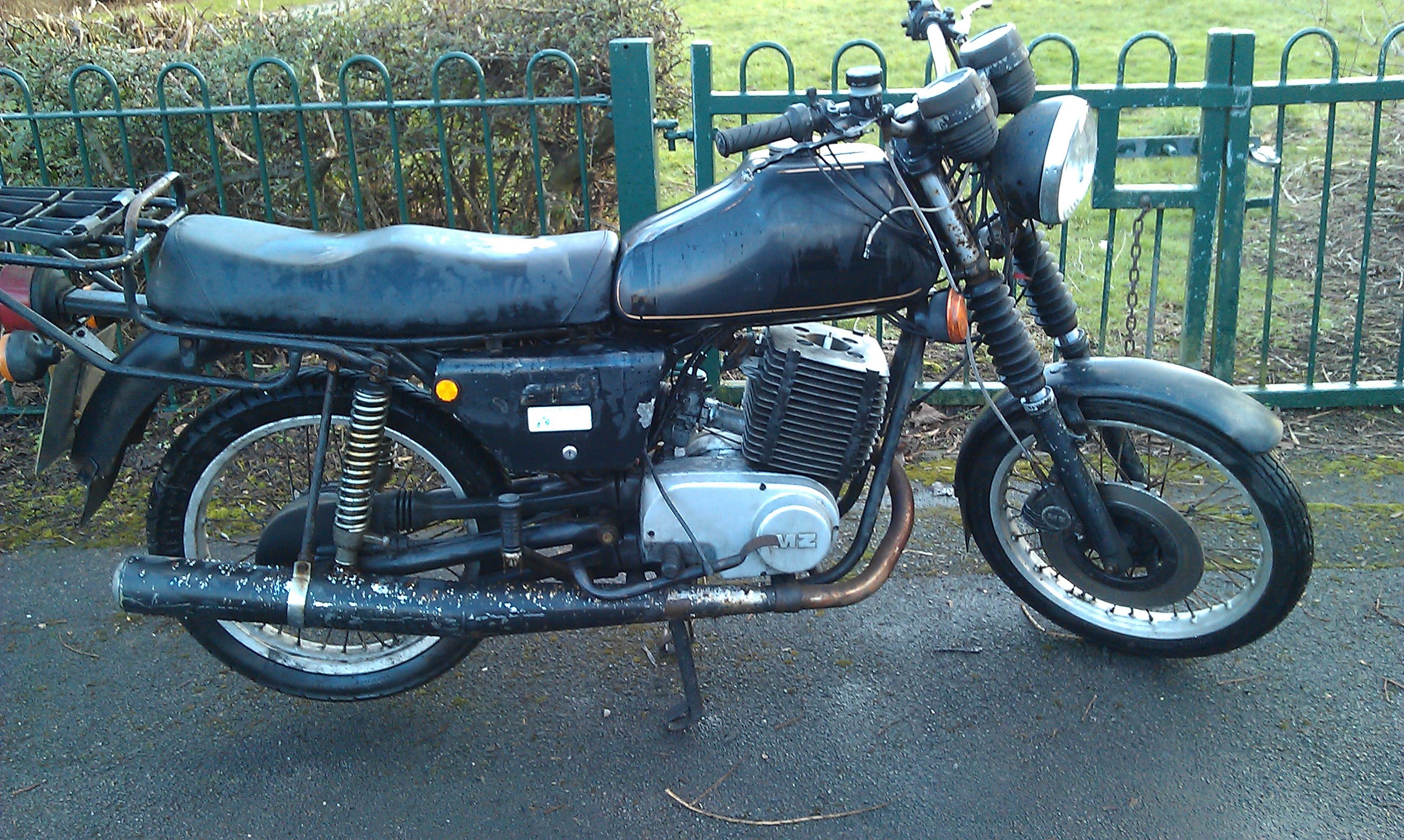

Hi guys, I'm Liam and this is my ETZ. I bought it a couple of months back and I've stripped and began rebuilding it on my patio. The weather has slowed things down, but we're getting there. It's a 300cc bike, rusted to hell and non-running due to wiring issues, but had good compression when I bought it. My first full rebuild project, but I do have a reasonable amount of experience working on bikes, having owned 9 in my 5 years of riding.
To give you an idea of how it will look once complete...

AFAIK, there are no wheel conversions that let you keep the chainguard and speedo drive. You've probably already seen that the rear tyre doesn't look to be the right size for the bike - should be 3.50 x 18.

It looks like a good solid basis for a rebuild. Check the "foot" under the engine for rust, deal with any you find now before the stand stop and footrests fall off. That's the only bit that suffers from corrosion.
