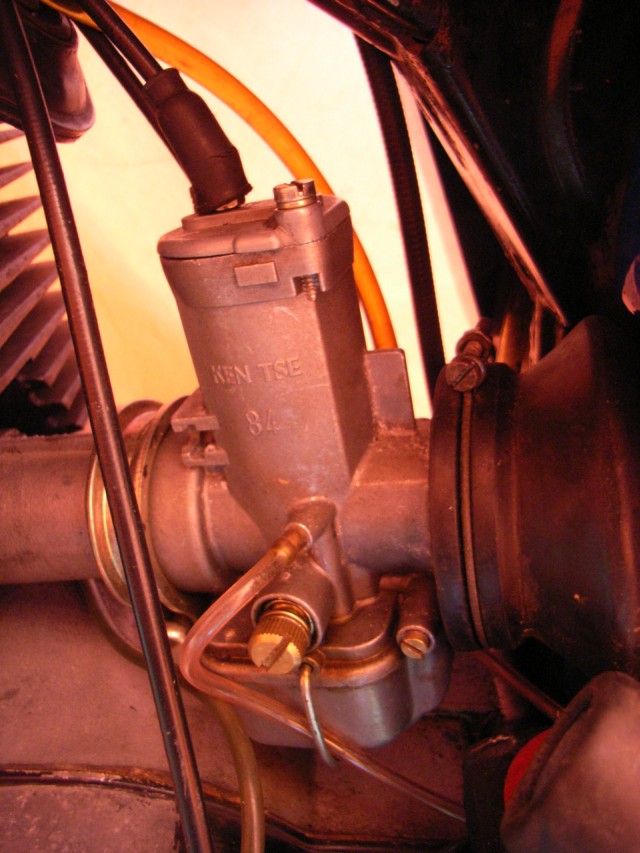

Edited to add: I've had a look at the carb and it doesn't match any of the pictures in Haynes. The guy who sold it to me said it's got a Bing carb, being a later model, but it's not - I've just looked up the markings and it's a Ken Tse 84 Taiwanese one. I presume they're not the same thing, and also that this "engineer for decades" doesn't know is A from his E. And I'm not sure I dare ride this bike except to the nearest garage to get it repaired.

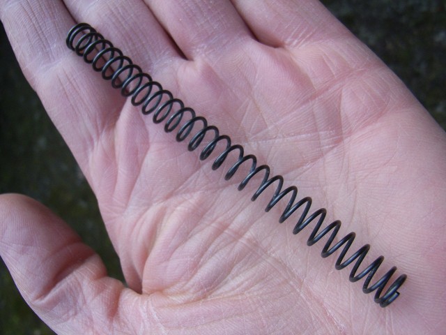

I'm completely new to MZs and only have a little experience with carburettors. As described in an earlier post, I bought a 1993 ETZ 251 Saxon Tour a while ago, I don't think it was running right on the way home (excessive judder on the overrun). The previous owner had removed a spring from the carb (I think it can only be the main return spring, which he put in a goodie-bag for me along with some spare plugs and spanners). I'd like to pick your brains before I start trying to fix it. I haven't dared ride it since (also due to the snow), and it's due for its MOT in a couple of weeks. One other point is that the tickover is set far too low, I believe. He said it should tick over at around 500 or 600 RPM, and although it did when I went to look at it, it cut out after my 35 mile ride home (I didn't dare let it idle at any other stage of the journey!). The Haynes manual says 1200 +/- 100, and others have said something similar.

Would removing the spring cause the judder? He said he did it because when you let go, it reduces the gas gradually instead of all in one go, suggesting it's actually smoother on overrun (although he didn't spell this out in detail), and because it reduces the tension on the throttle, so you're not having to grip it quite so hard. My experience was that it was nice and light and it closed ok, apart from the juddering. Should I replace the spring and try it again? I've been advised here that I shouldn't ride it without, and even the previous owner admitted there was a risk that if you ever gave it full throttle the needle might come out of the jet and not go back or something. This was long after the deal was done, money in his account, and I was about to take it home.
If I replace the spring, should I attempt to open the carb top and remove the throttle valve to reinsert the spring (i.e. without taking the whole carb off)? Would I need to adjust anything afterwards, or would everything else stay as it was? Speaking of which, are there any settings you'd suggest instead of the ones in the Book of Lies?

Yes I did, thanks - unfortunately it's none of those, and I don't have anything on how to tune it or how it behaves when stuck on a 251. I don't even know what the screws do. If I were more used to messing with bikes I might even be able to identify them. But even if I can apply the Haynes instructions to this, I'll probably still have weeks of tweaking to set it up well, maybe months, since I'll be interested to get the best mpg I can. I'm getting MOTs on this and my old bike, so I'll ask the guys there if they can help me set it up.
What's what?
It's got a rather long, thin return spring, quite unlike those in the standard carbs. I imagine it would make the throttle a bit heavy by the time I squeeze that in there - it's as long as the whole carb.
I would suggest that the juddering could be down to to the slide spring not being fitted,it is there for a reason!

That carb does seem like it belongs there,are you sure that it is non standard?

Throttle stop screw,and low speed mixture screw you can see,other adjustment is needle position within the slide.Assume your float height is correct as it`s unlikely to have been altered really.
That spring looks awfully small(Diameter)for a slide spring!

i am in the process of putting my 251 saxon tour back on the road at the moment and ive had all kinds of problems with the carb, The carb you pictured there looks to be correct there to me, it should be a bing type 84 carb. the slide spring you have pictured is completeley wrong. it should be a much wider shorter spring wich wouldnt be as hard to twist the throttle, bing are still manufacturing and you can buy any spares right up to a full new carb for your bike.
The two adjusting screws on the side:
the larger one with the spring is the air by pass screw and the smaller one is the air idle screw.

Thanks cmtstu, I have wondered which screw is which, so that helps. But it's not a Bing, it's a Ken Tse. That's one of the problems - the manuals aren't much good when it's a non-standard carb. On the other hand, it may be perfectly fine, even better, I just don't know yet, as I haven't had time or inclination to do anything with the bike since I got it home, including riding it. Might need to get it into the garage.
