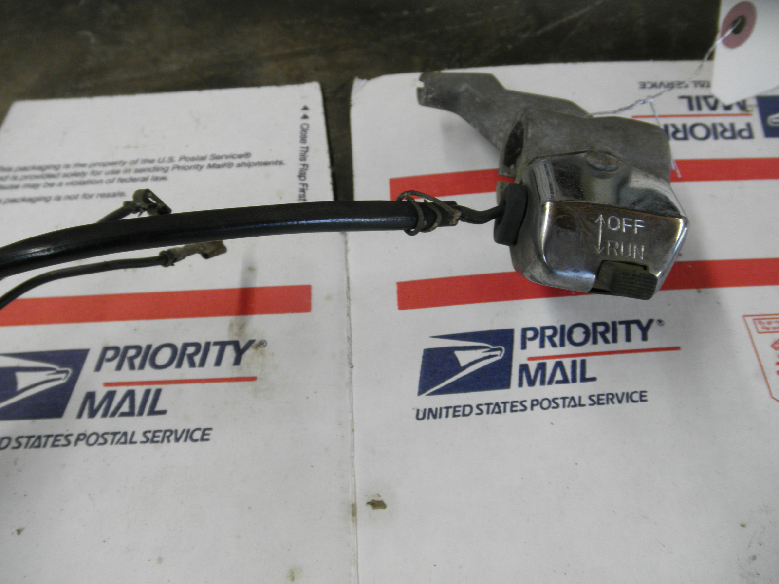

DAVID THOMPSON wrote:did you knock the kill switch to off on the right hand control
UK bikes don't have a kill switch Dave, seems like that's a US thing. Was wandering through eBay.com and came across this switch
Which ( apart from the fact someones stuck it on the wrong side) would on a UK bike be the indicator switch ( up for left, down for right). The similar switch on the left hand side was the headlamp dip switch ( and had the horn button)
With the later switchgear ( I was going to say modern but that would be an exaggeration) there is no switch gear on the right hand side, and the left hand cluster has dip, horn and indicators in one unit. This applies to the 2-strokes, not had a Rotax engined MZ (yet!)
