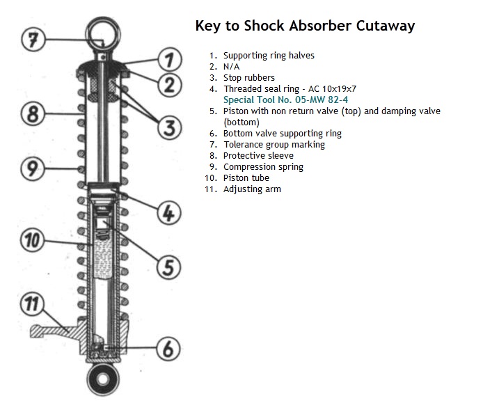

I'm sure Fred Rogers used to rebuild shocks. There is a simple guide to dismantling shocks at http://www.sweller.co.uk/mz/workshop/wrk_shock.html.
If you have some shocks that have reached the end of their useful life its probably worth a go taking them apart. Just cleaning the innards and replacing the oil should make a noticeable difference. If the seal at the top has gone you might find something to suit at http://www.simplybearings.co.uk/shop. ( from the sweller link it looks if it might be a 10x19x7). The top eye unscrews from the rod, though how you hold the rod without damaging it I'm not sure.

(I've copied the picture from the link in the last post to save jumping between the two)
I had a tool made based on the drawing, and used that to unscrew the 'threaded seal ring' (part 4). The ring usually comes out OK, but if it is seized in place, the body of the shock can distort first. Soak it well with penetrating oil, or use a little heat.
Once you get the ring out the shock comes apart. The seal is fitted into a cup that is made of very thin metal and easy to distort, so take care. The seal used was unobtainable as an MZ part, but was a standard seal available (very cheaply, I seem to remember) from engineering suppliers.
I never had a problem taking the eye off as they never were that tight. I used to hold the rod in a vice with soft faces and unscrew it, usually by hand.
Clean everything, fit the new seal, refill with oil, and reassemble. If you've got this far, then it will probably work.

At this point, it becomes clear that the diagram above is rather simplistic in places. The component '4. Threaded seal ring' is actually made up of no less than eight individual parts!
Theres an aluminium ring which carries the actual seal. A pressed steel cup sits over the seal carrier, and carries a large diameter rubber washer and a steel one. On top of all this sits the threaded aluminium ring you can actually see from outside (and which also turns out to contain a fibre washer and a felt one)! Galvanic corrosion had, of course, stuck the whole lot together, so all the bits had to be carefully prised apart and cleaned up. I think the general idea is that the rubber washer is supposed to be squashed when it's all tightened up, and seal against the shock absorber body.
