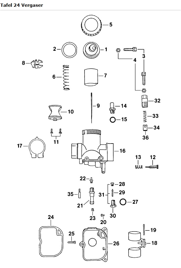

Hello, I can't find any screw to adjust the idle speed on a 1977 ts 125 with the vbk carb. Thanks

Nope you won't! there isn't one. Heres a link to a how to guide for setting the tickover

read the directions that's cheating
using the throttle cable to set the idle speed
lost an idle set screw once did that to get home

Thanks for the reply guys, it just seemed like if I used the cable to adjust the idle, there would be no free play. I will give it a shot later today. Once again thanks for the info.

Not cheating Dave thats how MZ did it honest!
There's a mixture screw but they didn't bother with a idle screw.

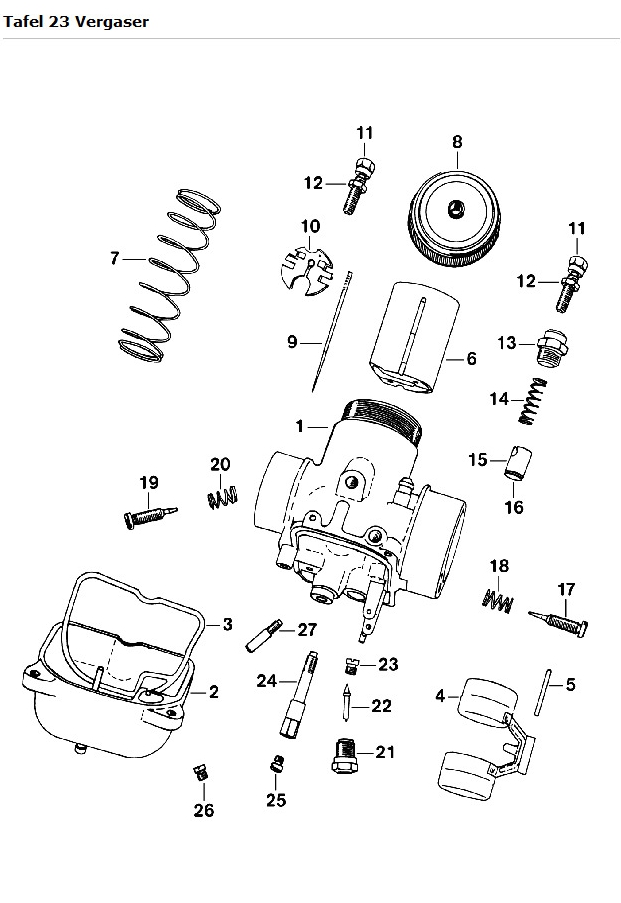

As opposed to the carb used on the TS250/1 which has both
