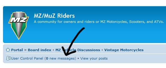

Postby DAVID THOMPSON » Tue Apr 10, 2012 9:50 am
right hand side of page at top
under your name when you click on PORTAL on the left near the top
Re: KEEP F!#$%^& UP cylinder studs!
Postby therealche » Tue Apr 10, 2012 1:24 pm
