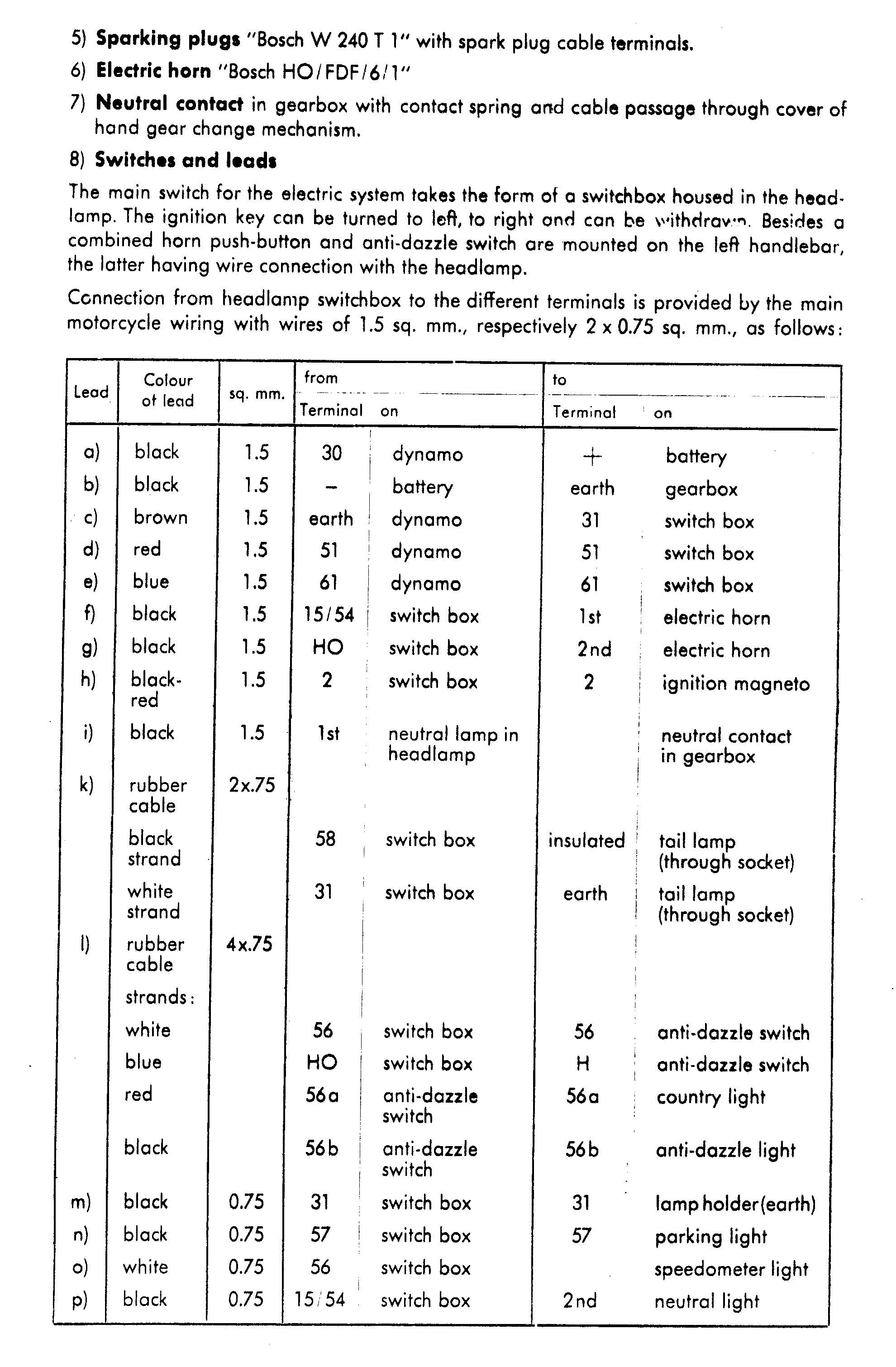

Postby DAVID THOMPSON » Sun Jul 31, 2011 1:23 pm
looked at the tail lamp in my rt125
31= ground
33=tail the dimer side of bulb
34= stop the brighter side of bulb
from an old book about 1953
is a list bit of a chore to read but its there
click on picture and print it for shop notes
this was in the file on my 1953 r51/3 bmw
