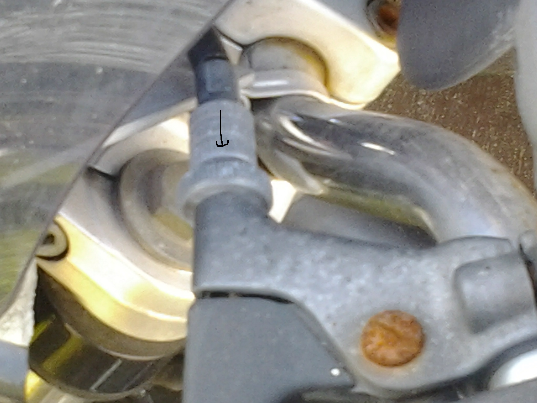

1 tighten up adjuster nut at handlebar
so cable has full slack

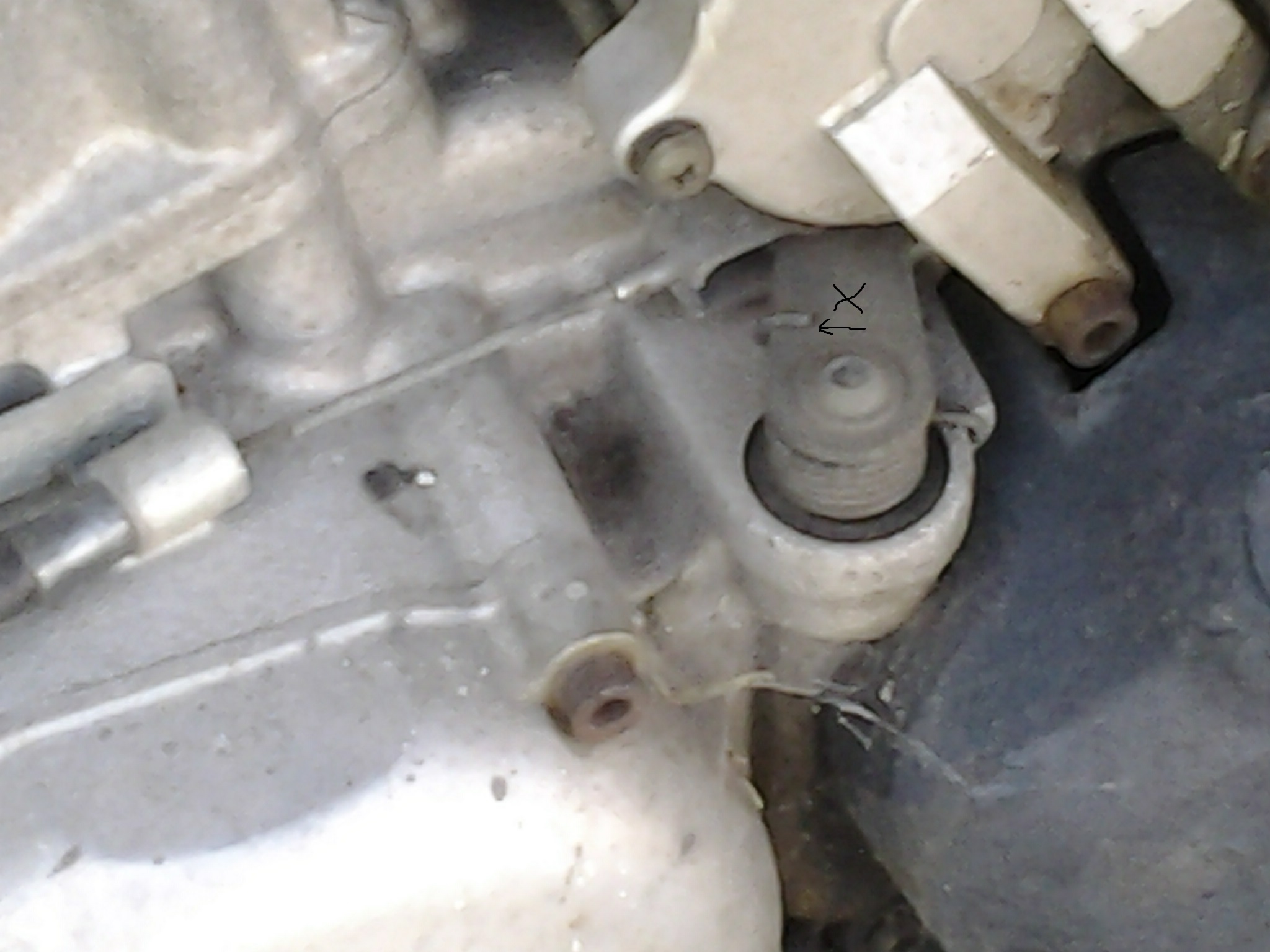

pic 2 install cable at transmission may have to twist lever there toward front of bike
if it will not go on check cable routing

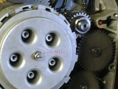

3 shows inside adjustment be careful about the spring and ball bearing in the spot marked on picture
in red
it is the OIL PRESSURE REG
