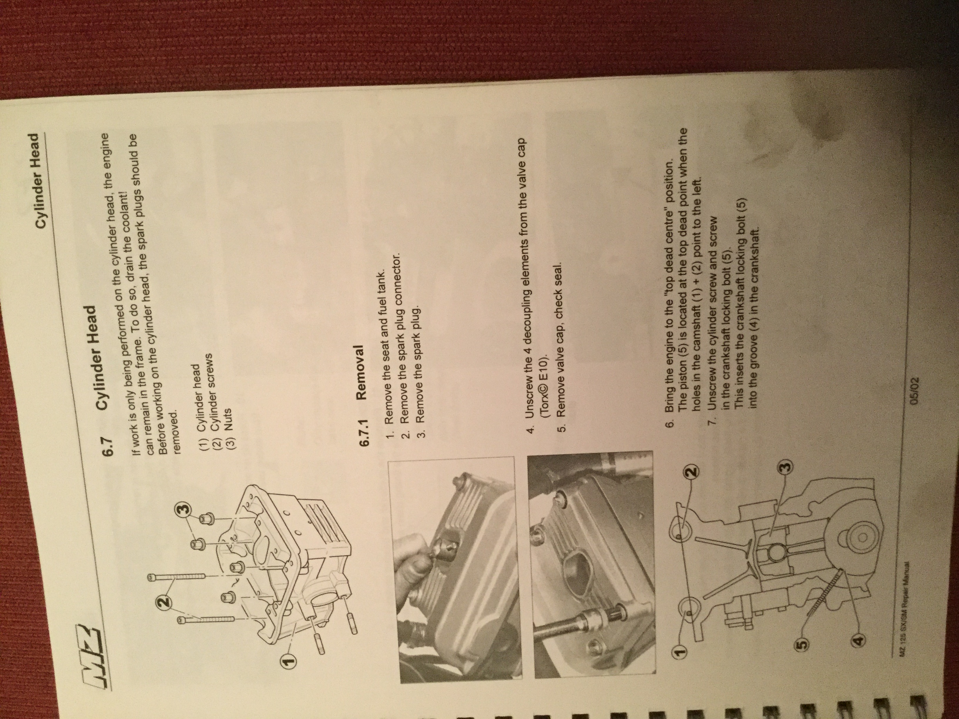

Hello fellow MZ riders i am in the process of removing the head off my sm125, if anyone could go over on how it would be done correctly i would appreciate it thank you and good luck. -Joshua

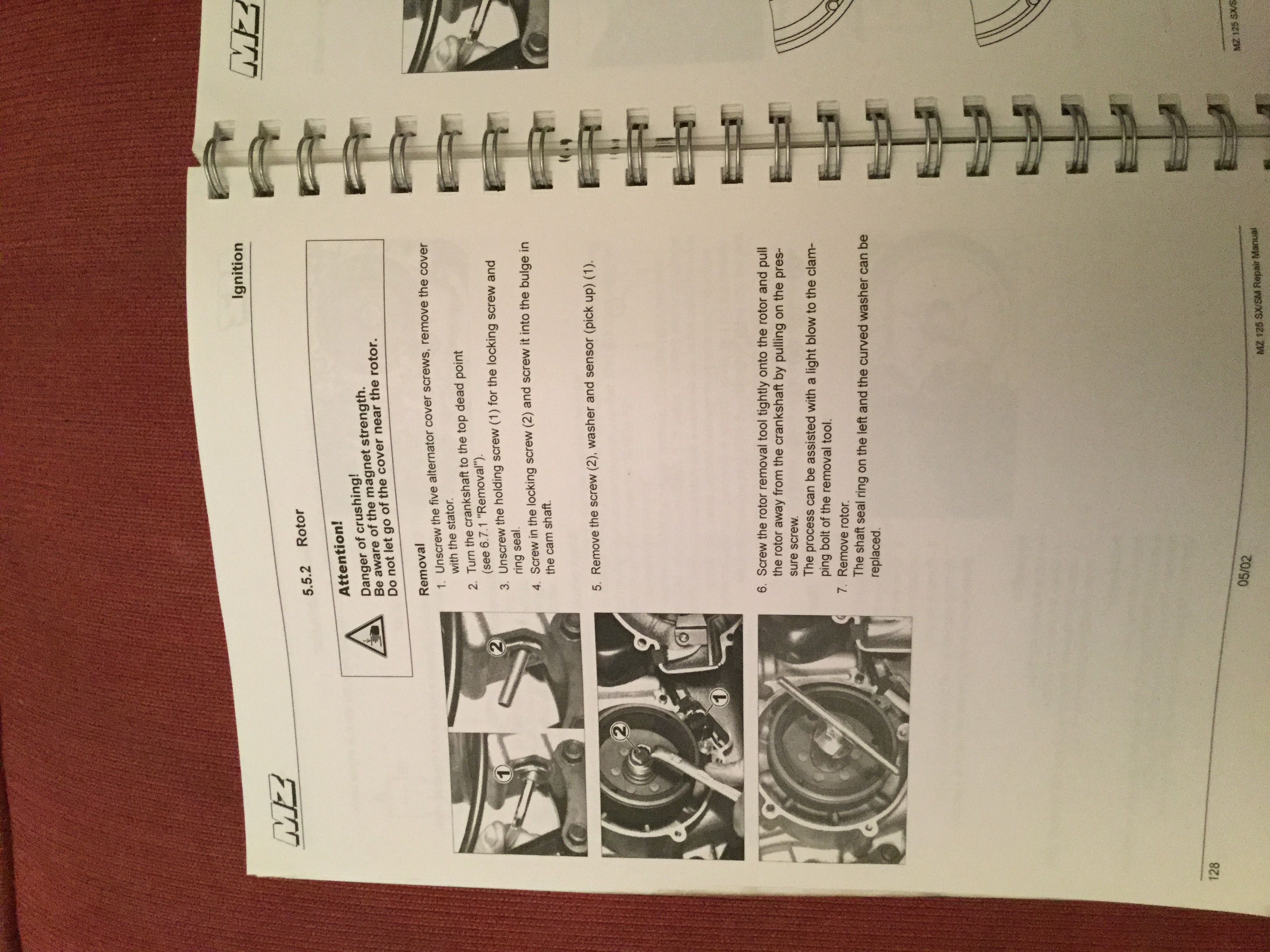

Hello, im currently trying to put in top dead center and then loosen the timing chain.

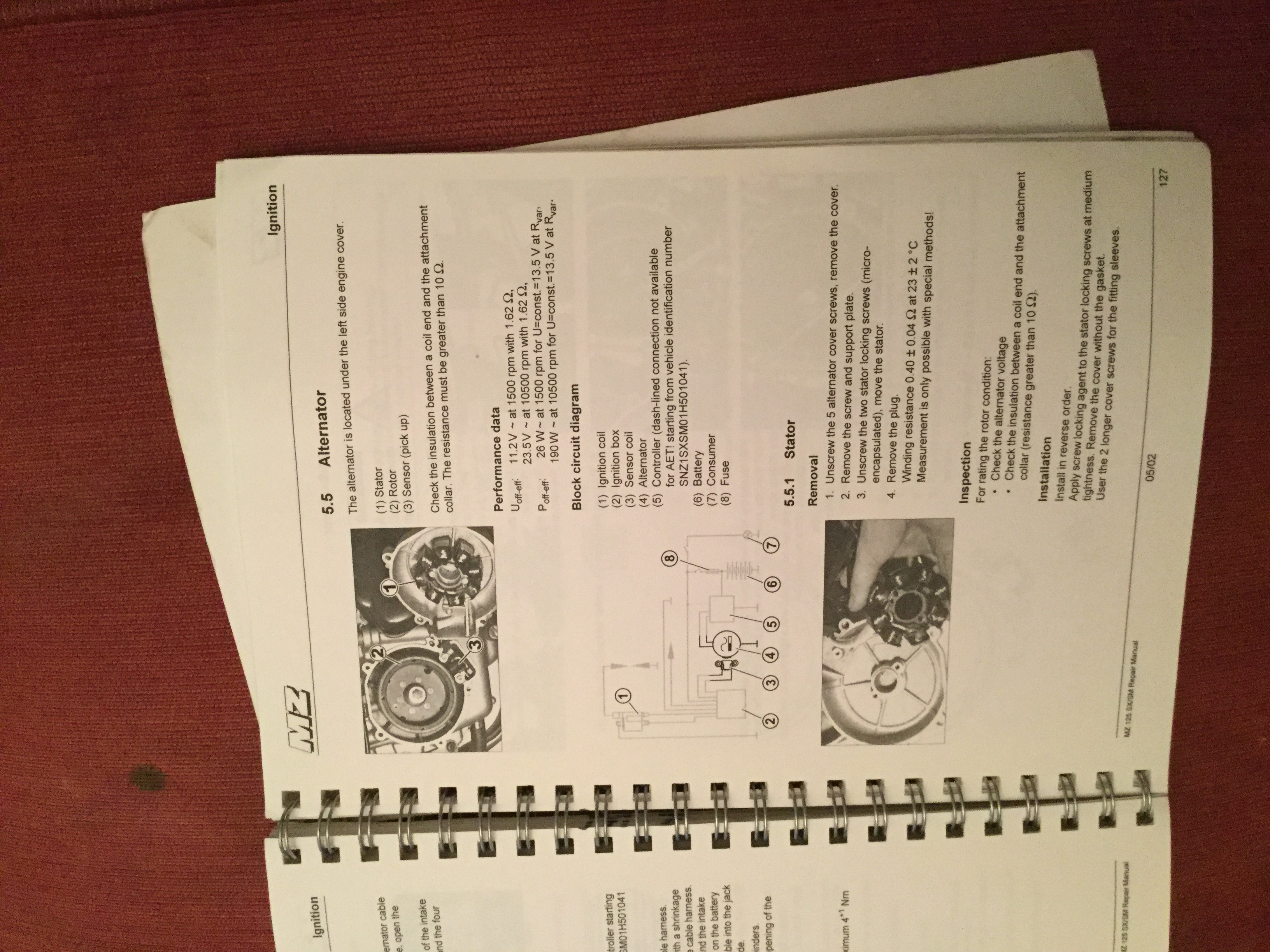

I will take pictures of what you want
