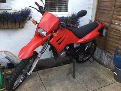

Postby DougieL » Fri Jul 08, 2016 12:36 pm
Thought I'd throw a picture up just as a legend lives on
Last edited by DAVID THOMPSON on Fri Jul 08, 2016 2:15 pm, edited 2 times in total.
Reason: picture was up side down

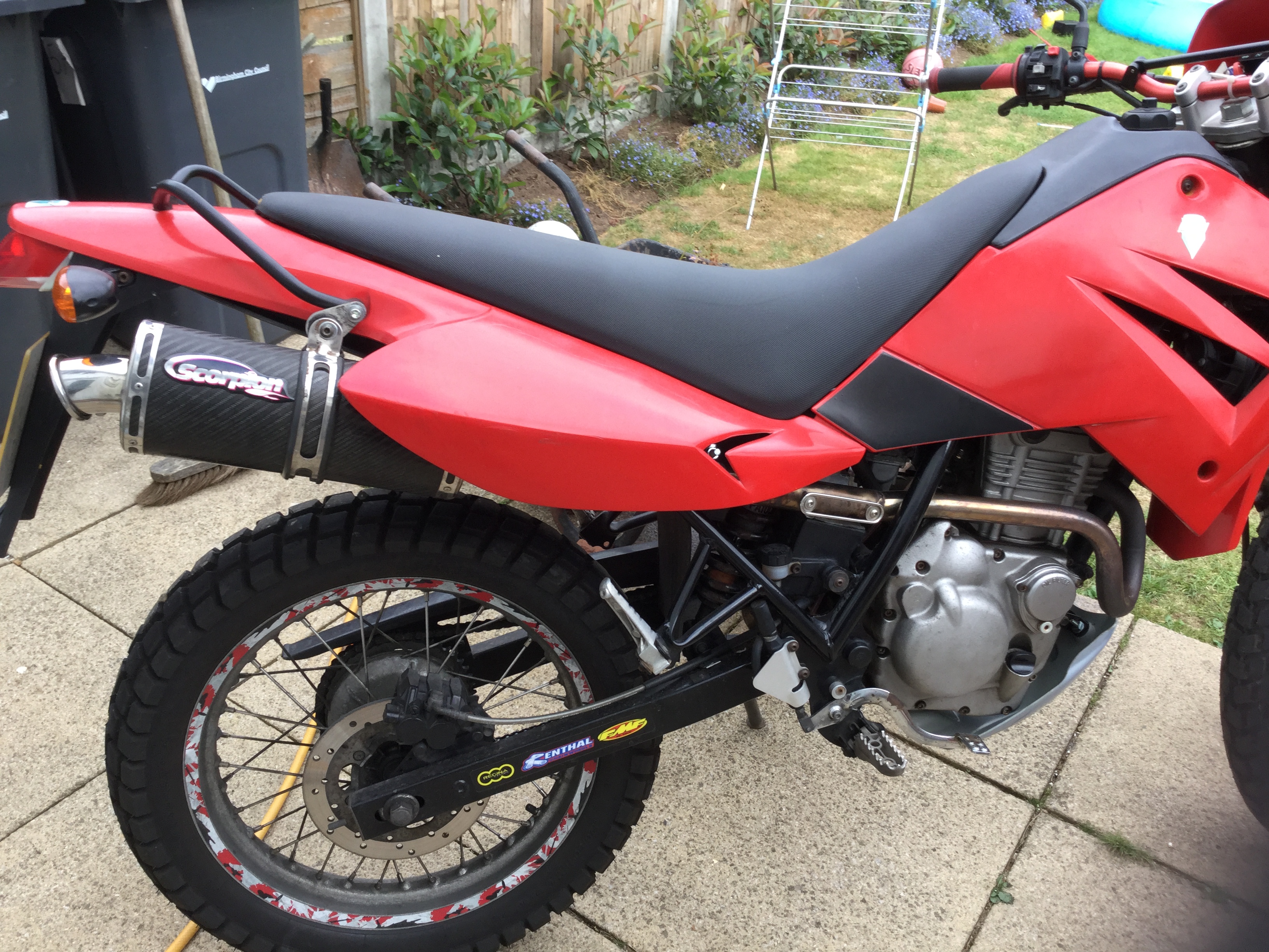

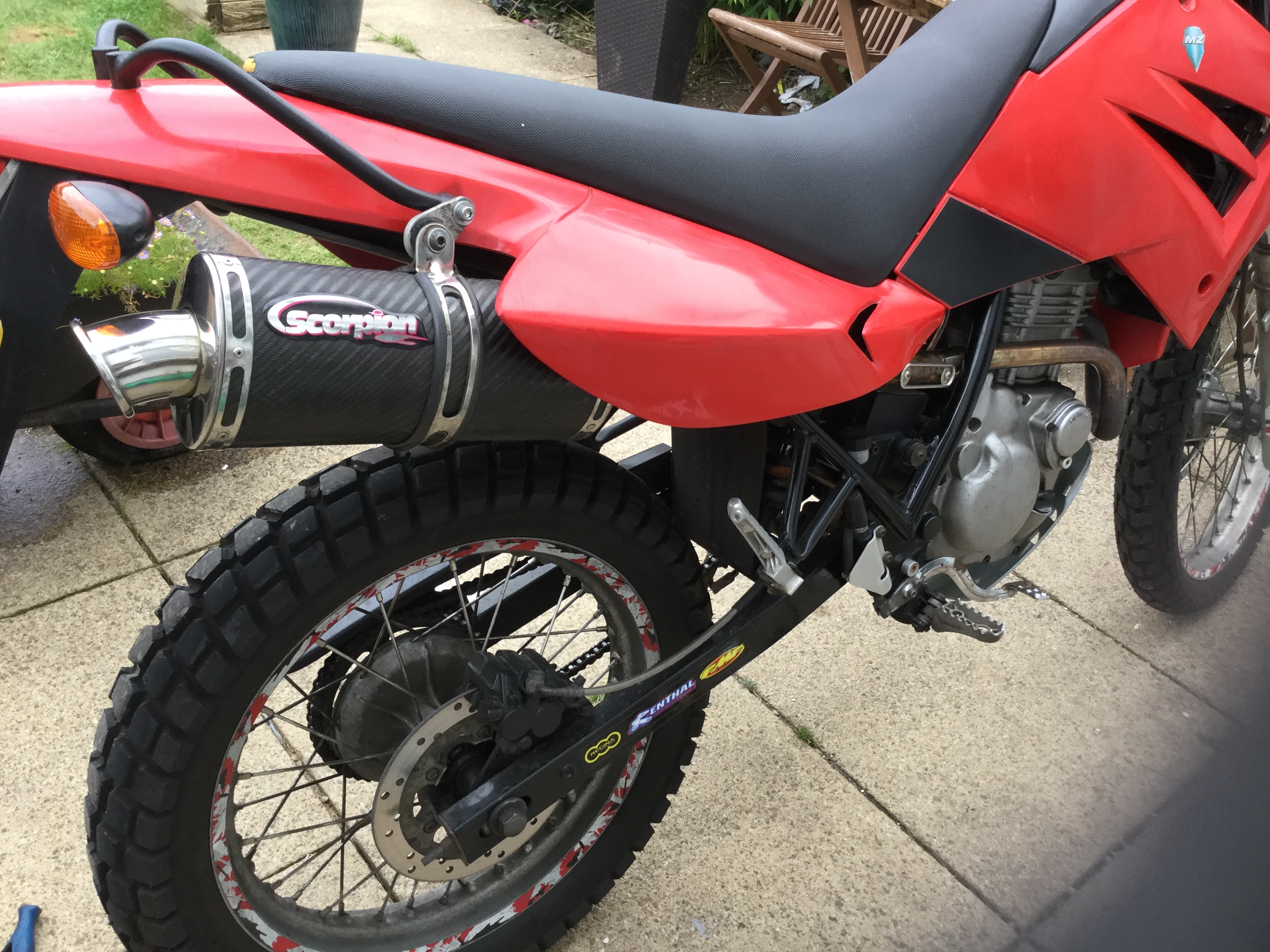

Postby DougieL » Sun Aug 14, 2016 1:02 pm
Went for it Saturday sun was shining again got hold of some washers an exhaust clamp and fitted scorpion back box ,adapted second stage from an original exhaust ,fired it up and it roared .Decided to have a street run on it and surprisingly
It was fine ,I noticed the exhaust was running hotter than the original and boy it was louder even with the baffler in.abit too loud for me I think totally different sound ,tone than the original it felt like I had more grunt but I think I might of been more aggressive not sure sounds like a total dirt bike now ,also fitted sump guard
