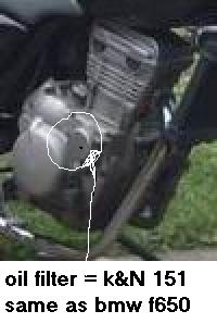

Postby DAVID THOMPSON » Tue Jun 14, 2005 5:00 pm
oilfilter info this link
http://www.mzriders.com/viewtopic.php?t=524
the filter is k&n 151 tell your parts guy same as f 650 bmw
and marshall parts cass city mich. has them and much cheaper than bmw
:-D
oil filter location
oil filter 125cc.jpg (11.54 KiB) Viewed 4457 times
Re: oil filter location
Postby witttom » Tue Jun 14, 2005 6:19 pm
DAVID THOMPSON wrote:oilfilter info this link
:-D
Awesome! Thanks! That opens up a whole world of possibilities.
