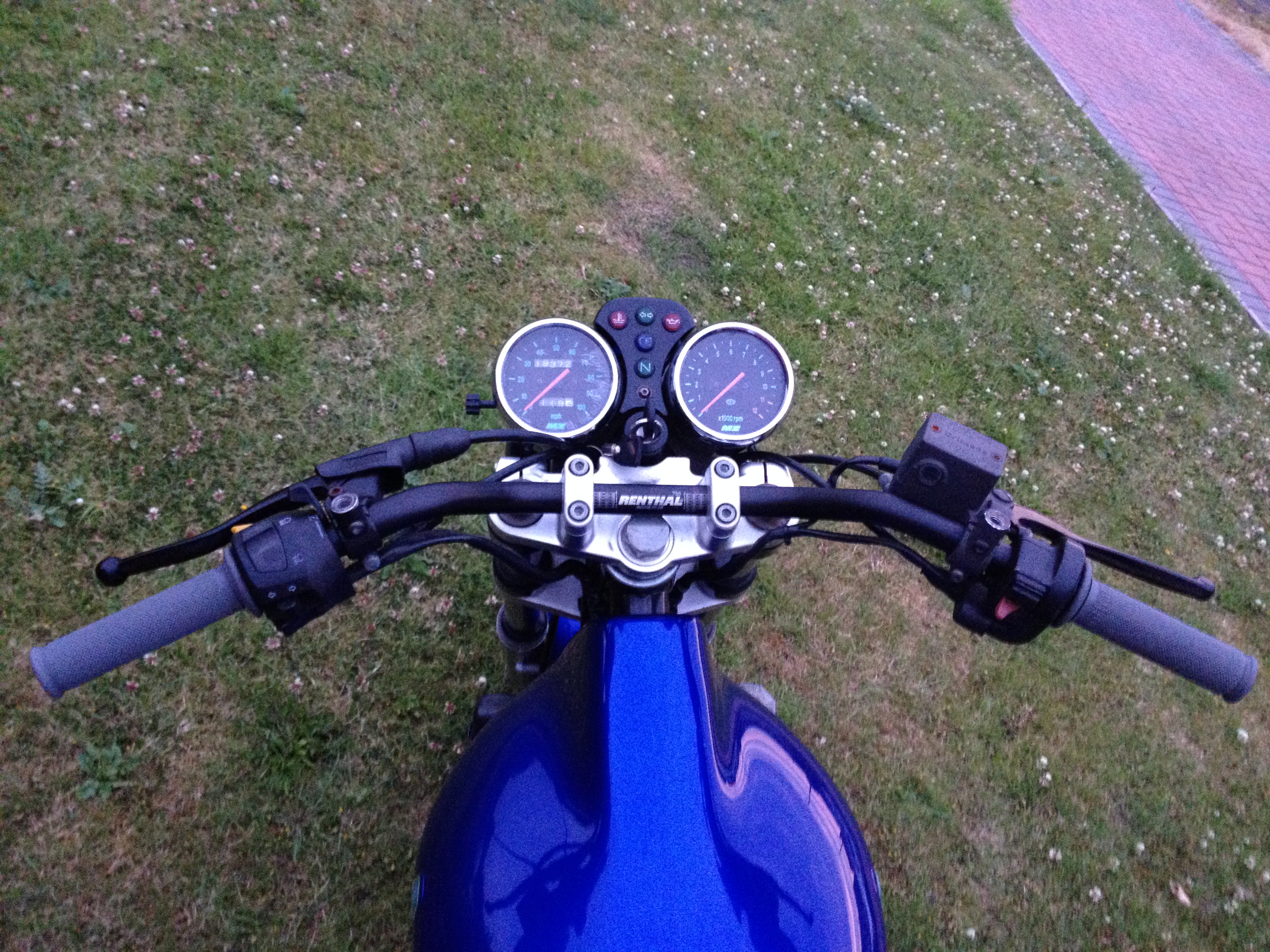

Postby XCalsteRX » Sun Jul 06, 2014 6:01 pm
Hello,
I've ordered myself some Renthal 755 handlebars and waiting for them to be delivered. Once I have them fitted I'll let you know how they are and upload a picture to, unfortunately I was involved in a motorcycle accident last weekend and bike got a bit scrapped up as well as myself now in crutches, so I'm now taking the opportunity to do her up a bit. Also I'm afraid that's how my bars bent otherwise I'd give them you.
May open a topic updating everyone on how its going. And maybe put a video up youtube
XCalsteRX
Posts: 13
Joined: Thu Dec 26, 2013 4:49 pm
Re: RT handlebar woes
Postby XCalsteRX » Sat Jul 12, 2014 5:24 pm
Hello, I've now fitted my Renthal 755's and they fit great, they are slightly wider at 28 Inch's but that's cut down from the original size but I prefer the wider feel and also there is still enough play in the cables just make sure they are all wired correctly and nothing will tug when turning the bars side to side.
Hope this helps and if you need anything else just ask. Picture attached of what my handlebars look like now, also they are a lot, lot lighter.
Postby DAVID THOMPSON » Sat Jul 12, 2014 6:14 pm
hope your going to replace the mirrors.
where i live cars travel just a fraction of an inch off your right or left ELBOW
at any speed from parked to faster than your bike will go...
Postby XCalsteRX » Sun Jul 13, 2014 6:04 pm
Hello David, don't worry the mirrors are back on..thought it was best taking a picture before refitting them to allow you to see more of the bars that's all. And I can believe it!
