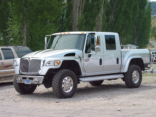

then someone passes you like your setting still in one of these trucks
