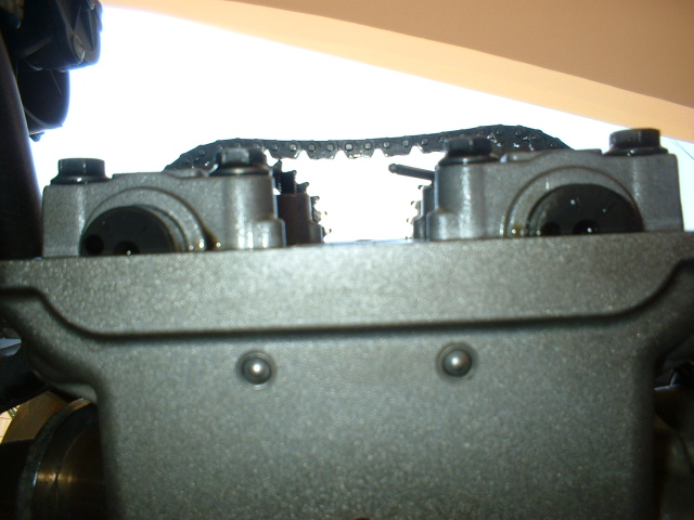

Postby bdalameda » Thu May 12, 2005 1:46 am
I would make sure that the 5mm locking bolt is ground down on the end so it can engage the crank TDC point properly. The MZ tool is hardened so that it cannot be sheared off if using to lock the engine. You will be looking at the end of the cams from the mag side of the engine. The forward hole in the cam (bottom edge of the hole should be even with the cam cover gasket surface when the cam is timed properly. The cams are held in place by only a friction lock by tightening the cam sprocket center bolts. When you remove these bolts make sure to clean the threads very well both on the bolt and internal cam threads, use contact cleaner or alchohol. Use only blue threadlocking loctite on the cam sprocket bolts when re installing them, never use the red or you will never get the bolts out again. The engine will actually run better if you time the intake cam forward so that the hole in the cam is about 50% covered by the gasket surface. the engine will pull top gear better and have a more even powerband. Make sure you remove the cam chain tensioner if you are removing the cam sprockets. After making the adjustments to the cam timing remove the crank lock bolt and turn the engine over a couple of times and recheck the timing.

here are the werx that i did...
fisrt of all i just pop open the head cover...
then...[/img]

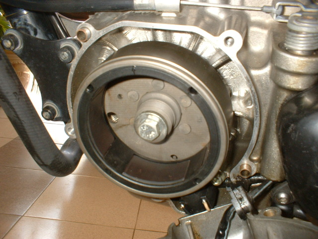

Open the magnet coil cover

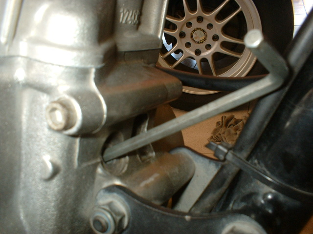

Postby jbthumper » Sat May 28, 2005 5:47 am
Then,unscrew the allen plug in front with number6...
pop in number5 allen

Postby jbthumper » Sat May 28, 2005 5:51 am
with pushing the number5 allen in,rotate the magnet(PIC 1) until the number5 drops a bit deeper in the crank...you will feel the restriction on the magnet...this is the TDC position

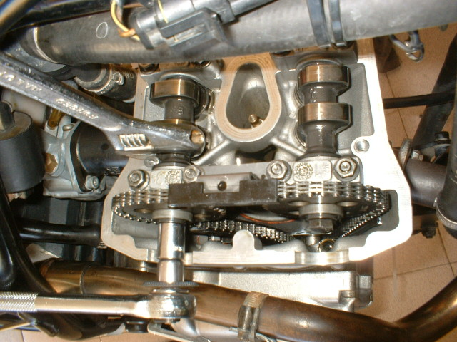

Postby jbthumper » Sat May 28, 2005 6:03 am
loosen the cam sprocket like so...
(do on both cams if you need to set both)
jbthumper
