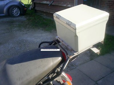

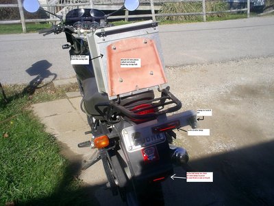

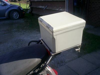

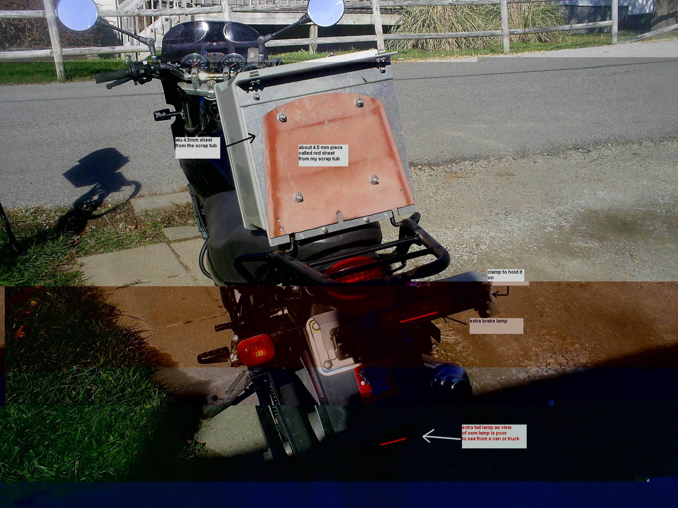

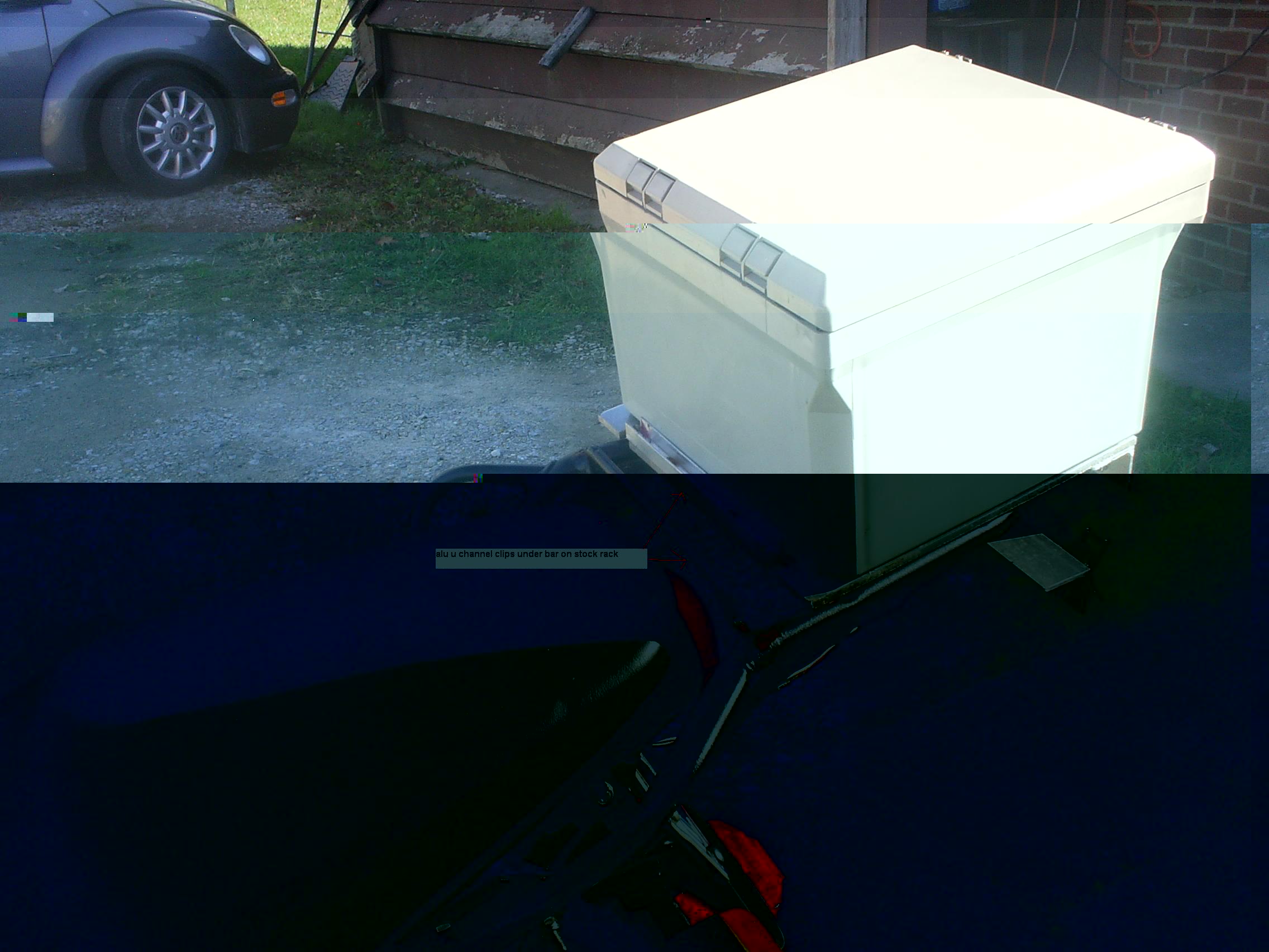

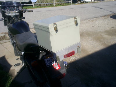

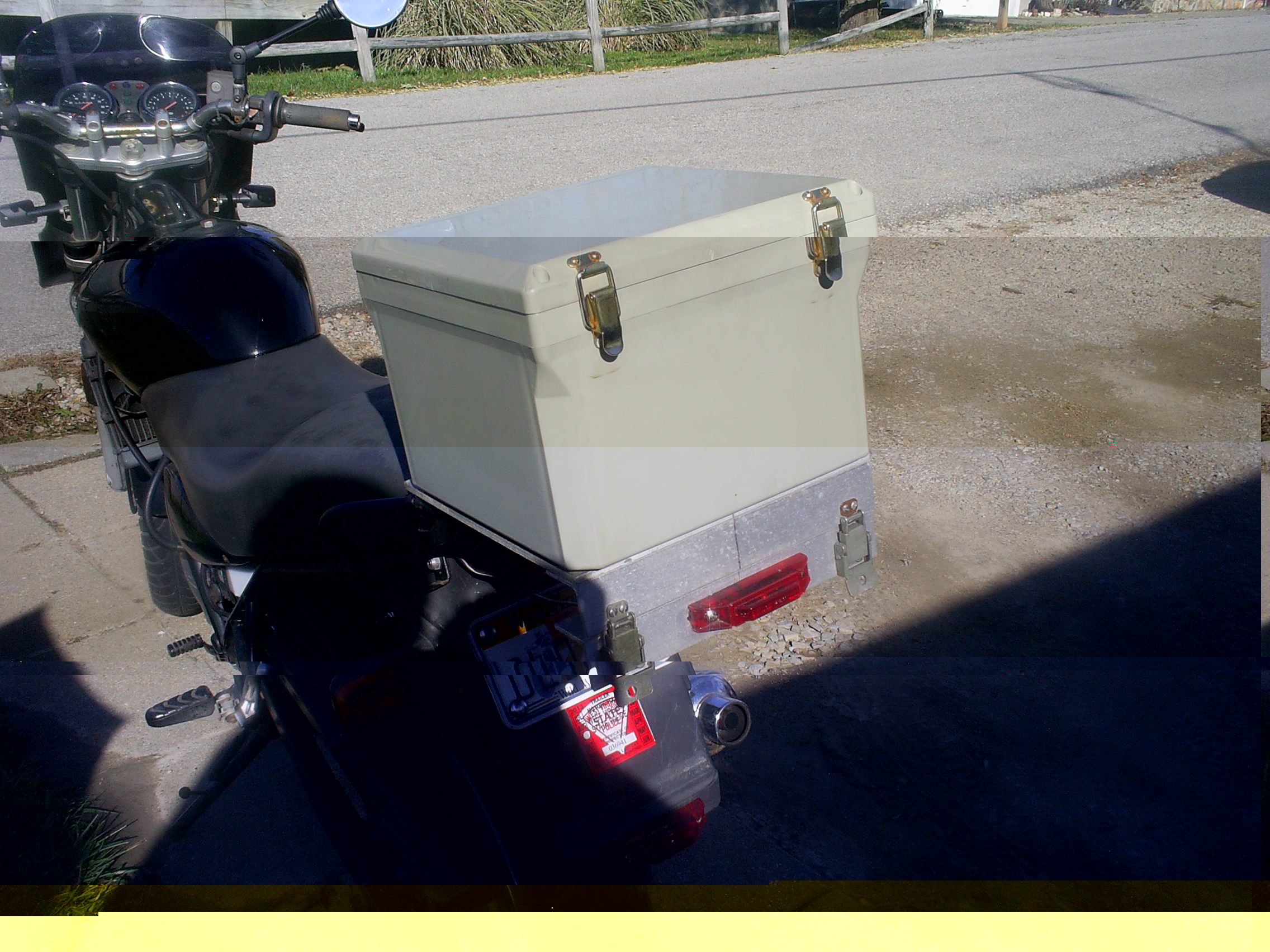

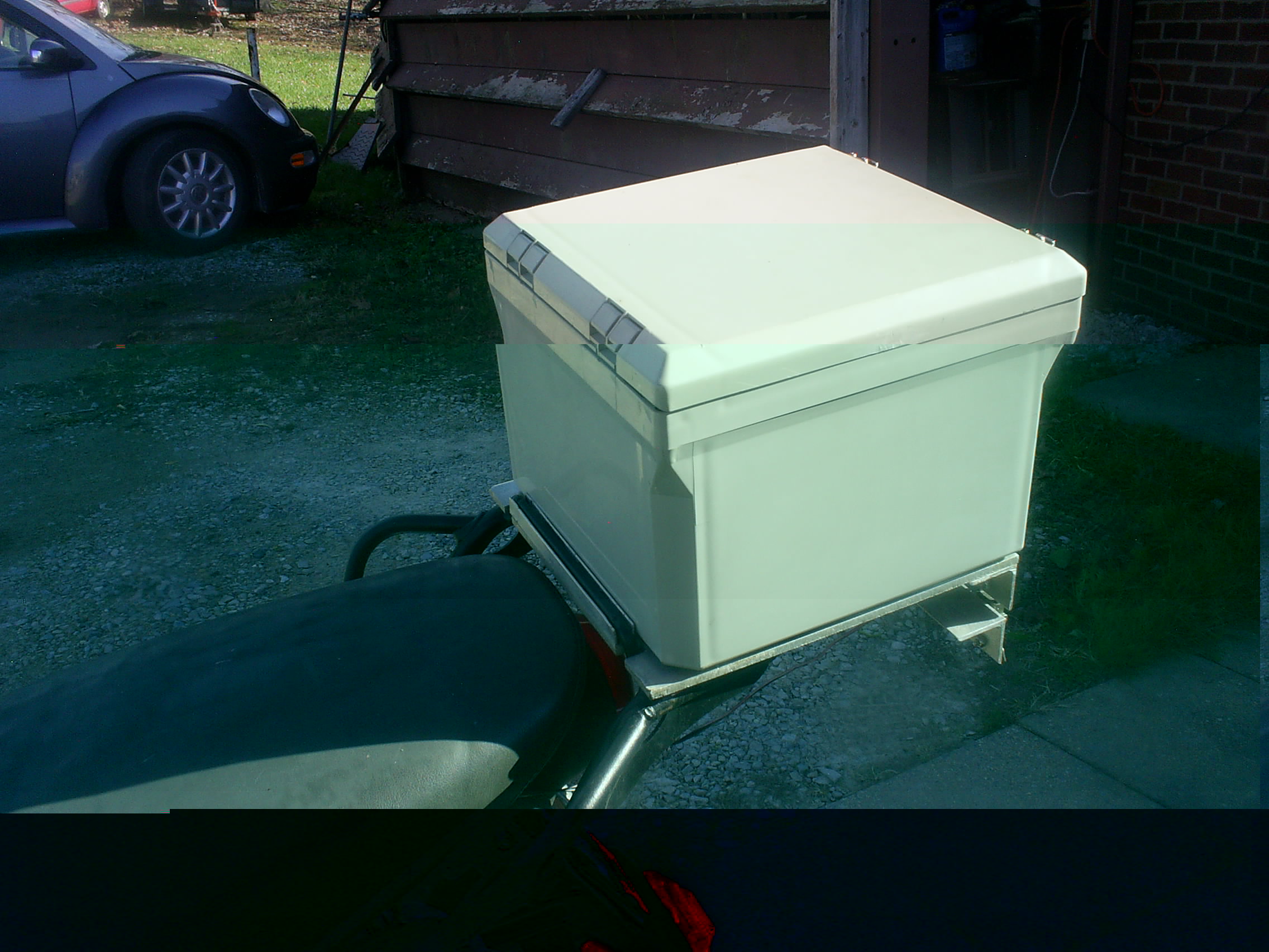

HERE IT IS USING A VERY RARE IN THE USA OEM RACK FROM MZ
it is a plastic electrical pannel box for out side use
i have also used an old portable typewriter case as the box
every thing to do this job came out of the junk bin in my shop
that junk box is very big and very full
and it supplies a lot of people with parts to make stuff from
picture loaded in reverse thanks to the way some thing works on the site
START AT BOTTOM PICTURE AND WORK BACK TO THE TOP
click on pictures for a big view and to read the lables in a bigger size
front latching detail
detached view
rear view
left side view

I have been looking for one of those racks in the UK but no luck. I think I will have to get the welder out and knock something up myself. Your pictures give a good design. Are they still available in the US?

the rack is original mz
the box and mounting is my work from things in the shop junk box
in the USA add on things for this bike were not imported
in fact i think this rack was supposed to go back to Germany
i do not know of any one but me with this rack in the USA
