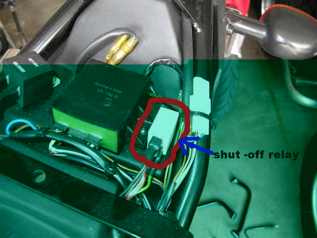

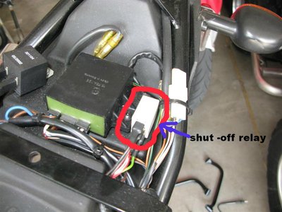

Postby 125supermoto » Wed Sep 12, 2012 7:09 am
found problem, shut-off relay attached to the rear wheel mud guard ( not the one in the front known as relay 19 )
Thank you for the help Dave.

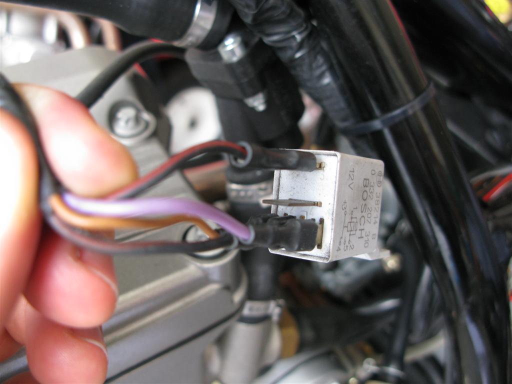

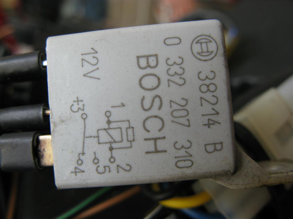

Postby 125supermoto » Wed Sep 12, 2012 8:03 pm

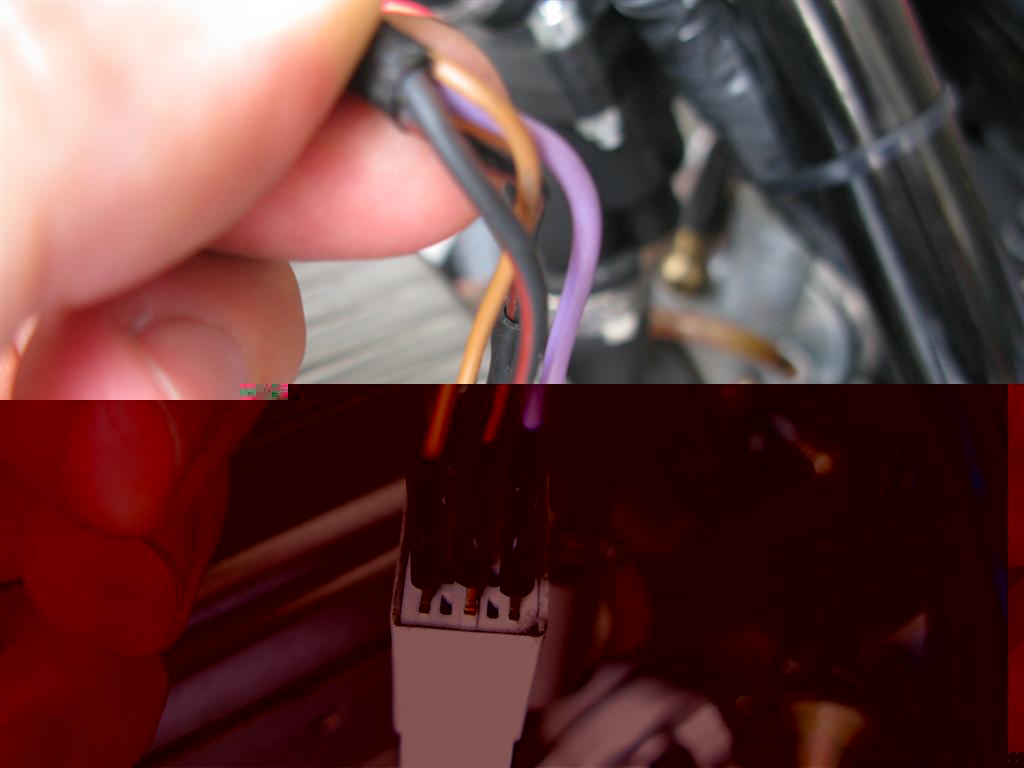

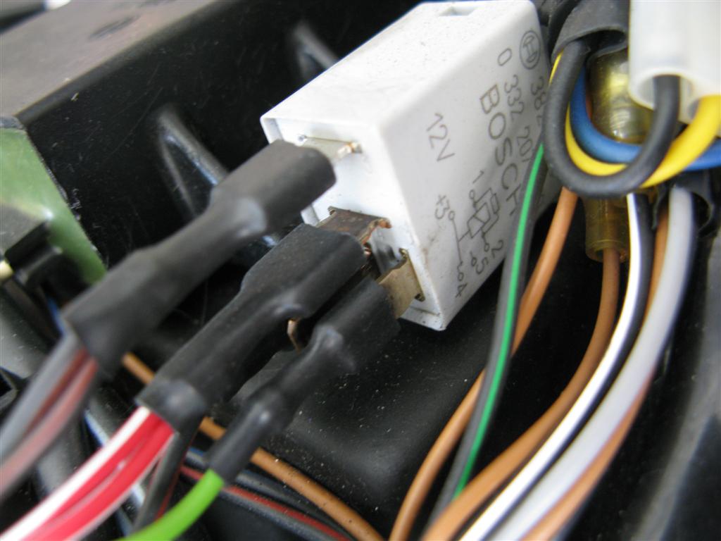

Dave, don't see it on the wiring diagram but here are some pictures of the shut-off relay on the rear of the bike on the
SM/SX model. I believe the RT does not have one in the back. don't know if it has it somewhere else. also found the diode 31 but that was not the problem. It has the same part number as relay 19

Re: 125 SM Won't Start
Postby DAVID THOMPSON » Wed Sep 12, 2012 9:02 pm
it appears to be the same relay wires all same color its just located in a different place
on the sm
on the rt its on the front side of the battery mounted to the frame
it controls most of the bike
red/black and red/white
make a spade lug that fits to the lug on relay where the green wire connects and hook to battery minus or ground
this is a good check if bike still runs bad its the relay if it runs ok then problem is in the kill button/side switch neutral lamp circuit
this is where i thought the problem was in the relay ... it is just located in a different
place on the bike...
i have never seen an sx or sm in person the dealer was out of stock when i got my RT125
now i know where to tell an sx/sm rider to look
NOTE there may be more wrong than this as what info i am thinking about from emails and posts
for this malfunction is not totally making sense sort of like 2plus2 equals 3.75 :smt021

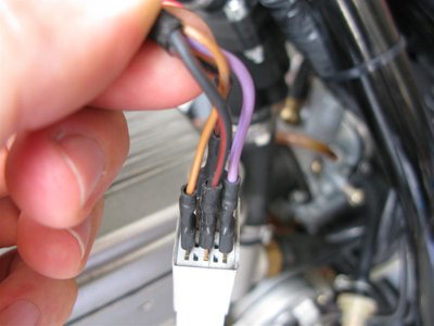

Postby 125supermoto » Thu Sep 13, 2012 4:44 pm
Dave, the SM/SX model have two identical relays one under the front top tube and the one in the back. I had one spare that I bought from grahams and replaced the one in the rear and problems solved. here are some pictures of the front one.
I was getting 12v readings in the front one when pressing start switch.

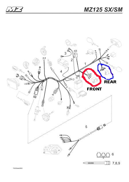

Postby 125supermoto » Thu Sep 13, 2012 5:13 pm
Dave, finally found a wiring diagram that shows both of them. Thank you for your help. Gus
