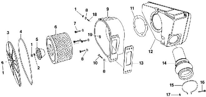

I got all the panels off, sissy bar etc, but I cant get the left panel off. I can see 3 screws holding the front part of the panel but I habent got any ideas of how to remove the whole thing. It seems to be housing what looks like an air filter.

Like Dave says above the screws to remove the nearside panel are deep inside the airbox. Here is a diagram that should help you to understand.
http://www.ost2rad.com/MZ-Spare-Parts/E ... ke-device/
The airbox itself (9) is bolted to the frame and is sealed with a gasket (13). The air for the engine travels through the frame itself (which acts as an air damper) and enters the air filter through the square cutout. So, this central section stays attached to the frame and you can detach the left hand panel by unscrewing about 4 screws (where gasket 11 is located) that are INSIDE the airbox BEHIND where the filter sits.
Hope this makes it a bit clearer. It's quite a while since I completely stripped down (to bare frame) my ETZ251 but it all came flooding back to me.

Postby DAVID THOMPSON » Sun Jul 01, 2012 8:38 am
i think this is what he wanted to post
the link did not post it for me
i had to hunt for it
make this bigger by clicking on picture
may not be for your bike but gives an idea of how it all fits

Thanks guys. Looking at the diagram it looks very similar to the 125 so ill have a go at taking it off with the help of this diagram.
