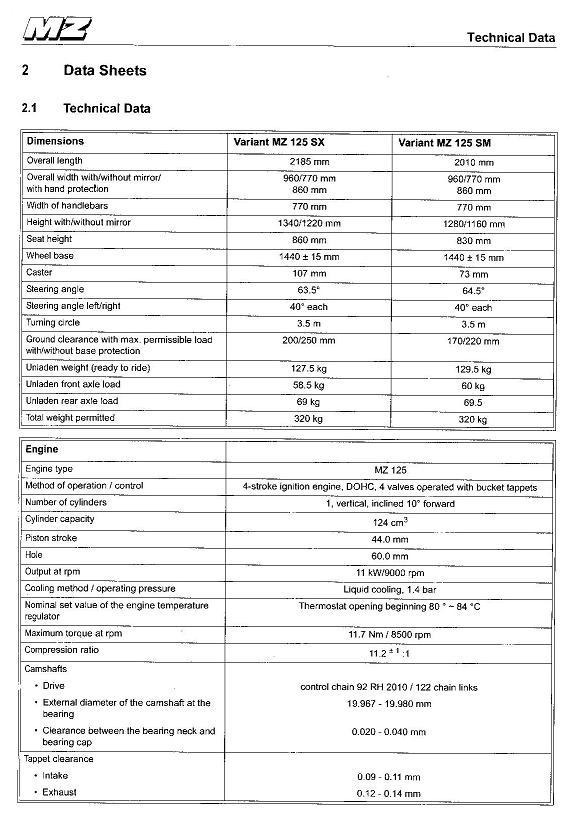

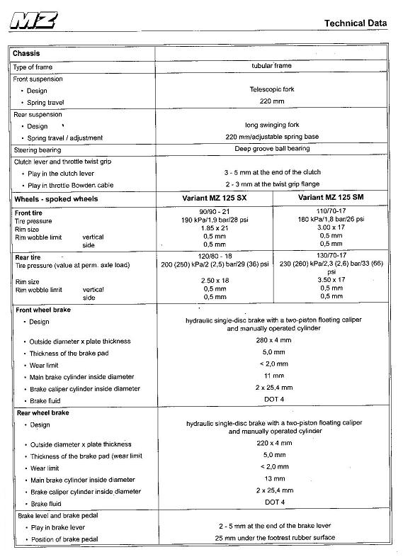

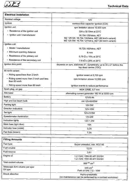

Check out these details got it from the manual. Good for new riders or for them who plan to have one of these MZ bikes.
mz technical data 001.jpg (294.37 KiB) Viewed 3758 times
mz technical data 002.jpg (80.48 KiB) Viewed 3756 times
mz technical data.jpg (87.34 KiB) Viewed 3757 times

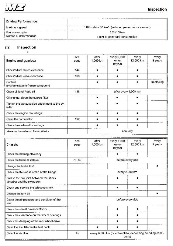

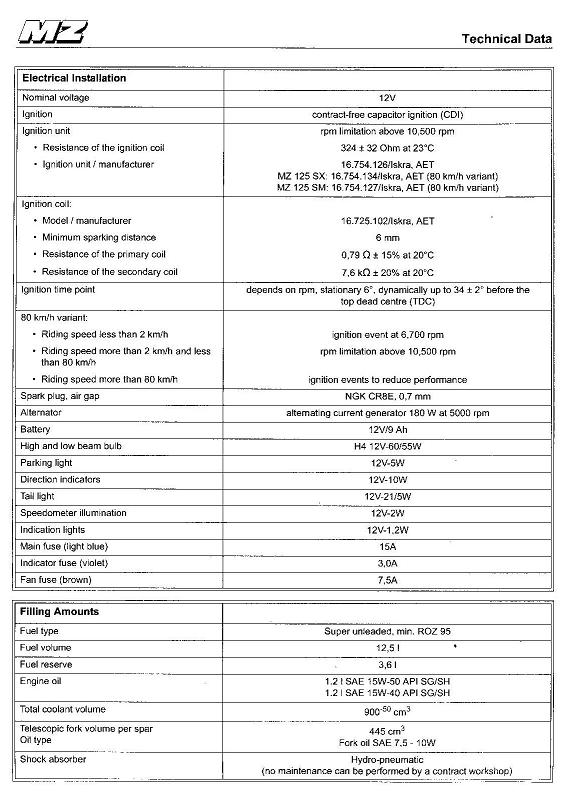

some more info
mz technical data 003.jpg (89.99 KiB) Viewed 3755 times
mz technical data 004.jpg (93.17 KiB) Viewed 3754 times
mz technical data 005.jpg (273.08 KiB) Viewed 3753 times

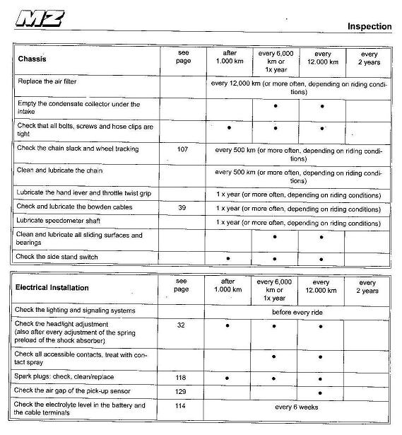

last one
mz technical data 006.jpg (286.64 KiB) Viewed 3755 times
