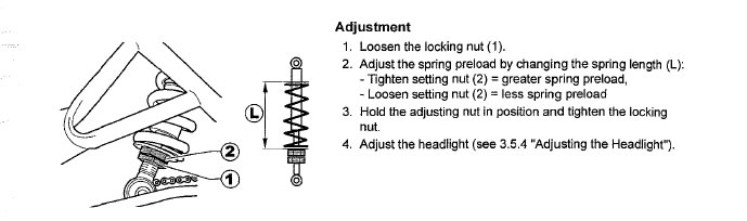

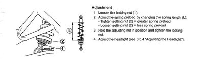

how do i raise the overall/seat height of the bike, a couple year ago i had it lowered... now that i have grown a bit thought it might be worth raising it, how do i go about doing this?

Think i have found the answer to my question is this the right way?
