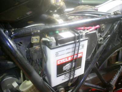

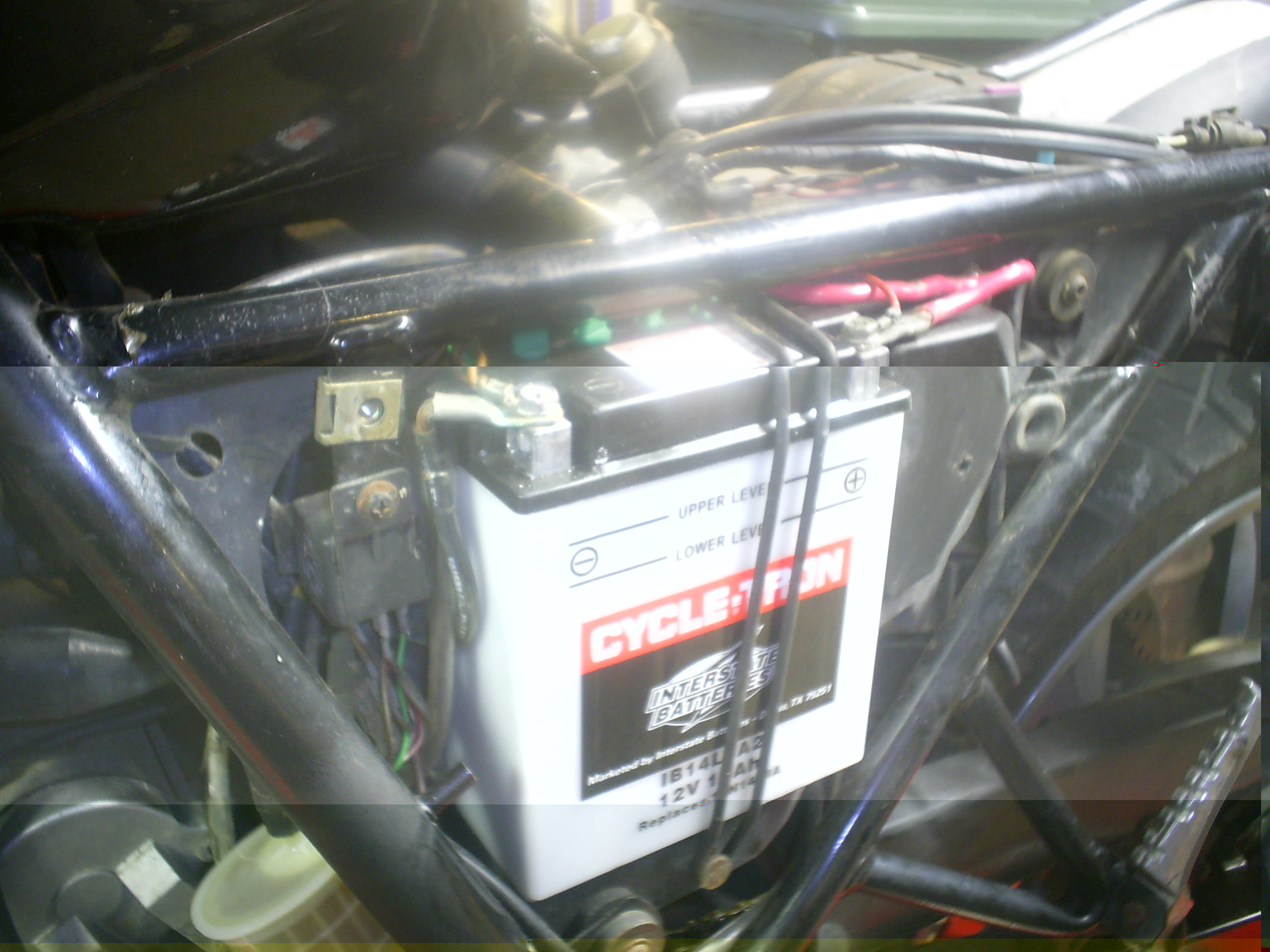

i moved wires over battery and shoved in a yb14l-a2
measure before buying battery may be different than mine
i think it was same as was on my saxon tour
had to clear wires from top of battery area to get it to fit and
battery has to be removed to check water levels
also cover has to be cut away to let cover fit back in place
but does not show when seat is in place
i think there is a gel battery the same size
it has been starting good and head lamp is bright now not a yellow color
bigbattery
click on pictures for big view as site crops them

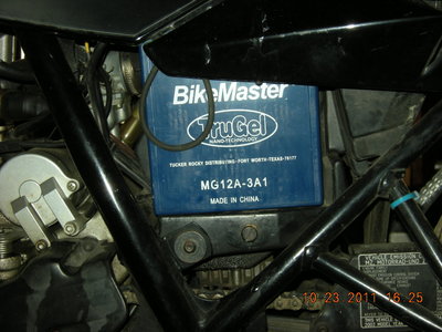

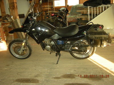

Have installed a Bikemaster TRUGEL battery #MG12A-3A1

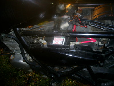

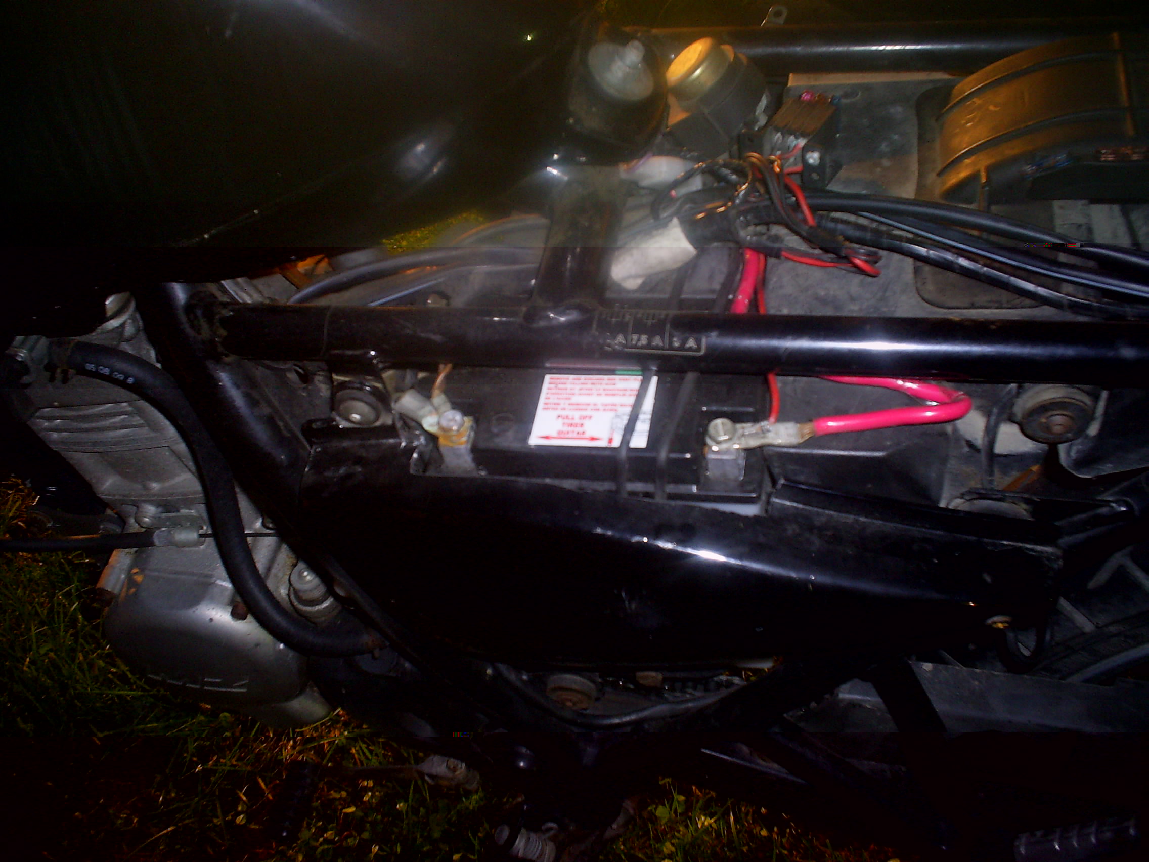

Postby DAVID THOMPSON » Sun Oct 23, 2011 6:02 pm
the one steve fit seems to be about the same as my wet cell
make sure the drain is in the correct place if its a wet cell
and the plus/minus posts are where they should be as
new big wires made of copper are very expensive any more
BikeMaster TruGel Battery MG12A-3A1, Part SYB14L-A2, SYB14L-B2, YB12AL-A, YB14L-B2, and YTX14AHL-BS.
