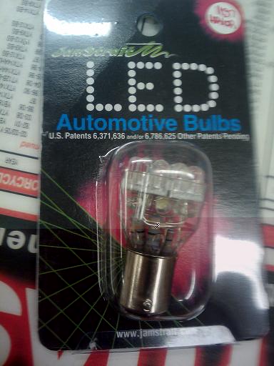

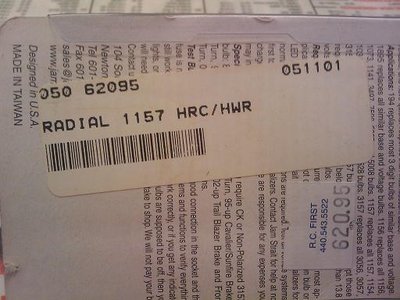

Postby OSPRNG » Fri Nov 27, 2009 11:31 pm
hey guys, just wanted to add my experience. 80$ was too much for a tail light in my opinion, so i held out.
today i was at a motorcycle mall in Belleville, NJ and saw a led tail light 1157 for 10$ so i grabbed it.
JamStrait LED RADIAL 1157 HRC/HWR
http://www.jamstrait.com
installation was a breeze, and the LED has both the straight LED red stop light and the 90 degree white light to eluminate the license plate.
strangely, in standard mode the red lights kick in, and when you hit the breaks the white lights add in -
basically the reverse of what youd expect.
but it works out because as you ride your license plate is dim but visible, and the riding light is more visible than normal (always a good thing with cagers imho) and when you hit the brakes it still gets brighter to make the difference.
either way, $10 beats paying 80$ plus postage! :D
