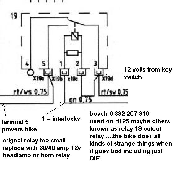

relay 19 (cutout relay)(relay 30 on 660 bikes)
part of side stand interlock wireing and supplys cdi box with power....
look close at this relay it is to small and it failed the other day on my rt125
i have been having funny tach readings most of the summer....
from time to time bike would not start with kick stand down..
then last Thursday it just died

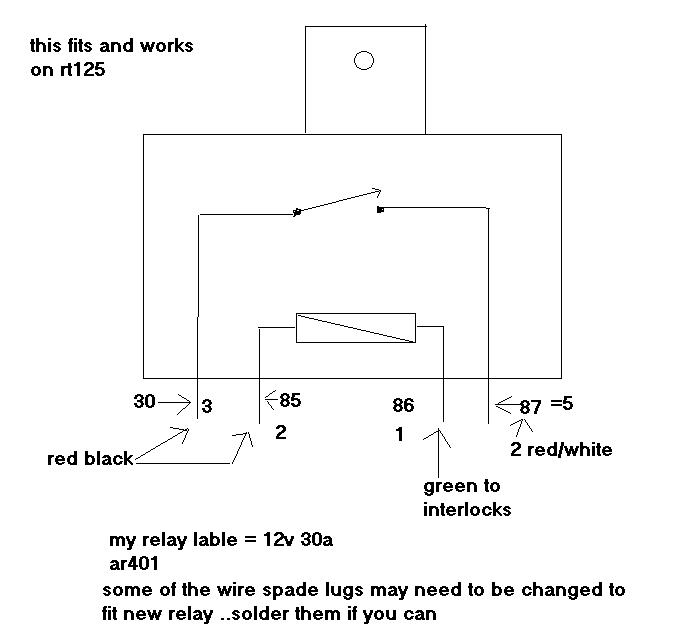

i jumped pin 3 to pin 5 and rode it home
replaced relay and have had no trouble for 6 days
on my rt125 the relay is mounted beside the battery and it is gray in color
the contacts carry a lot of current and supply's the cdi box on my rt125
so funny tach reading from funny voltage supply to cdi box ????
the little numbers are for original relay 1235 big 30 85 86 87 Europe
