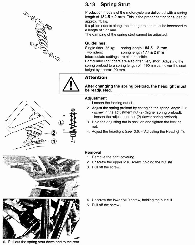

My 17 year old son has a 125 SM and is having prblems with the rear suspension. I think it needs a bit more preload.
He weights 15½ stone, 95.25Kgs or 210 pounds.

Postby DAVID THOMPSON » Sun Feb 25, 2007 6:28 pm
here is shop manual on the rt 125
hope this helps i weigh 220 lb and mine is still set to factory setting
search words rearshock rearspring
mz125cc shock.JPG (135.83 KiB) Viewed 3500 times

FWIW, mine's pretty much cranked up all the way (185 lbs w/o gear). I'll double-check that tomorrow. It was set up that way by a suspension specialist at the last trackday I went to.
Following that, Wilbers makes a rear shock assembly (I think the PN is 630-603-00), but that's probably in the ballpark of $600. Whatever the cost, it's more than I'm willing to spend :(

If your shock has been adjusted, could you measure the amount of thread showing please.
