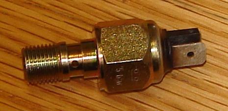

Postby TIME LORD » Tue Feb 27, 2007 7:58 am
I have got the switch for the sm but was woundering how to fit it I can unscrew it but how do i get the brake line off with the ring.
Please see picture
picture of switch
MZ Rear Brake Switch.JPG (19.71 KiB) Viewed 8494 times

Postby DAVID THOMPSON » Tue Feb 27, 2007 10:26 pm
on my rt the switch is also the bolt that holds the line on
remove switch and line comes loose then replace
and have a ton of fun getting it bleed of air after done yuk

Postby TIME LORD » Wed Feb 28, 2007 2:23 am
Thanks Dave,
So the the brass washer may be squashed to much and binding it up they must have over done it in the factory as i have never changed it before.
Thansks again Dave your a Star.
