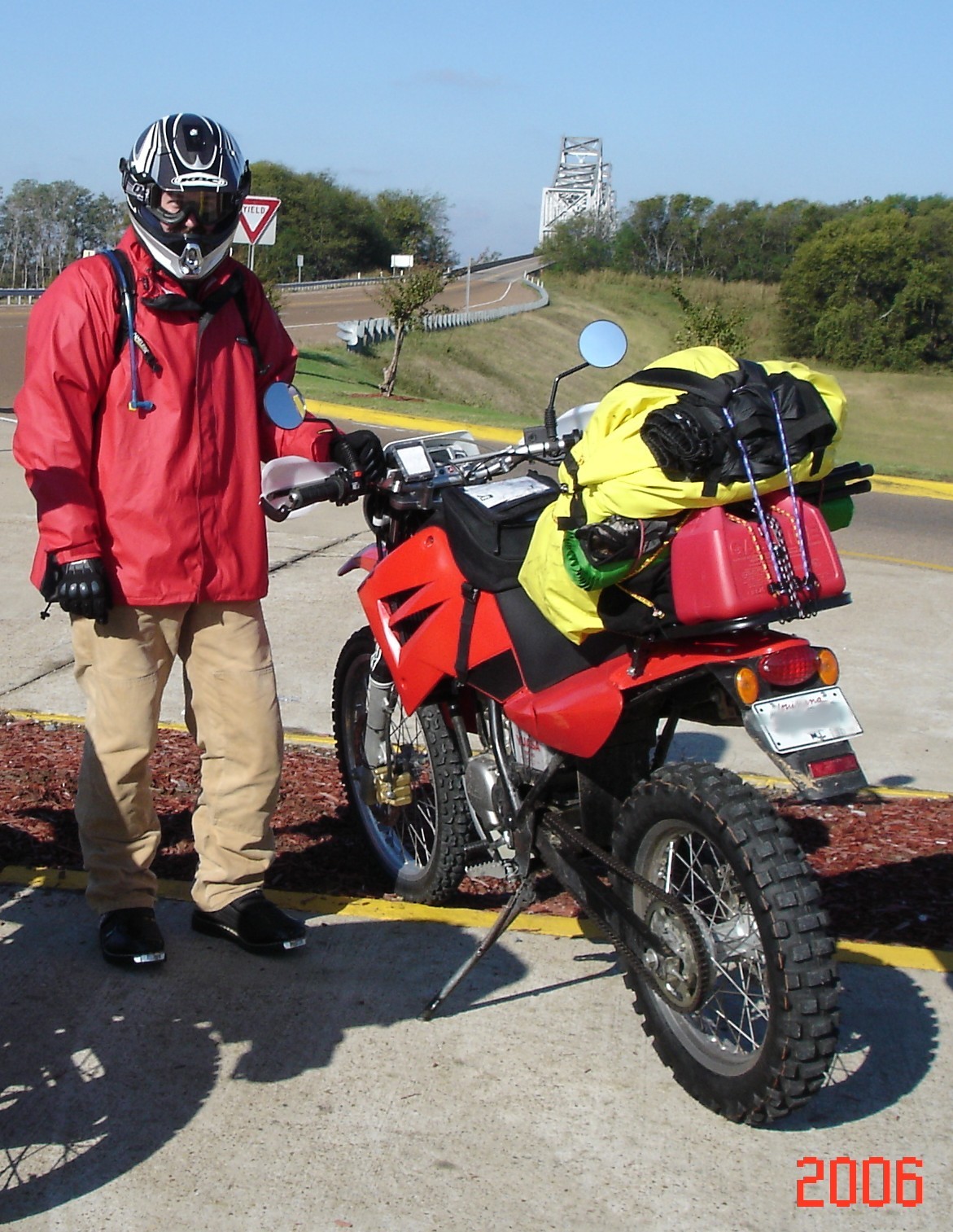

PROJECT COMPLETED!!!
Postby EvanMac » Mon Oct 23, 2006 7:43 pm
CHECK IT OUT... ME AND THE BIKE ABOUT TO START THE ARKANSAS TRANS-AMERICA TRAIL!!! I COMPLETED IT IN 14 HOURS AND 20 MINUTES OF RIDING OVER TWO DAYS! 435 MILES. THE MZ WAS PERFECT! :-D
