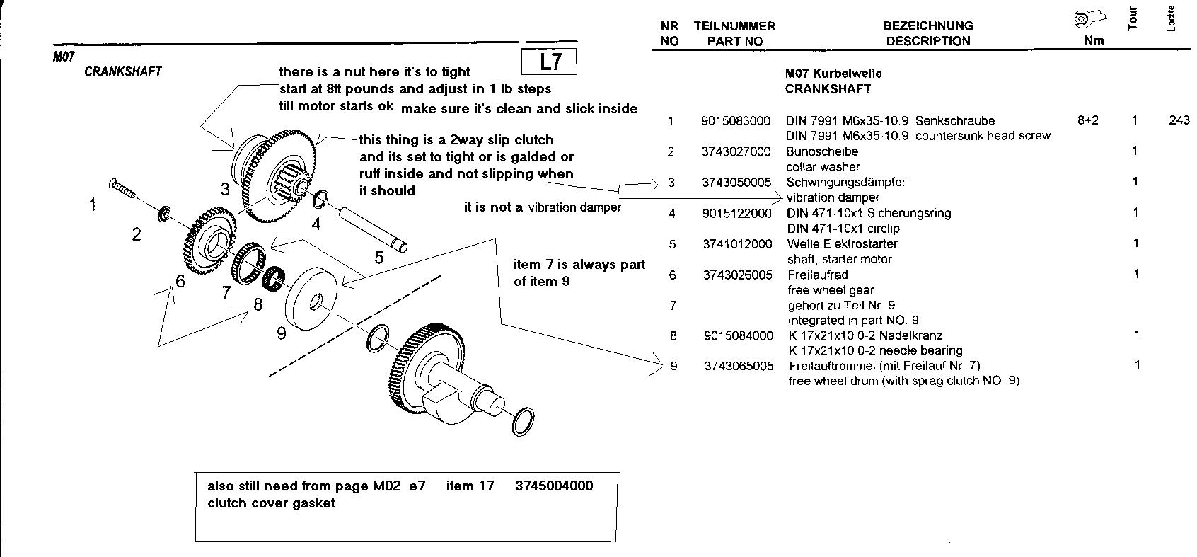

Postby DAVID THOMPSON » Thu Aug 04, 2005 5:37 pm
here is what i came up with after blowing mine twice
items 6 and 8 should be replaced also as any blemish on the grab face
of item 6 from a past failure can do a new one in
warning never remove item 7 from inside item 9 it will be destroyed
item 7 is part of item 9 from the factory
also dump a load of motor oil in the 7and 9 combo befor installing
item 6

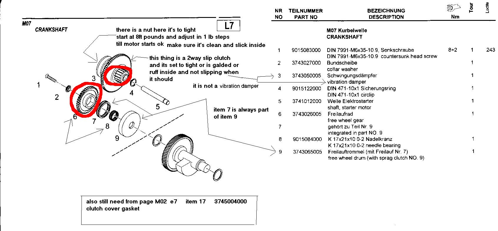

Postby sean18 » Sat Aug 06, 2005 5:25 am
hello i took my bike apart today and the free wheel is ok .but the two parts in red are not some of the teeth has snaped off both the free wheel gear and the 2 way slip gear so i'll have to wait until monday to findout how much it going to cost .

Postby DAVID THOMPSON » Sat Aug 06, 2005 10:30 am
yuk
go see phil at bsa but dig deep in your piggy bank
also clean engine and do a new oilfilter
