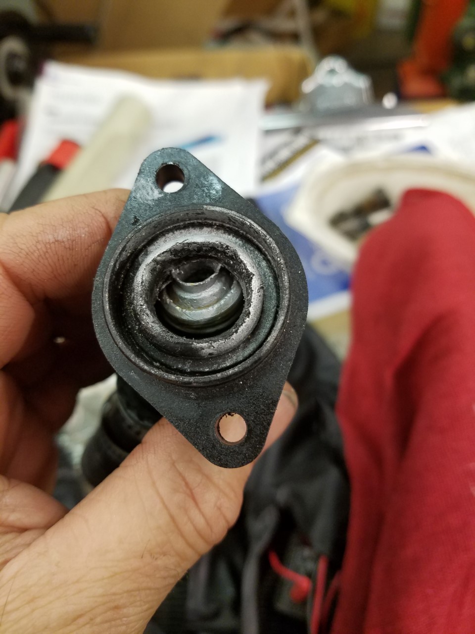

Postby 3rjmorel3 » Sat Oct 27, 2018 2:36 am
So I took the thermostat apart and this is what I see. Cocked valve from get go or cocked on purpose cause of over heating? Are they available ? cost? Any aftermarket ones I can get locally at motorcycle shop or auto parts store? thanks

Re: 2002 125 SM help
Postby stephendacosta » Sat Oct 27, 2018 1:04 pm
Gee, and after I told you that I have never had a thermostat problem!
I think I have one if you are in a HURRY. All you have to do is send me another to replace it.
Will message you my cell. ---Steve
Postby 3rjmorel3 » Sat Oct 27, 2018 5:25 pm
thanks Steve, lets hold off on it for now. Bigger fish to fry. I gutted the thermostat since it was ruined anyway and will just do without till I can get the head gasket to stop blowing. I just put it all back together and tried running it this morning, which it did till I noticed oil coming from between the head and cylinder.
I think this motor should have 6 to 8 head bolts instead of 4 to get a more even clamping pressure around the water jacket.
But then I read of others that have never had problems with theirs.
I'm thinking I didn't tighten the cylinder head nuts enough????
manual says 22 Nm (16 ft lbs) then tighten 80 degrees +10 ???? Does this mean to torque them all to 16 ft lbs then manually tighten them 80 degrees more which woud be just shy of 1/4 turn to stretch them?
Thanks, rob
