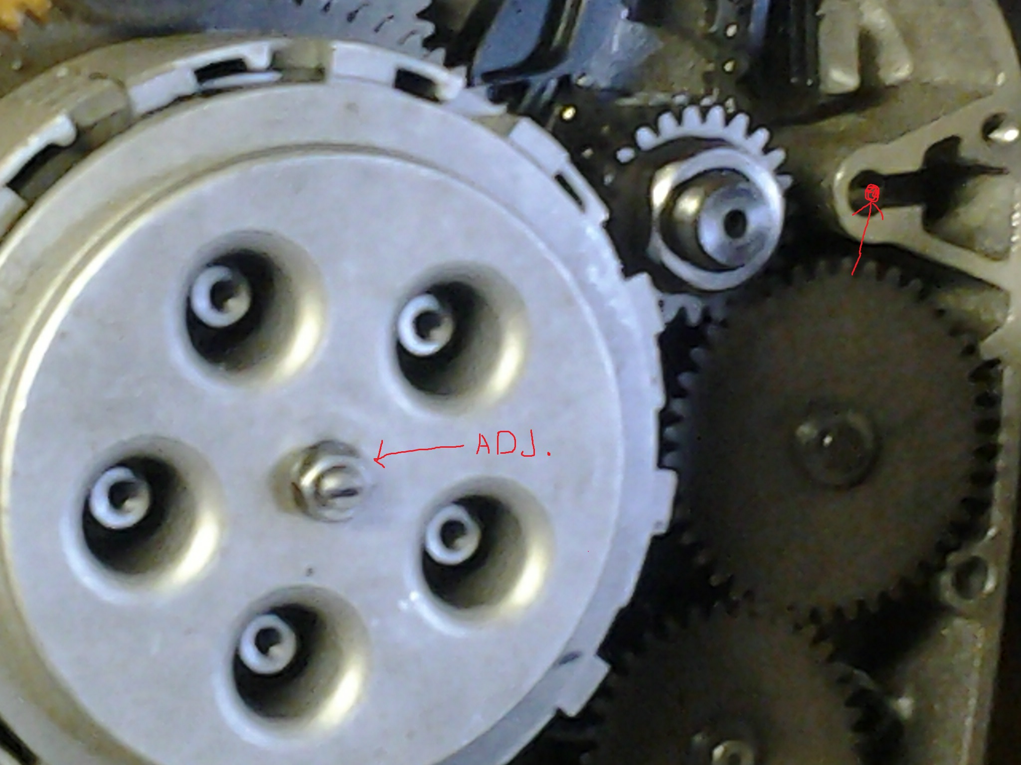

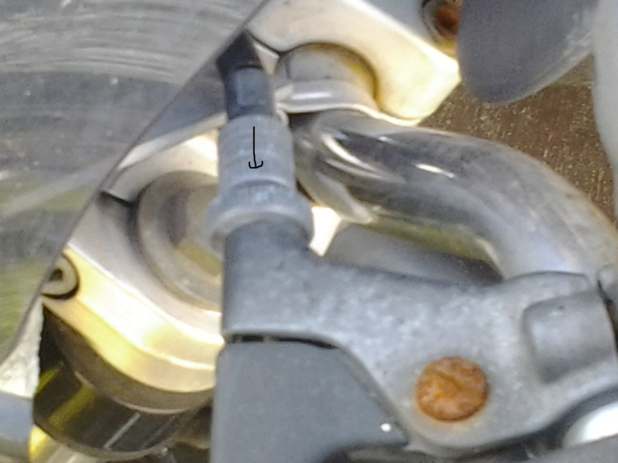

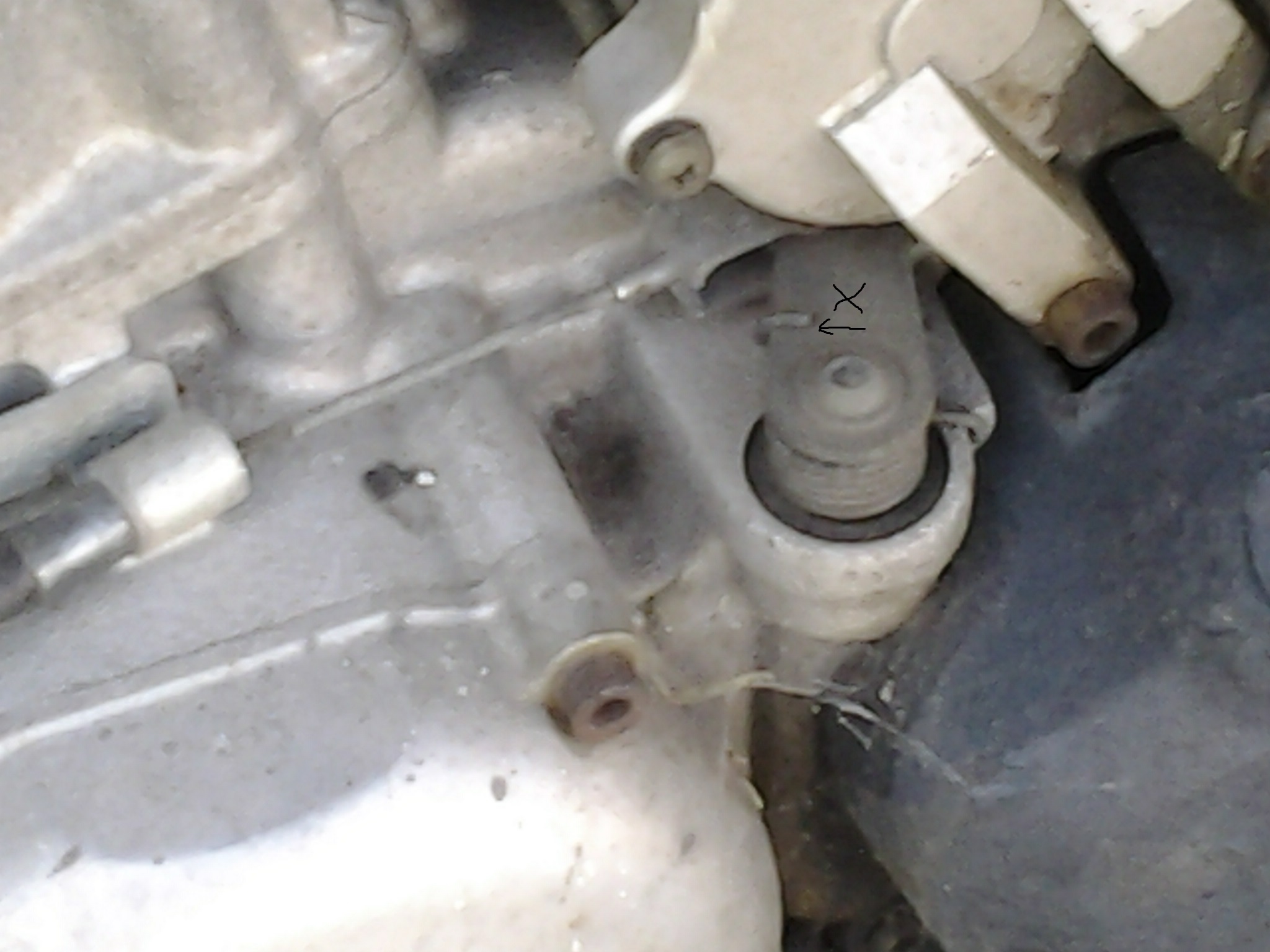

Postby DAVID THOMPSON » Sun Oct 16, 2016 10:47 am
pictures click on them to see bigger click 2 times makes them very big
.. pictures came out in reverse order to what i wanted 4321 4 is at top
1 tighten up adjuster nut at handlebar
so cable has full slack
pic 2 install cable at transmission may have to twist lever there toward front of bike
if it will not go on check cable routing
3 shows inside adjustment be careful about the spring and ball bearing in the spot marked on picture
in red
it is the OIL PRESSURE REG

Postby Joshua_m » Sun Oct 16, 2016 12:26 pm
With your excellent instruction i was able to re connect the cable in just 10 minutes thank you for taking the time out of your day to assist me. I wish you good luck with everything and god bless.
