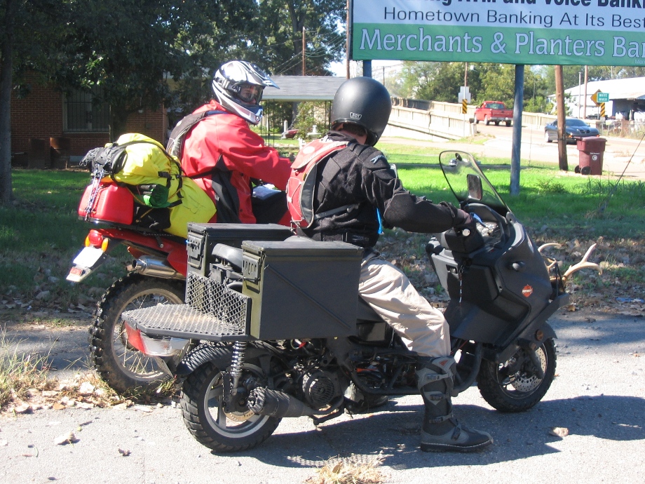

Postby DAVID THOMPSON » Mon Oct 23, 2006 8:53 pm
looks like me on a trip... BIG TIME OVERLOADED
the 125cc bikes get the job done but would have been fantastic as a 400
ar dave
Postby EvanMac » Tue Oct 24, 2006 9:06 am
That wasn't overloaded... most of the bulk there is a sleeping bag. All together I think all of the camping gear, food and tools etc. weighed about 60 lbs. Just looks like alot from the back.
I rode with three other bikes, a BMW 1200 GS, a Lifan 200, and a Lifan 150 battle scooter. At no point in the trail ride did I wish for anything more. I did want a little more power on the highway. But i was still cruising at 50-60 mph! All total I rode 1130+ miles of roads and trails over the 3 1/2 day period. No problems at all. As a matter of fact the bike broke in more during the trip and was even faster on the road home than on the way up. I even hit 70 mph at one point (flat road while drafting another bike).

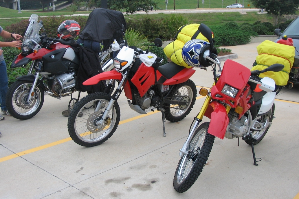

Postby EvanMac » Tue Oct 24, 2006 9:21 am
Here is another shot of the load...

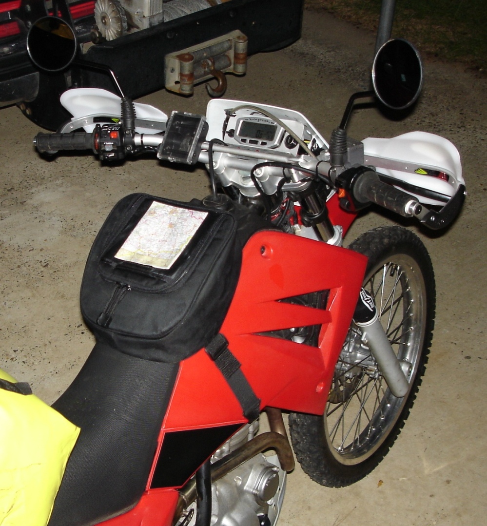

Postby DirtGrinder666 » Tue Oct 24, 2006 1:27 pm
:D I could see that ur bike got somekinda digital meter display (coz it looks a bit different from the stock!) can u post a pic of that thing and where to grab those kinda stuff ? :P

Postby EvanMac » Tue Oct 24, 2006 2:24 pm
It is a Trail Tech Vapor. Works great. Just order the universal model with the zip tie sensor for the larger fork diameter. It also senses water temp and you have to make sure you tell them to send the sensor for a water cooled engine. You will have to cut one of the cooling hoses to install it. It's pretty easy to do just make you plan on changing your coolant when you install it.
http://www.trailtech.net/vapor.htm
Order part number 75-701. And tell them you need the water temp sensor also. It costs another $20 or so...
I didn't like their customer service and it took them way to long to send my stuff... But I am very happy with the product itself.

Postby EvanMac » Wed Oct 25, 2006 1:27 pm
Exactly Dave... Here is a pic of the Vapor.

Postby DAVID THOMPSON » Wed Oct 25, 2006 4:17 pm
the handguards and front light ..what brand and where did you get them?

Postby EvanMac » Wed Oct 25, 2006 4:45 pm
Well, they are not cheap. I decided to go ahead and get the handguards I wanted because I can use them on my next bike... they are Cycra probends and they are about $100. I also got some Tusk aluminum handlebars on closeout for $15 (plus 5$ shipping) from Rocky Mountain. The stock steel handlebars will not fit with ANY handguard brands! I made my own mounting bracket for the Vapor and swithces...
The front light is a UFO with built in turn signals ($89). The rear light assembly with built in signals is also UFO ($75). I made my own wire harnesses etc.

Postby EvanMac » Wed Oct 25, 2006 5:01 pm
here is a pic of the front of the bike...

looks
Postby DAVID THOMPSON » Wed Oct 25, 2006 8:07 pm
the mz looks good the faring is a bit small but gets it done
now i see why i have not been lookin at bmw of late that bmw
pictured has a fairly new english word that was invented just for it
"FUGLY" http://www.urbandictionary.com/
and i am allowed to say that after owning several of them over the past
40 years
if i owned that thing it would not look like that for very long
ugh! :(
