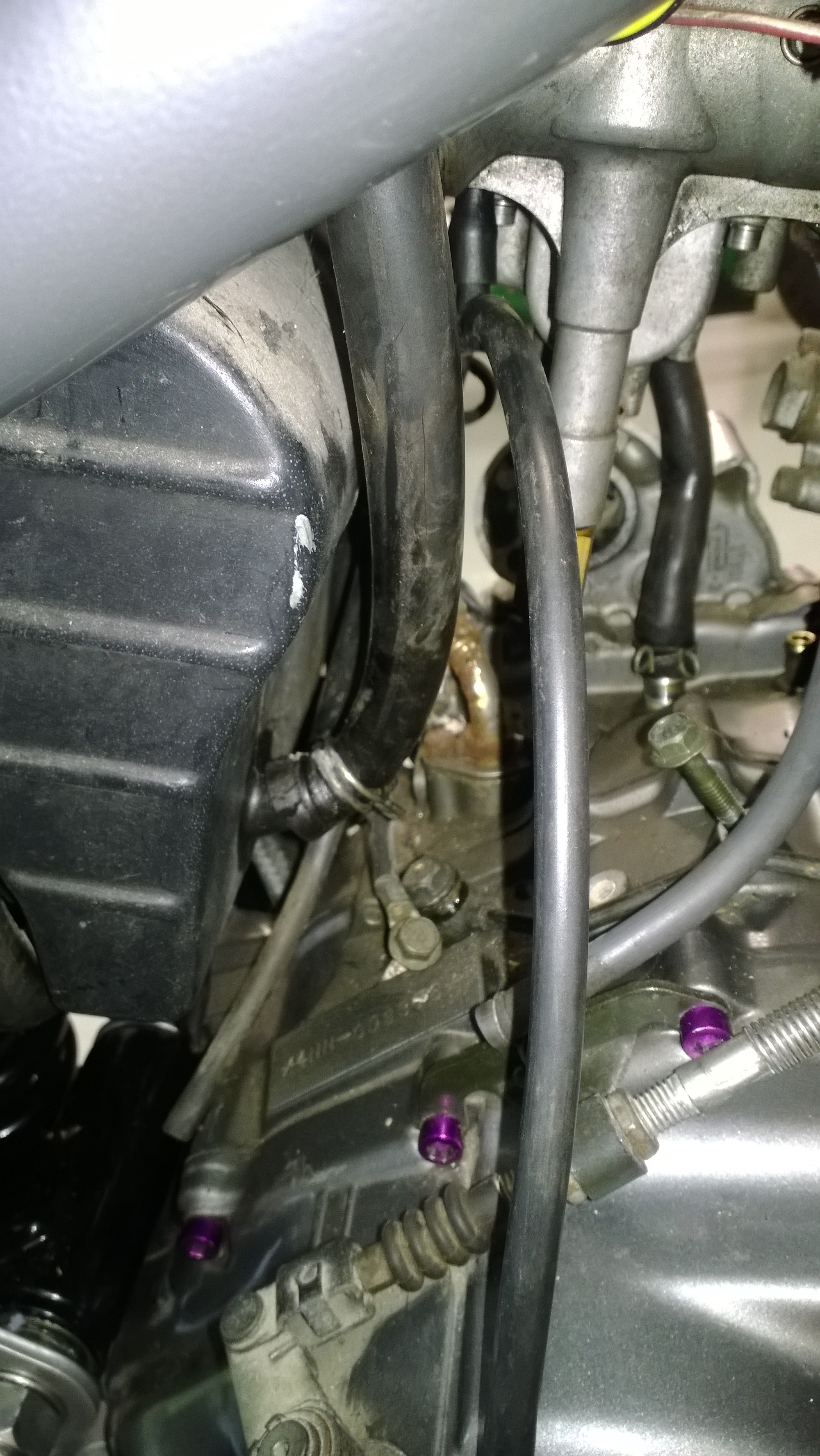

Postby KevinLS » Tue May 28, 2019 10:28 am
Hi, this is from memory and may not be reliable. I have two breather/drains coming from my carb set, both from the left hand carb and neither has a non-return valve and both vent just above the swinging arm in front of the air box. Do you have the fuel pump still connected? If so one tube provides vacuum for the pump, if not you will need to tie it off with a tie wrap to stop it leaking air. Sorry to sound so vague, I've attached three photos I took a while ago, but I don't know how helpful they will be. I plan to take the tank off my bike in the next week or so and will try to get you a better shot of the arrangement then.

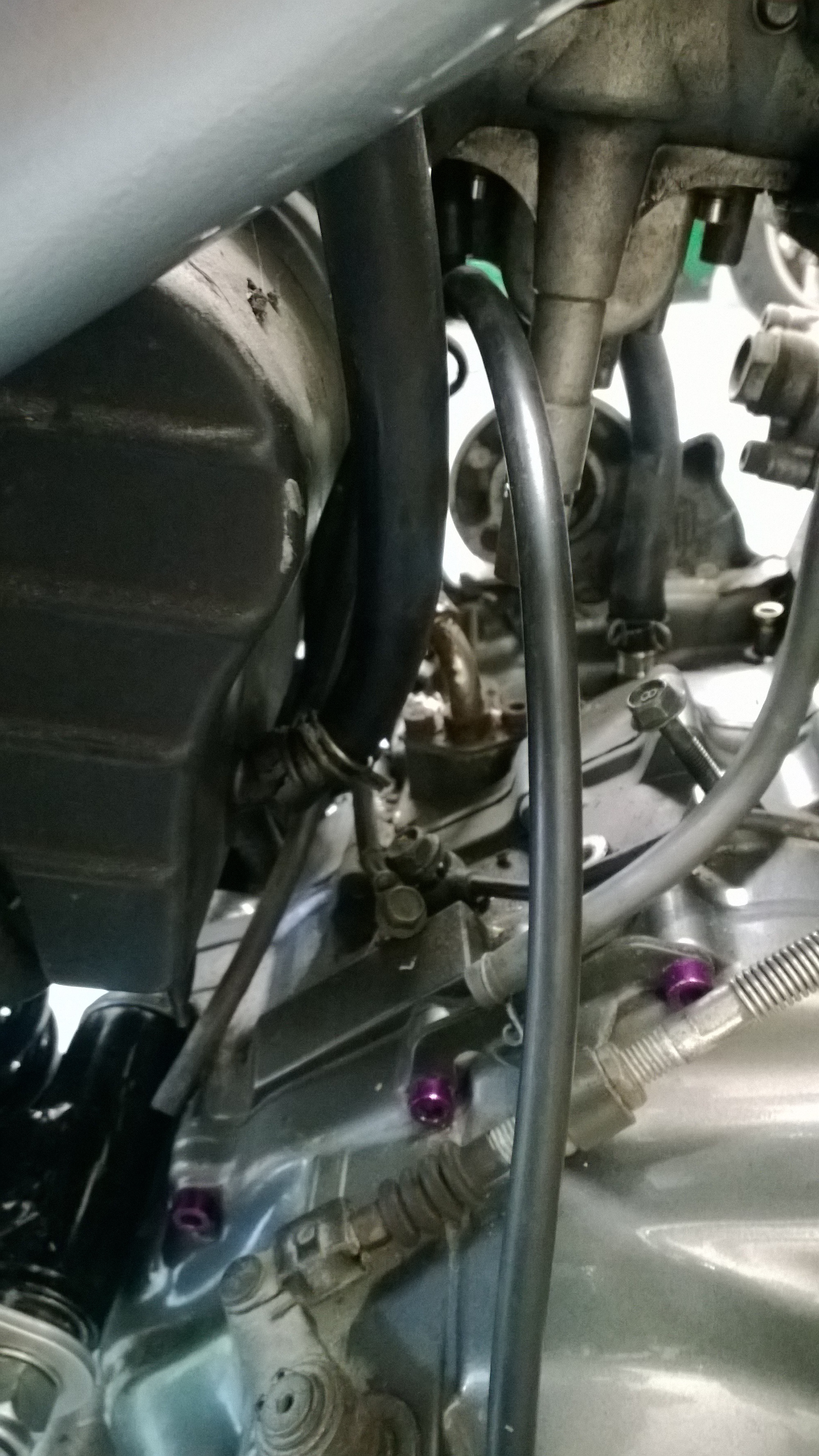

Postby KevinLS » Tue May 28, 2019 10:30 am
Further pic

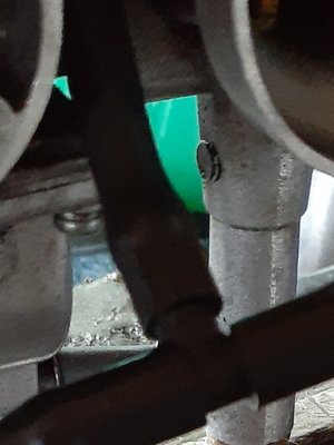

Postby KevinLS » Tue May 28, 2019 10:31 am
One more
